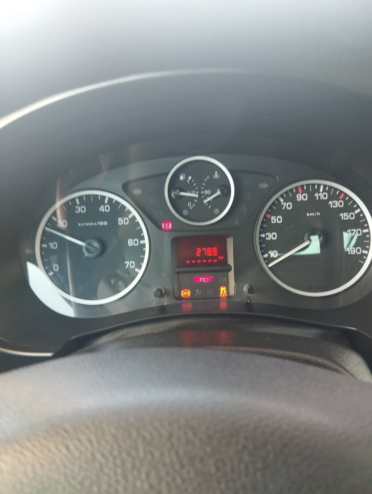

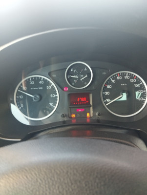

Hello, I have a problem with my car. About a month ago, the ABS, ESP, ASR lights came on along with a “braking system fault” message. The speedometer and mileage stopped working, and the steering became heavier.
When I got home, I checked all the fuses, the ABS module connector, and the rear ABS sensor connectors. Everything looked clean with no visible corrosion. After starting the car again, the errors disappeared, and I was able to drive for almost two weeks without any issues.
Then the problem came back. I connected a diagnostic tool and got the following error codes: 0150, C1408, U1113, U0122, P0500, U0121, 04C3, 05FF, 001C.
I decided to replace the rear ABS sensor since it looked suspicious. I also cleaned the ABS rings. After driving about 10 km, the errors didn’t disappear on their own. I came back, turned off the car, started it again — and the errors were gone. They didn’t appear for two days, but then came back again.
The errors always appear only when turning the ignition on and starting the car. If they don’t appear at startup, I can drive even 500 km without any issues. But if they do appear, I can also drive 500 km and they won’t go away while driving — they only sometimes disappear after turning the car off and starting it again.
All other electronics in the car work perfectly.
Any ideas what could be causing this?

Today, after the night, I got into the car and drove about 15 km without any errors. But for the first time while driving, warning lights came on, and the speedometer and odometer started acting weird – sometimes showing, sometimes not. I’ll share the YouTube link. I haven’t done the BSI reset yet. I’ll do the BSI reset in the evening.
