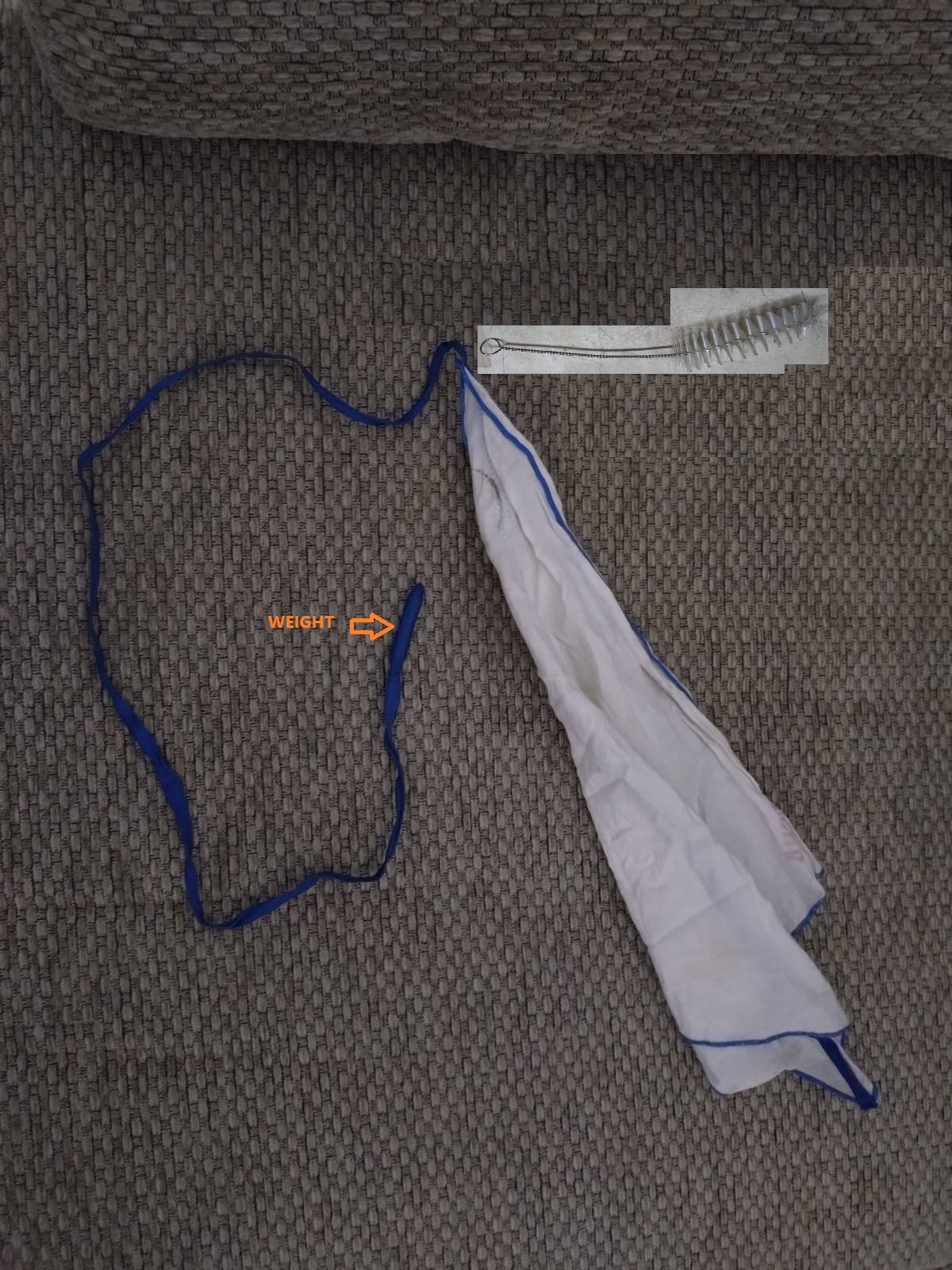

With the football not being too engrossing I managed to watch all that video, a trifle tedious I must admit!! :-D However I would make three points about improving his methods as follows:

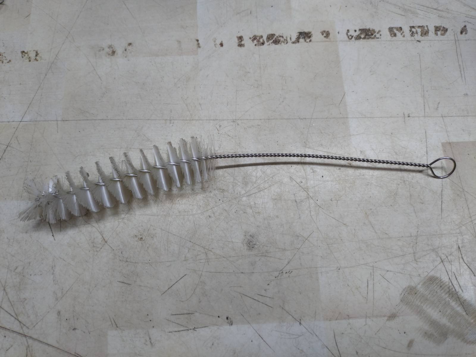

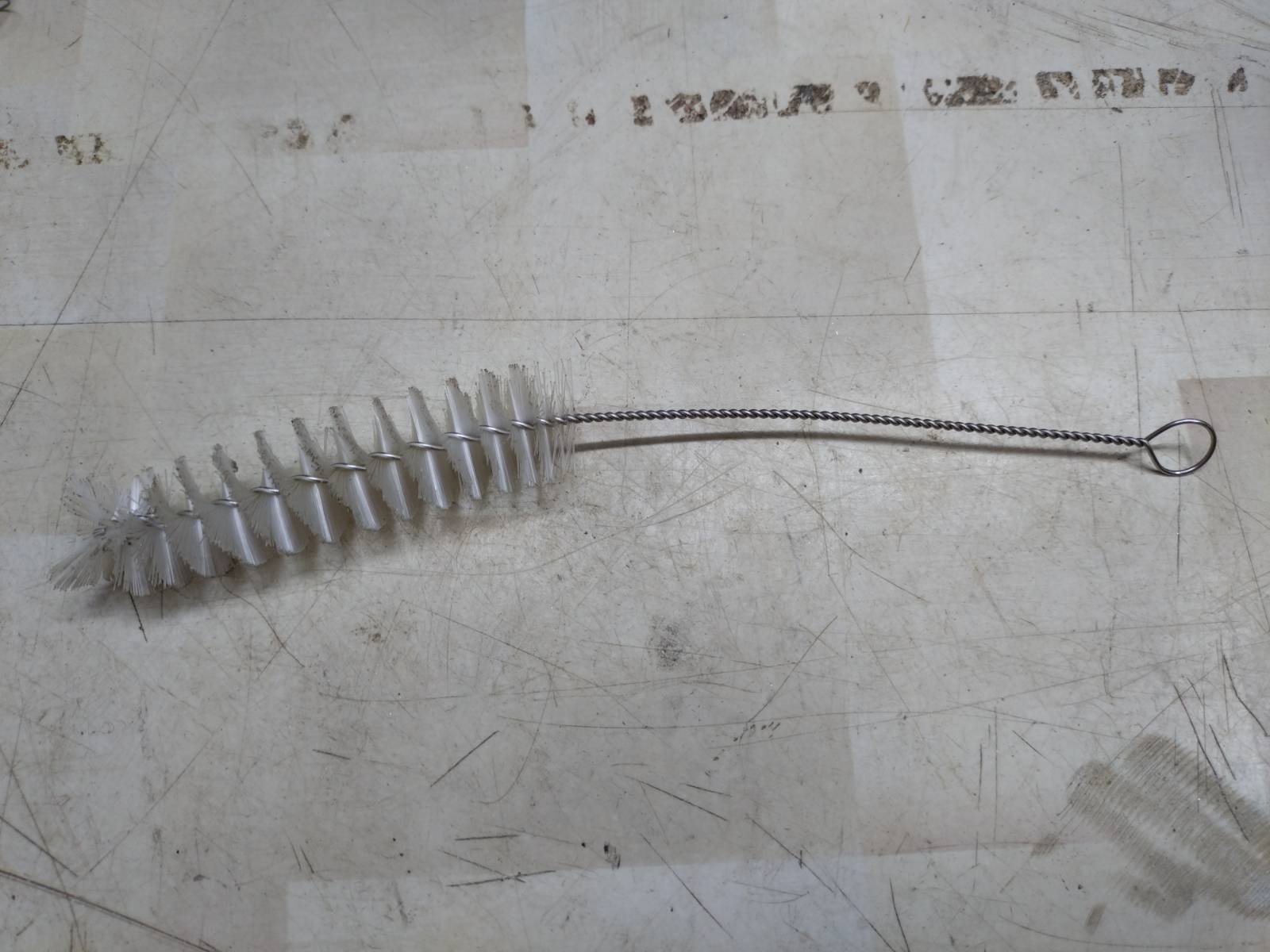

1. Don't push the cleaning brush through the pipes and risk spiking the inside. Instead take a tip from a woodwind instrument cleaner:
Clarinet cleaner
Clarinet cleaner
Take the cleaning brush:
Pipe cleaner
Pipe cleaner
and fit the brush instead of the cloth:
Modified cleaner
Modified cleaner
That allows you to drop the weight right through all of the pipes including the long bendy one and pull the brush through keeping its spike away from the rubber. I would tend to spray the brush with carb cleaner first!!
2. Instead of the oil drip bowl, use a baby bath which will accomodate the entire rocker cover. Then submerge the cover completely and shake in your choice of solvents, hot detergent, plastic safe degreaser etc. That avoids all the messing about with the pump. Rinse off the same way until there is just clean water in the bath.
3. Dry in a warm environment, with airflow through the cover.
Good luck with that! :)

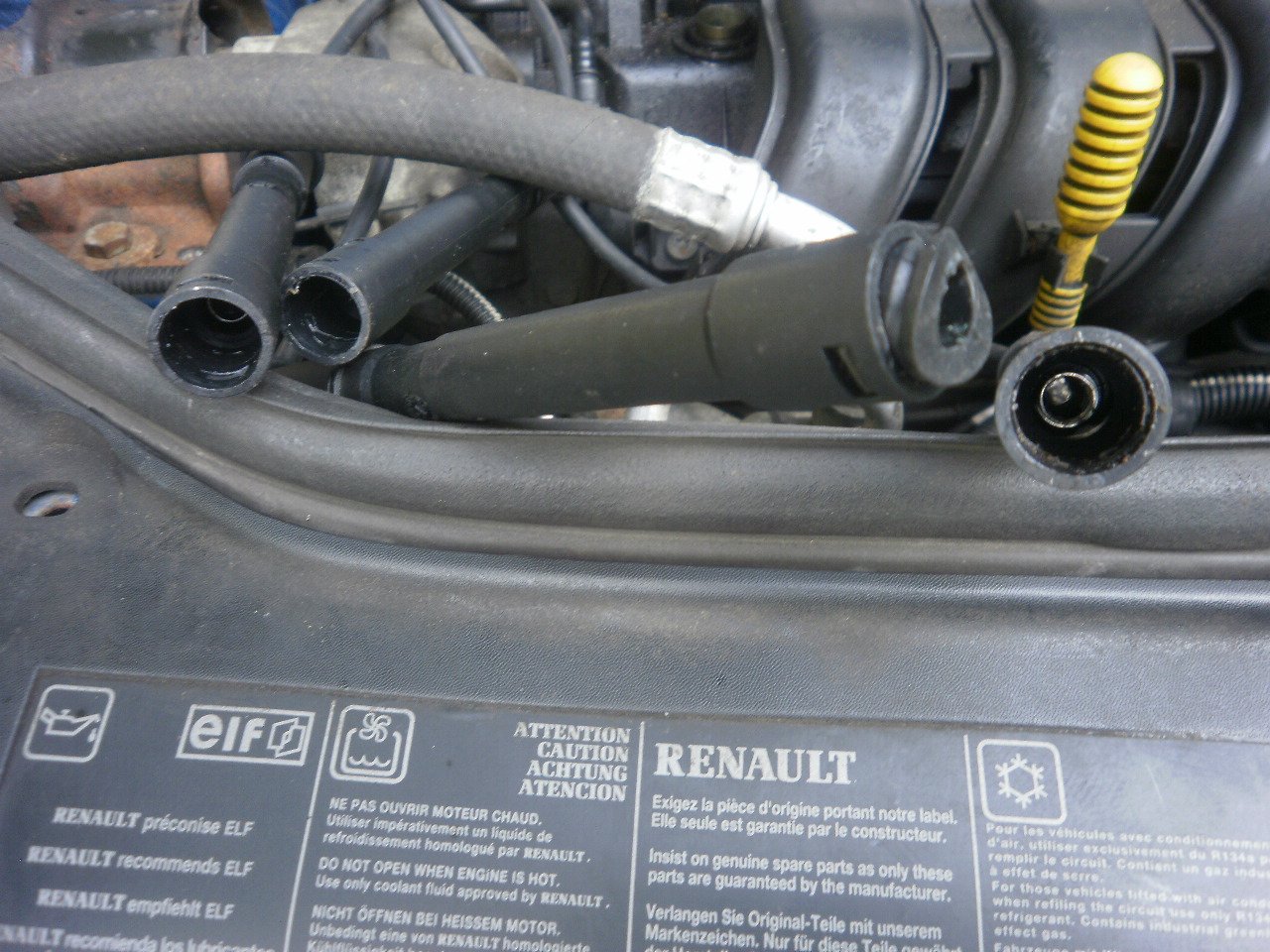

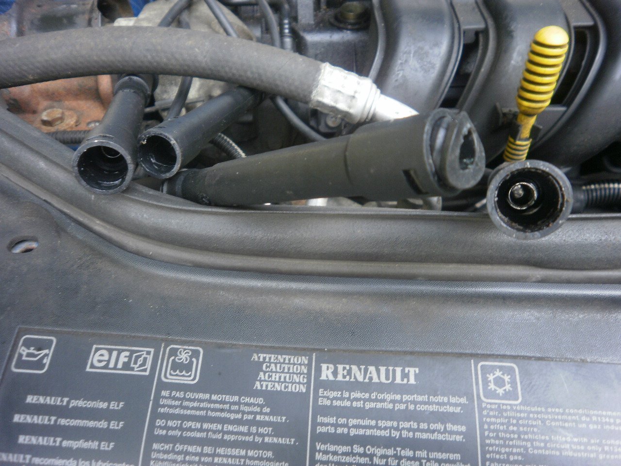

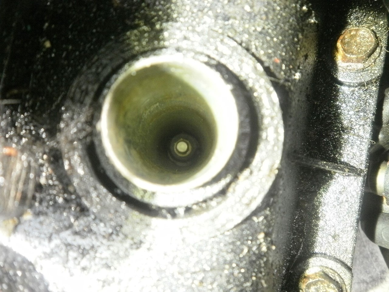

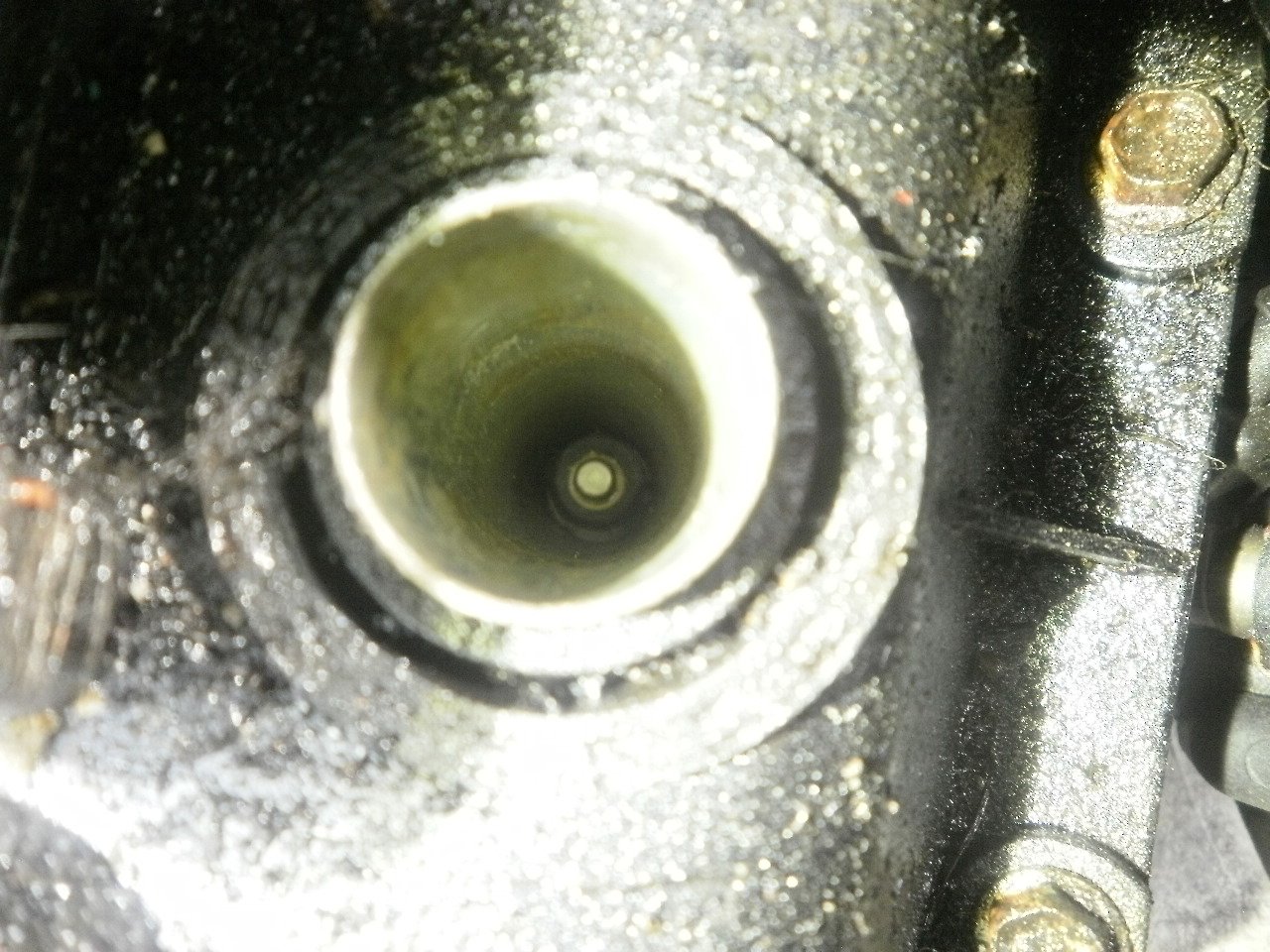

I know how to take spark plugs out, I have done it many times on many different cars.
Today however, this simplest of jobs...
Without warbling on...the rubber inserts at the end of the long plastic leads from the coil pack which connect to the spark plugs have remained in situ on the spark plugs 300mm down the spark plug holes on 3 of the leads. Yes and the rubber ends prevent access to the Hex of the spark plug so 3 out of 4 spark plugs are now irremovable.....
Keeping it visual...
The 4 Leads...only one with its rubber insert
Down in the depths of the spark plug hole sits an NGK spark plug with an unwanted tight fitting jacket in finest rubber

mickthemaverick wrote: 20 Mar 2026, 13:09 You've found that so no need for me to tell my tale about doing the same, however once out I glued my rubber seals into the tubes and they didn't play up again!! :-D

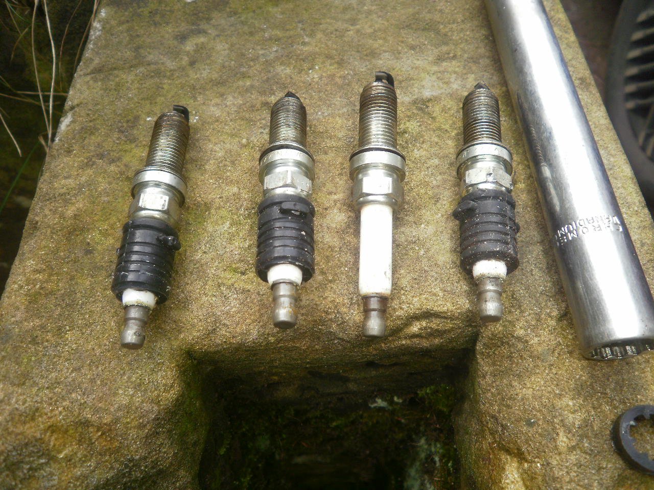

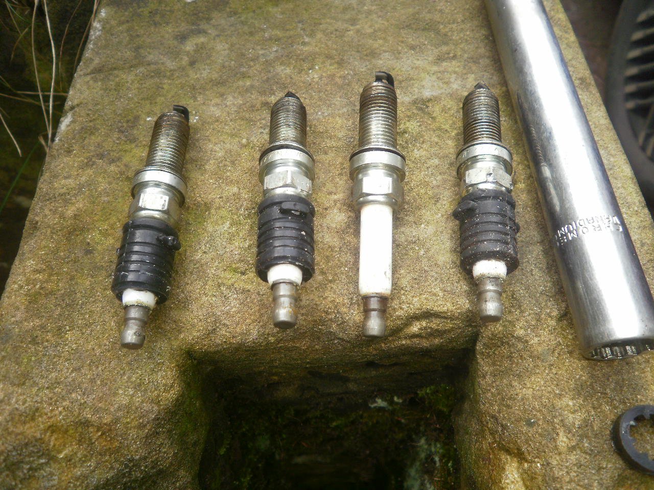

It has actually turned out to be simpler than I thought.
Just removed the normal rubber insert from the spark plug socket and used a T-bar to exert strong downward pressure and the socket went over the rubber inserts from the leads that were "stuck" and reached the hex for normal undoing.
Here they are and not unexpectedly a nice black sooty residue on them all! Its running too rich!
