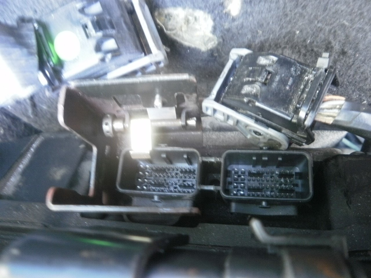

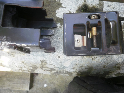

Patience worked without destruction...the metal security cage to the ECU is off. Many turns of the brass wheel using the hand forged precision screwdriver eventually took the cage into a position where it could be removed.
Intervention 2 Complete.
Intervention 3 bit of wire unwrapping and examination to see if any have compromised insulation due to the jiggling about of that cage!

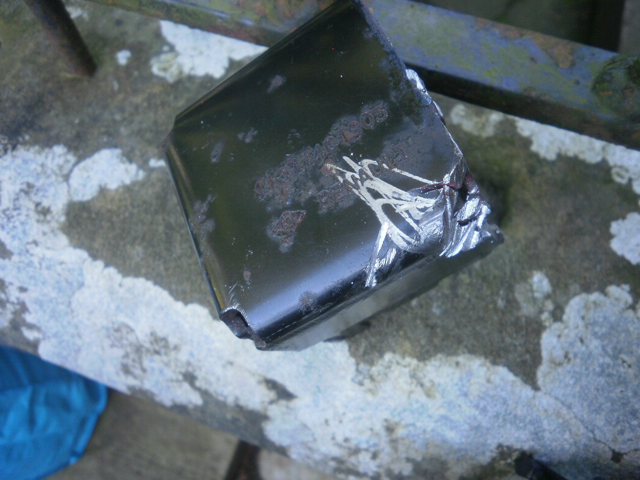

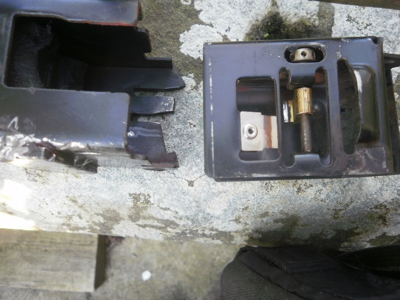

Small wins today. requiring to solve the puzzle of the metal cage. Not obvious how it comes off even when you watch the Vid. The little brass wheel takes ages to rewind to the point where the top can come off...one hole at a time moving it less than 1/8th of a turn.,
Even when its in position and one half (The top) can be removed it leaves the lower bit in situ. The only way to get the lower half off would be to remove the ECU....4 T30 Torx head bolts, right up against the bulkhead....no way of getting any socket in place to remove all 4 bolts. Only chance would have been a T30 Torx "key" in an "L" shape. Resorted to a bit of creative metal bending to release the bottom part,
Small win Neil

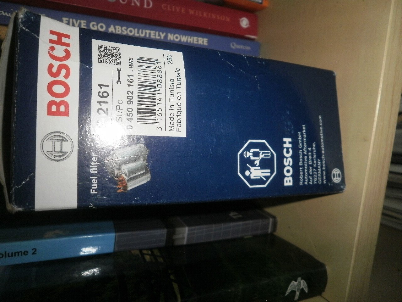

Intervention no 3 most likely to be a new fuel filter!

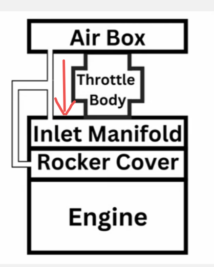

With its sooty exhaust pipe, and niff of Petrol the BBClio is running too rich. But which screw do you turn to adjust the mixture?
This Internet wisdom seems logical enough:
To correct a modern fuel-injected car that is running too rich, you should first check and possibly replace faulty components like the oxygen sensor or mass airflow sensor, as these can affect the air-fuel mixture. Additionally, ensure that fuel injectors are functioning properly and not leaking, and consider having a mechanic diagnose the issue for a more accurate fix.
Well I don't think the injectors are leaking a stream of petrol down the engine block, but could well be leaking into the inlet manifold. Haven't got round to removing the inlet manifold and discovering what is to be found on its removal as it is necessary for it to be off to get a good look at the fuel rail and injectors. It does conceal the throttle body too as well as some sort of PCV "pathway" which may need a bit of clearing out.
I'll probably watch all of this can't imagine anyone else will!...just for completeness dumping it here..

Hmm, interesting. I guess there is, as a minimum, a significant restriction in that tee-piece (as otherwise you'd have an unregulated flow between air box and inlet manifold (i.e. bypassing throttle body)
I'm surprised you've not not the MAP sensor in place
(it gets my vote for being the issue, at present!)
