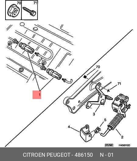

Just to ask.....is the rear brake compensator/Pressure Regulator seized/rusted up ??

I think only cars with ABS had those didn't they? Not 100% sure. No ABS on mine.

My Haynes manual indicates that on non ABS models the pressure regulating valves are integral with the rear cylinders and the cylinders must not be dismantled. If a fault is suspected then the complete cylinders must be renewed. That means I can't measure them, or if I do I would have to replace them :x

Which would mean that if the rear cylinders I have had fitted where meant for ABS models there would be no pressure regulation to the rear. That would explain it if that is what has happened.

I am not 100% sure which rear wheel cylinders have been fitted but research has shown that non-abs cylinders have internal valving for brake proportioning while rear cylinders for abs models have no valving as a compensator is fitted to the rear axle. So if abs cylinders have been fitted there would be no proportioning to the rear at all. I may order some non-abs cylinders and get them fitted.
