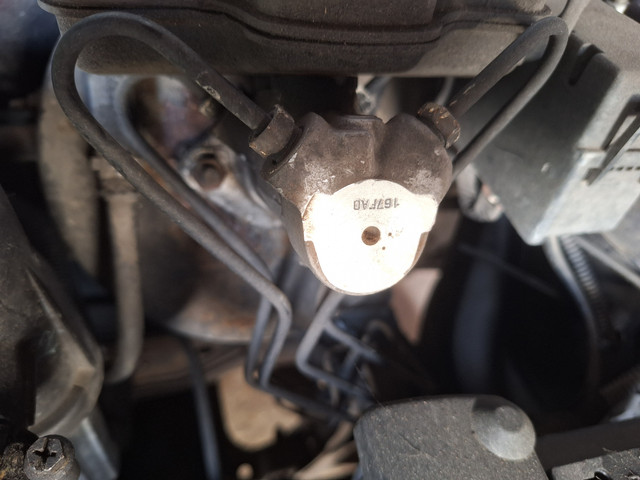

So I have decided to renew some of the braking components on my 106 Independence.
I have worked out that the calipers are Ate so I can get some new pads, and I will be replacing the discs as well.
The only problem is with identifying the brake master cylinder. It has the number 167FA0 stamped on the end but I can't find any references to this anywhere.
If I put all of the car info into the AutoDoc website it lists several different options.
https://www.autodoc.co.uk/car-parts/bra ... 5D%5B%5D=4
I don't have ABS and it has 4 connections so that narrows it down but there are two different bore sizes. 19mm and 20.6mm. Not a huge difference but they all fall into one size or the other making me think that it needs to be specifically the right size. I have tried various sites trying to find part numbers but with no luck. Could anyone point me in the right direction?

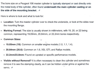

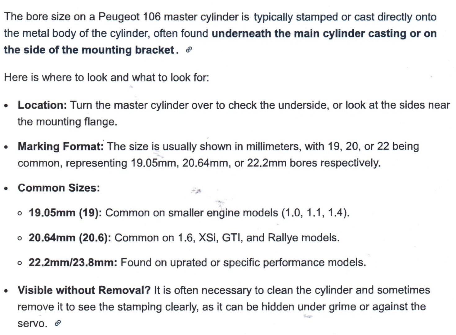

Re: Peugeot 106 Master Cylinder
Pete,
If you look closely, the bore size is cast into the master cylinder housing.

I expanded the AutoDoc OEM numbers and for the 106 all the options appear to be 4601**
I have had a closer look at the master cylinder and besides the number stamped in the end I have found "00 2 17" underneath which may well be a date code given the car was first registered August 2000 along with "3.6" on the cylinder body. And the Ate logo.

Oldpug
- Posts: 561
- Joined: 07 Aug 2010, 11:15
- x 94
I think its safe to say its a 19.05mm (19) Master Cylinder.

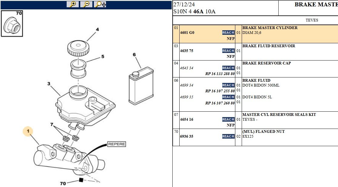

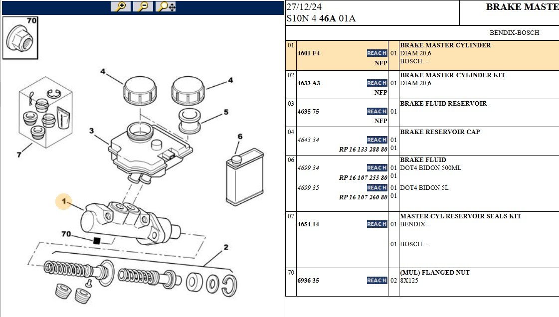

There are 2 listed Depending on if it's Teves or Bendix-Bosch.
Both appear to be the same diameter

Thanks Wheeler for looking up the parts diagrams, but unfortunately I have the Ate system.
