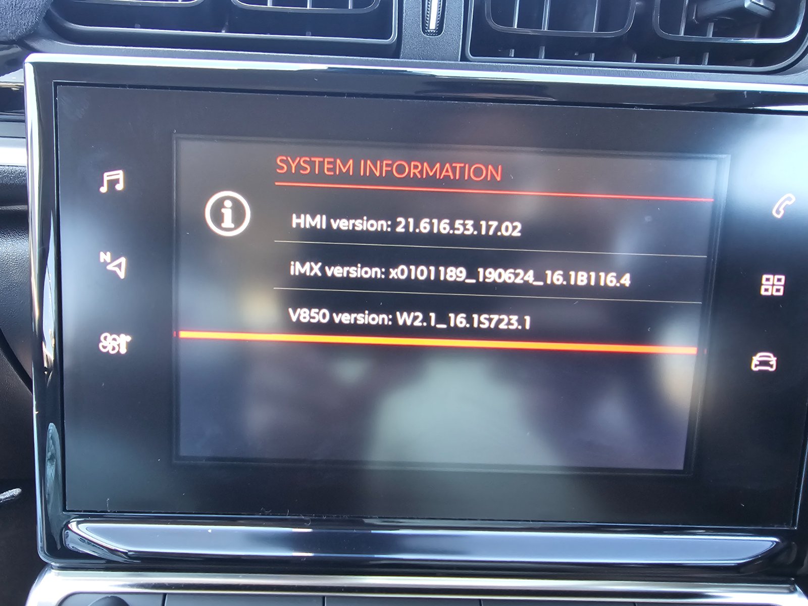

Currently living in New Zealand. Just bought 2018 citroen c3 japan imported. Today updated the unit through the citroen windows app. But I still couldn't get the android auto working.
My VIN is VF7**************[VIN obfuscated, can be read by forum staff]
Can someone help me?

@Keepchill: That's the latest firmware version for the RCC Wave 2 (RCC_EU_W2) system - see the tooltip to compare the HMI/iMX/V850 versions. In the previous screen you should see a "System version: 076x", and that "x" could be a letter "A" to "D". The "A" and "B" hardware variants doesn't have the MirrorLink, Apple CarPlay or Google Android Auto support - see viewtopic.php?p=861471#p861471
If you have a "C" or "D" hardware variant and the CarPlay/Android Auto icons are greyed out or not present, it needs telecoding to enable them. With that RCC systems, it is always required to use a good quality USB cable (or a wireless dongle/adapter).
CarPlay/Android Auto can only be shown on the touchscreen and has a fixed 800x363 resolution (see https://developer.groupe-psa.io/webport ... creen-size ), so the top and lower bars are always present. It might be possible to enable more themes/colours, but it requires telecoding (through the OBD port).
