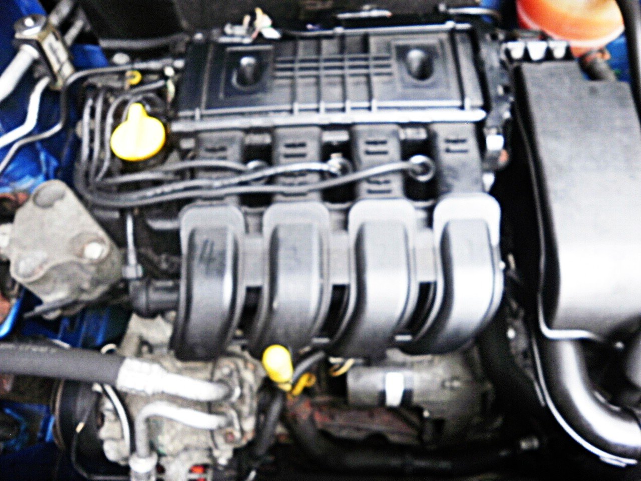

Very grateful for your input Matt. The Inlet Manifold is a bit of a cumbersome beast in the finest plastic, sitting on top of the engine snaking over from back to front with its four "arms" before the fuel rail and 4 injectors mount into it at the front. Plenty of scope for a bit of leakage at its gaskets.MattBLancs wrote: 06 Mar 2026, 07:10 Hi Neil! Sorry to be clear, I thought your description was good, nice and clear how it's (mis)behaving.

Crikey, that photo is verging on an AI nonsense nightmare creation.

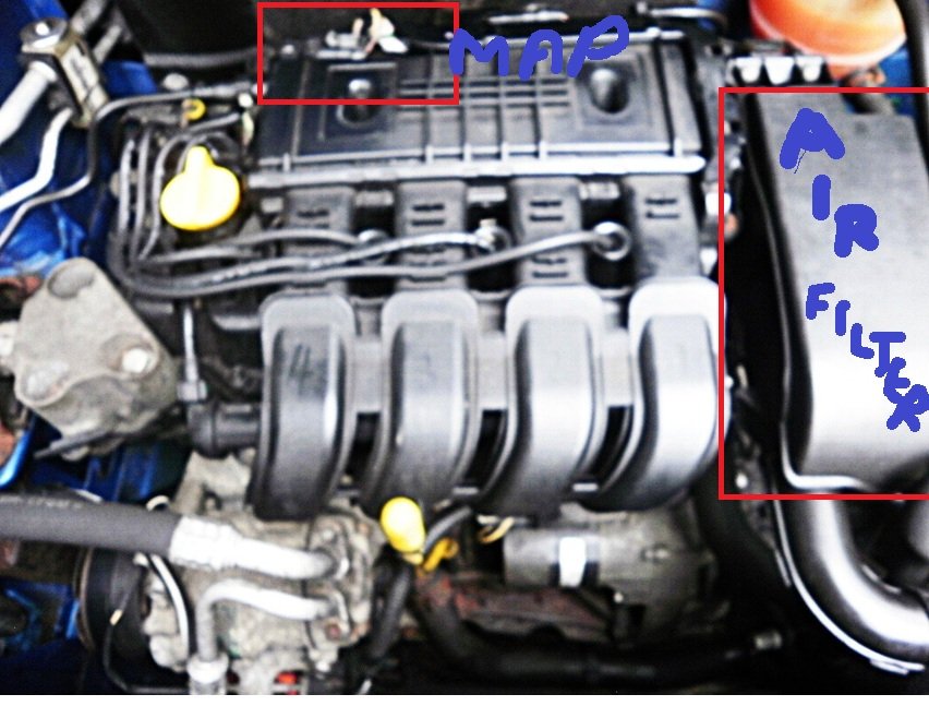

Air filter and MAP sensor as indicated in this photo.MattBLancs wrote: 06 Mar 2026, 16:37 Oh wow, wasn't expecting that! How odd!
Is the air filter under that big assembly (inlet manifold off for a filter change!? Surely not) or is that throttle body pulling from a large plenum and the air filter is elsewhere?
In any case, agree there looks to be lots of potential leak paths there![]()
Another odd Renault thing the Renault 1.2 16V D4f engine doesn't have a PCV valve as such. The oil breather is actually part of the rocker cover,
and discharges into the air filter housing according to the Renault Forums https://www.renaultforums.co.uk/threads ... se.114424/
