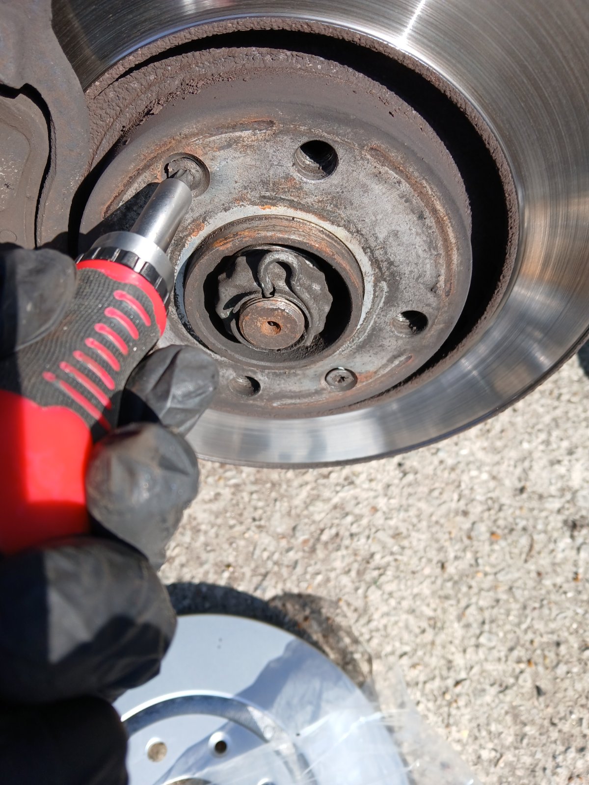

Front disc lock screw purchased 8 for 5 pounds and a few pence once these arrive the front brakes will all be replaced discs and pads. Hope this sunny spell will last .

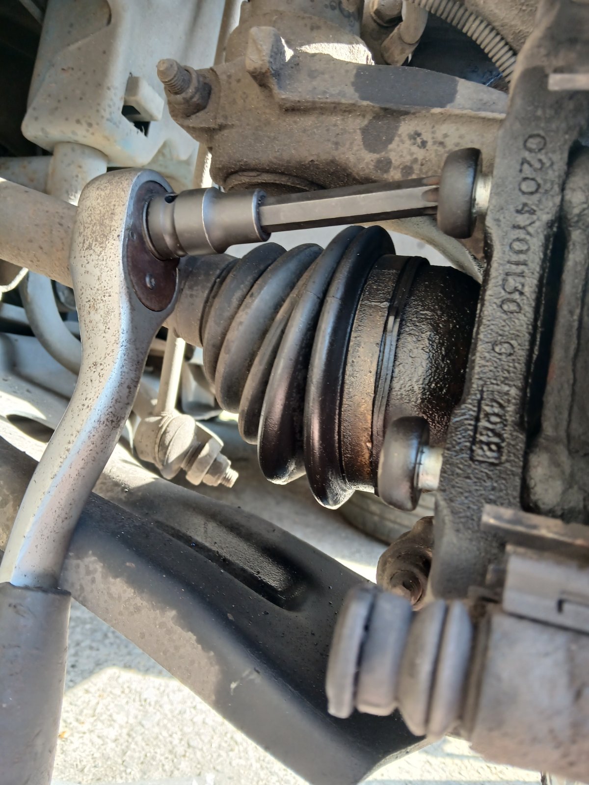

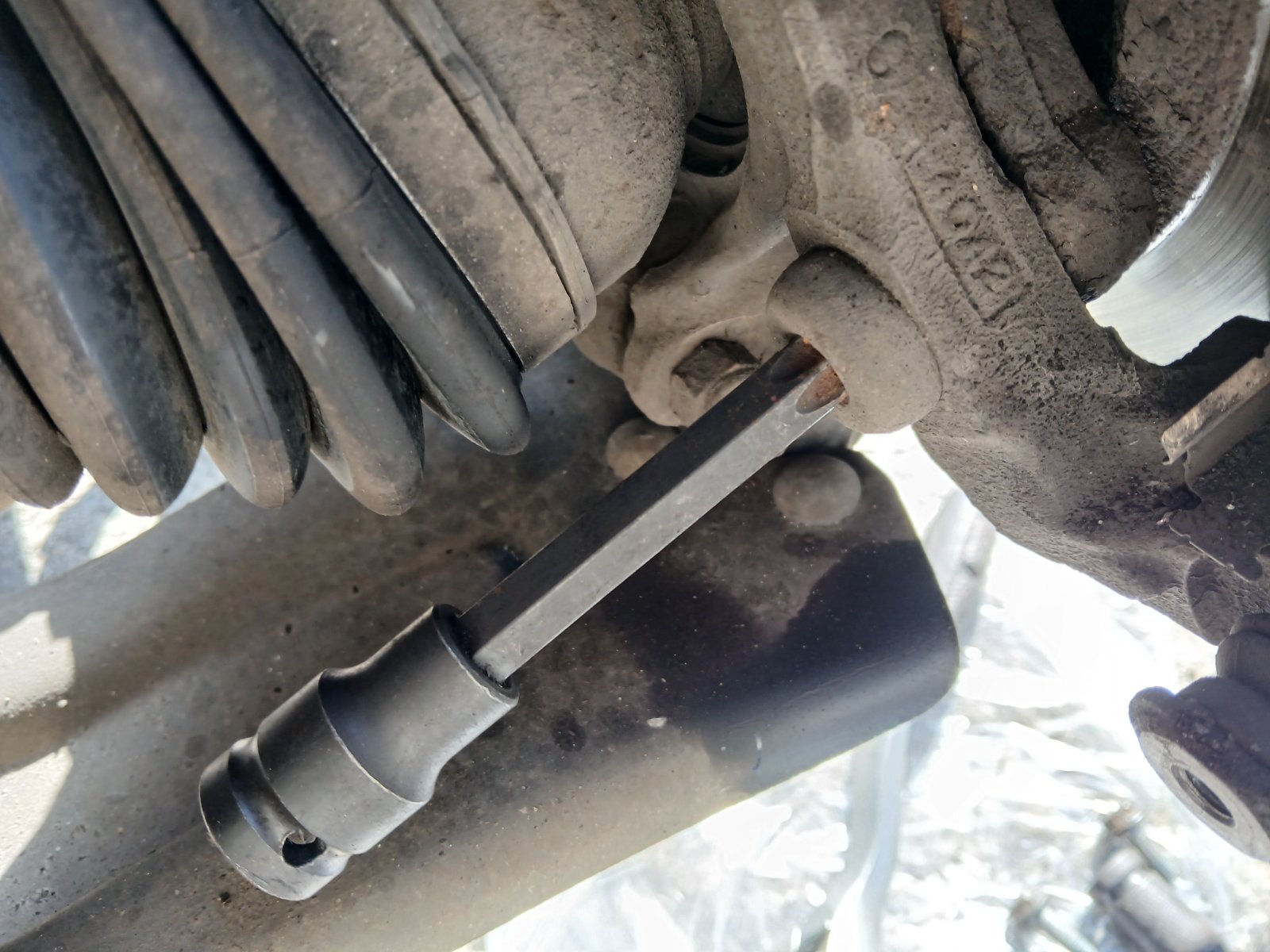

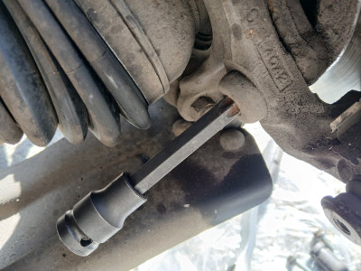

Thanks Jim , that advice about the electric screwdriver payed off big time , not only did it do the stuff for thd 207, I remembered a pair of hub carriers I got for the 308cc which needed the lower balljoints removed , no problem out they came 5 seconds flat lol 😀 brilliant piece of kit and an aging aching body saver lol

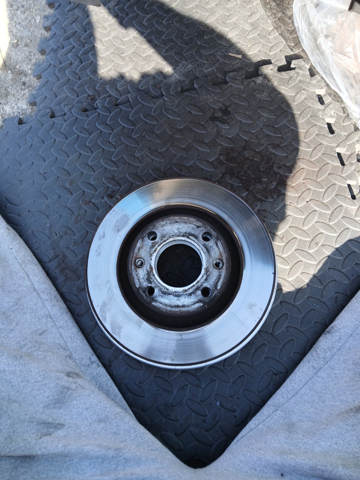

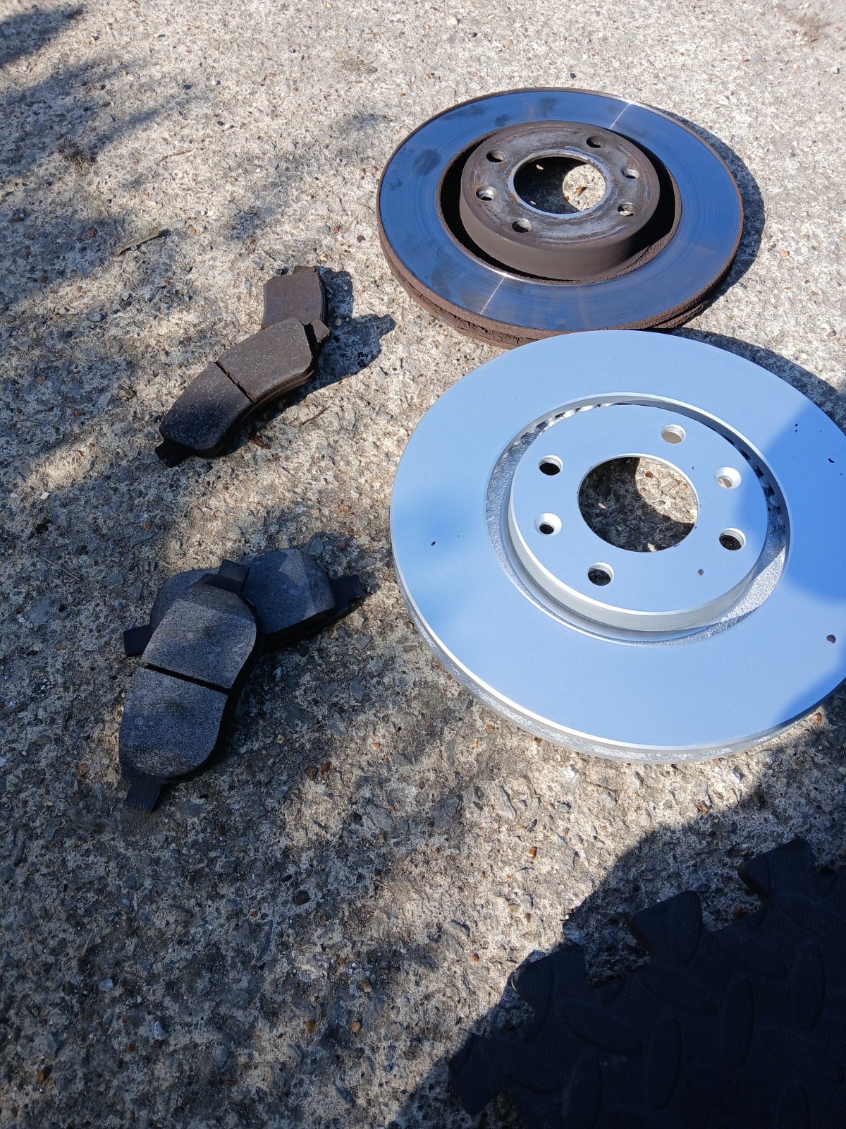

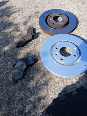

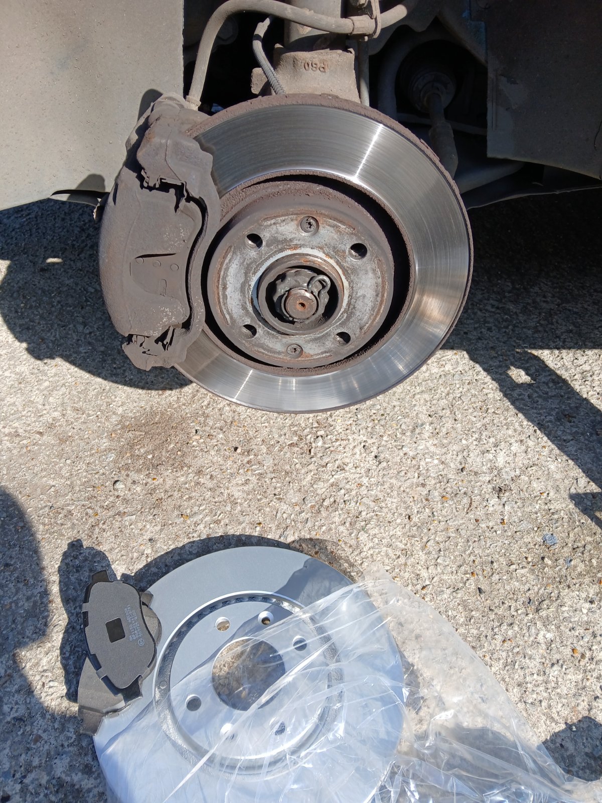

Finally had good weather so decided to replace the front discs and pads everything was going really well till I opened up the box of new parts then compared them to the original ones and they were to big. I spoke to the gemini assistant on my phone while in the car and it found everything needed and even checked the numbers of the new ones and it said that they were for a different variant of a 207 as mine were the same as the 1.4hdi it even found the sites to purchase them and rechecked with cross reference of parts numbers , my next door neighbour couldn't believe the my car had spoke and sorted out all the parts needed as he could hear the voice coming from the car as I was outside of it 😆 time it took this new tech to source the parts 2 minutes...

I was surprised I even checked the numbers it gave myself and it was all correct, nothing more annoying than getting everything out the way then finding out after you undo the box nothing fits size wise, however the new parts are down for 10th March so that's not to bad, plus the fact who ever fitted the set that's going to be replaced used copper Grease where it was needed which has helped a lot .

As regards the punctured vacuum pipe it's great that ai confirmed what you thought it was yourself , it's like a second confirmation but just from an ai tool which I guess how it's going today and onwards is going to more than likely common place. What made me laugh was I swore as I offered the new part against old and saw the size difference, even though the seller said they would fit my car. And with me swearing I was told off by gemini, I then said what are you my mum , it then came back with it's not possible as im not a physical being

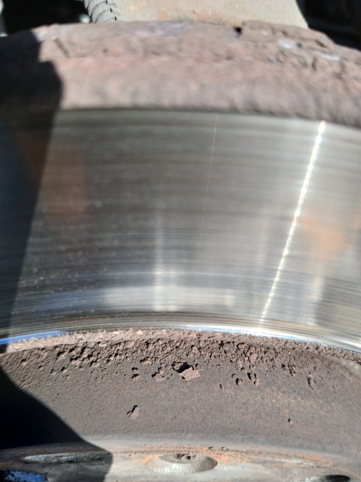

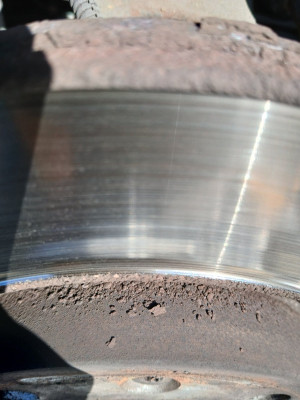

Look at that lip in them photos of the disc roll on new ones

The new parts arrived , ai was correct.
