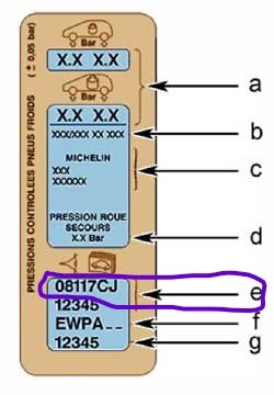

What is the RP number from your tyre pressure label sticker? e in the picture.Matthewg_334 wrote: 01 Mar 2026, 14:20 Hi I'm looking to find out what eolys fluid I need
I believe this number has something to do with the type I need 10658 I've tried to research as much as possible but no luck.. I really hope can help

Are you suggesting Eolys fluid can be found out by checking the door sticker!? If so I'm in luck!

wheeler
- Posts: 7926
- Joined: 21 Sep 2002, 19:07
- x 1056
Re: What kind of eolys?
Not directly, its to do with build date. The RP number gives the exact build date of the car.
