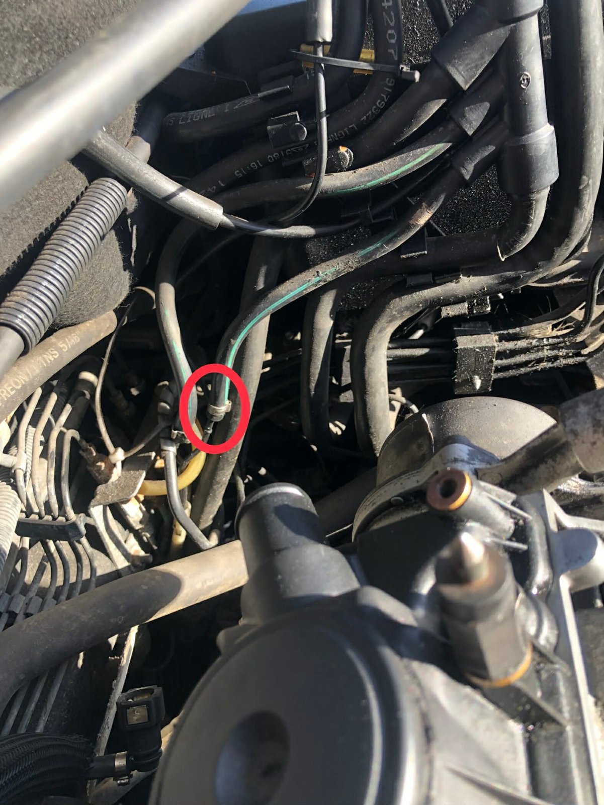

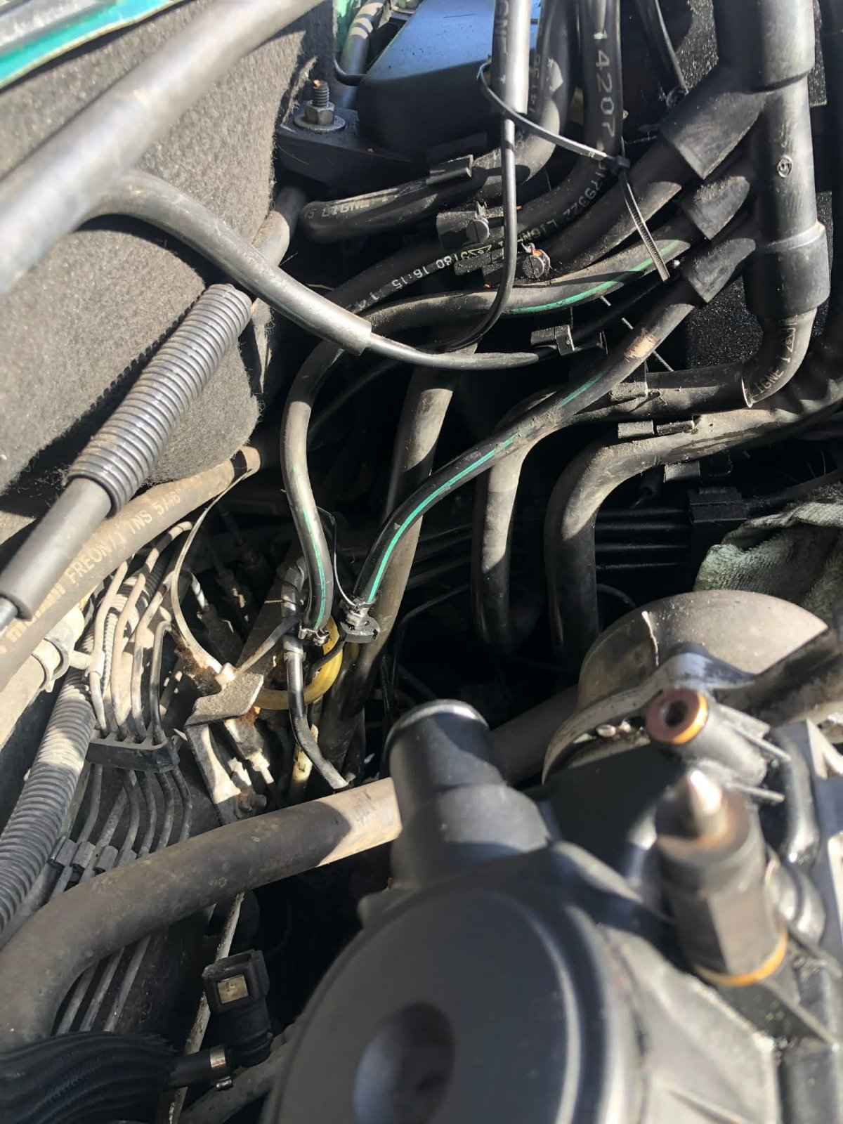

An old repair on a LHM return pipe was also re-done as it was clearly holding on to not a lot of pipe...
Skull's - Dodgy LHM+ return
Repaired again (third time) but it's getting a bit too short now ... each time you trim a bit of frayed pipe you have to drill the end to widen the internal diameter to match the pipe or it wont go on.
I could really do with some extra length :oops: ..... or a new octopuss but it seems more secure now

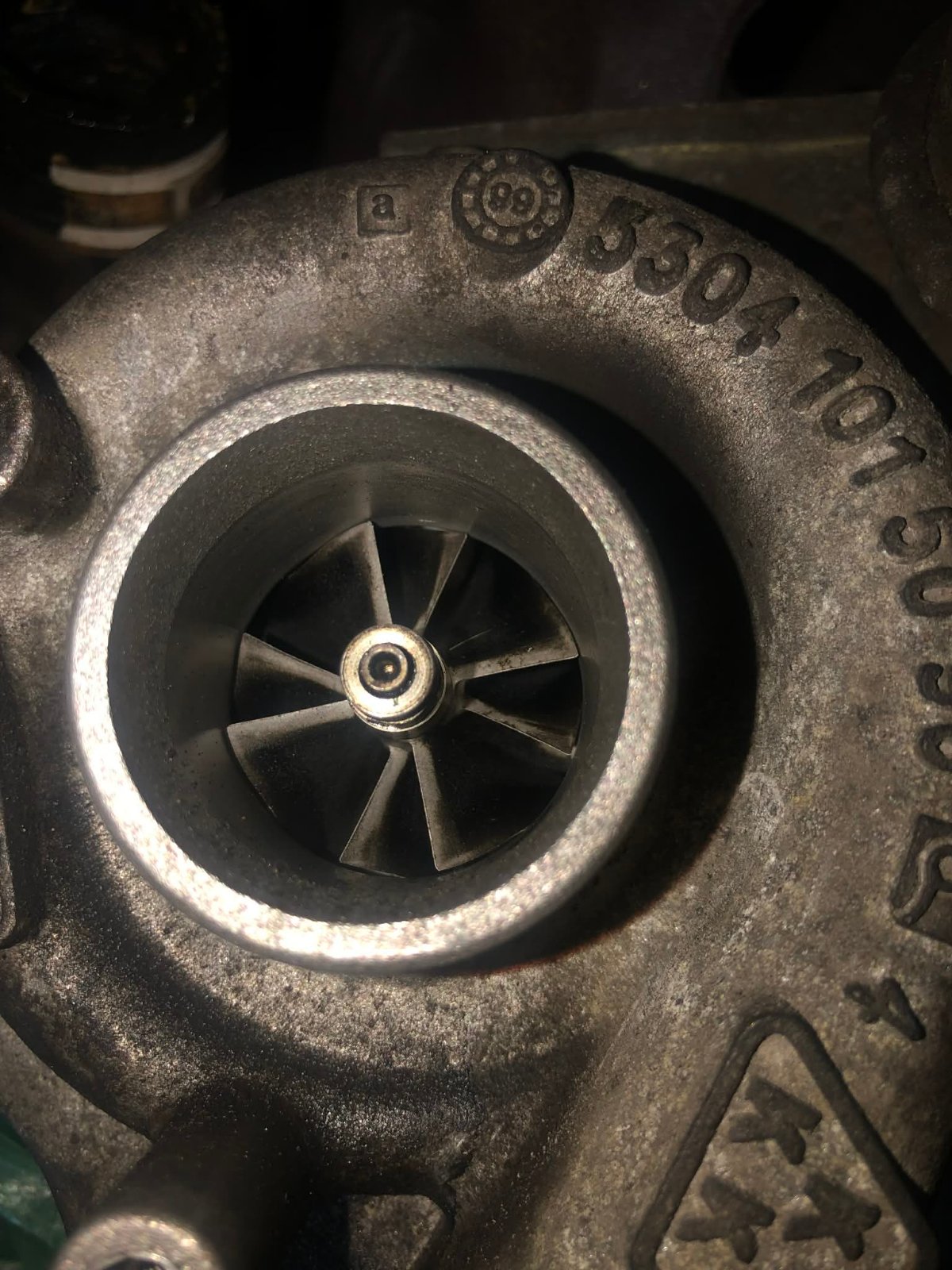

Whilst shoving the turbo around yesterday I got a look at the tiny impellor .... looks and feels in good condition ....but much smaller than I was expecting ...
Brilliant! Keep going. Inspirational. I know it is no fun taking the inlet manifold off which is why I have had a gasket sitting in the boot for years waiting for me to take it off and clean it.
As far EGR to intake manifold gasket, that's a good question. I read it wrong initially and was going to say it's a metallised gasket but that is to the exhaust manifold. There are a couple of EGR configurations on the HDi DW10. I think mine is a push it almost with a concertina pipe?
Tiny turbos are gooooood! They spin in fast at low revs and don't lag. If you're up for a laugh add a large one too for the best of both worlds. The turbo on my Saab T16S is huge. 3-4" manifold from memory which is why it doesn't kick in until 3000 rpm but when it does, you don't want to be on the autobahn at 85mph in damp conditions as the wheels will spin...

That's a nice clean turbo no signs of impeller wobble either

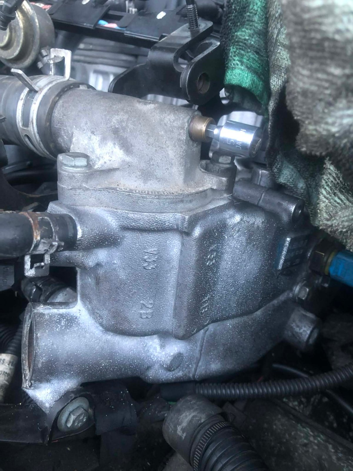

This was over 3 days (about 15 hours fathing around tightening and undoing several times trying to get all the studs in correctly) eventually removing the offside engine mount to allow the last stud No.3 upper in the above video to be fitted, followed by the Coolant Outlet being fitted - photo shows bleed vent on top of thermostat housing (5mm Allen Key)
Skull's - Coolant Outlet re-fitted

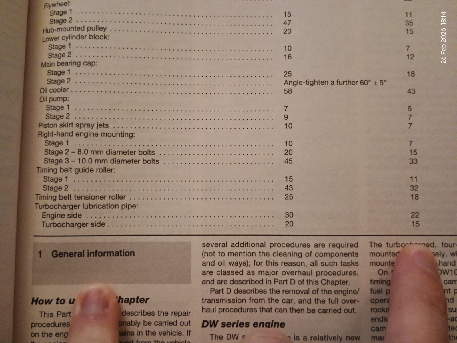

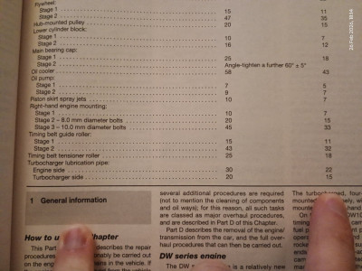

Also I can't find a torque setting for the Turbo oil supply banjo type fitting ....
Hang on will have a quick dig
Posts: 5308
Joined: 25 Apr 2022, 09:03
x 2341
Re: XANTIA HDi RUNNING ROUGH
Unread post by MattBLancs »
Found it, Peugeot 406 Haynes manual (#3982) Diesel engine in car repair procedures.
From Haynes
From Haynes
Turbocharger lubrication pipe
Engine side 30 Nm, 22 lbf.ft
Turbocharger side 20 Nm, 15 lbf.ft
