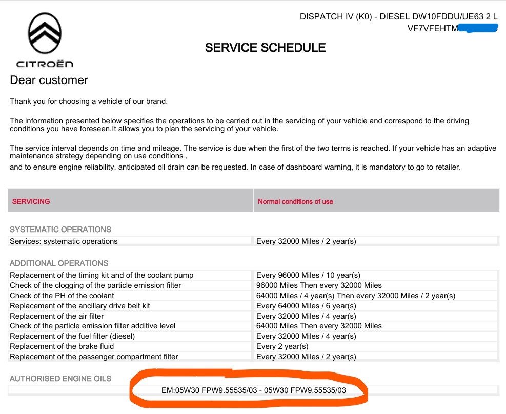

This is the oil spec for your van

And to confirm that oil of 5W/30 to FPW9.55535/03 specification is correct.

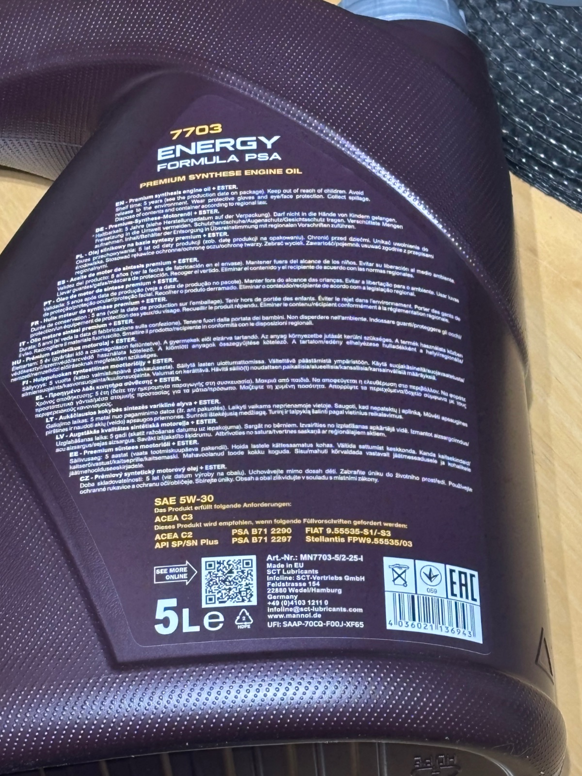

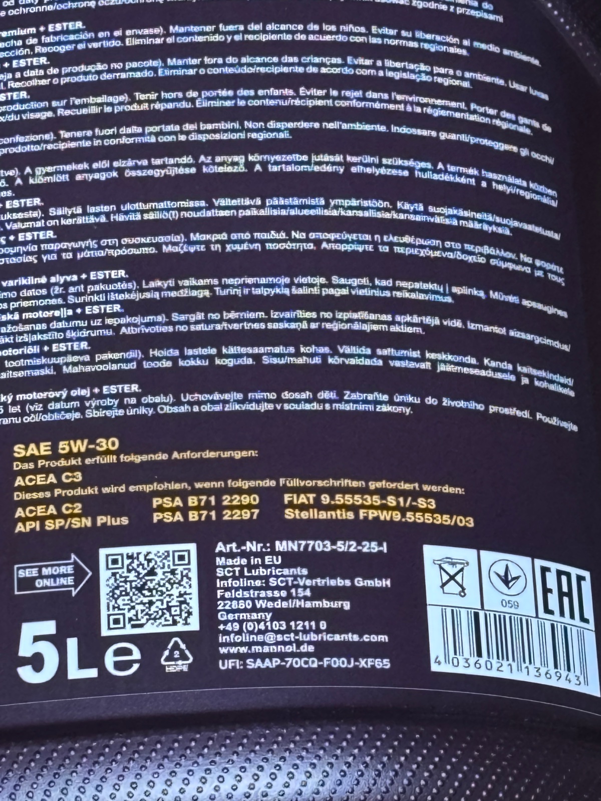

Re: Engine oil relay 2.0 bluehdi DW10FU
Hi
According to TDS info from the Mannol site the 7703 Energy Formula isn't FPW9.55535/03 specification, I have looked at it before.
Please correct me if this is not the case.
This is from the Mannol 7703 TDS:
Specifications
SAE 5W-30
ACEA C3
Recommendation
API SN Plus
API SP
ACEA C2
PSA B71 2290
PSA B71 2297
FIAT 9.55535-S1
FIAT 9.55535-S3
Regards
Specifications
SAE 5W-30
ACEA C3
Recommendation
API SN Plus
API SP
ACEA C2
PSA B71 2290
PSA B71 2297
FIAT 9.55535-S1
FIAT 9.55535-S3
Regards

Link to the Mannol PDF for the 7703 oil https://www.mannol.de/create-pdf/317/en
I think an email to Mannol technical department is needed. Maybe FIAT 9.55535-S1 or FIAT 9.55535-S3 is equivalent (Fiat is owned by Stellantis) to FPW9.55535/03? Although I suspect they're equivalent to B71 2290 and PSA B71 2297.
- Posts: 9397
- x 1940
Hmm, further investigation of the Mannol web site seems to indicate that 05000ST Motor Oil 5W-30 Premium Synthetic ST is now the correct oil for FPW9.55535/03 use.
https://www.mpmoil.uk/blog/change-in-re ... s-vehicles and https://cdn.mpmoil.com/mpmoil-assets/7b ... 324210.pdf

Re uploaded edited version, yes that is one of the approved oils.Paul-R wrote: 14 Feb 2026, 20:16 And to confirm that oil of 5W/30 to FPW9.55535/03 specification is correct.

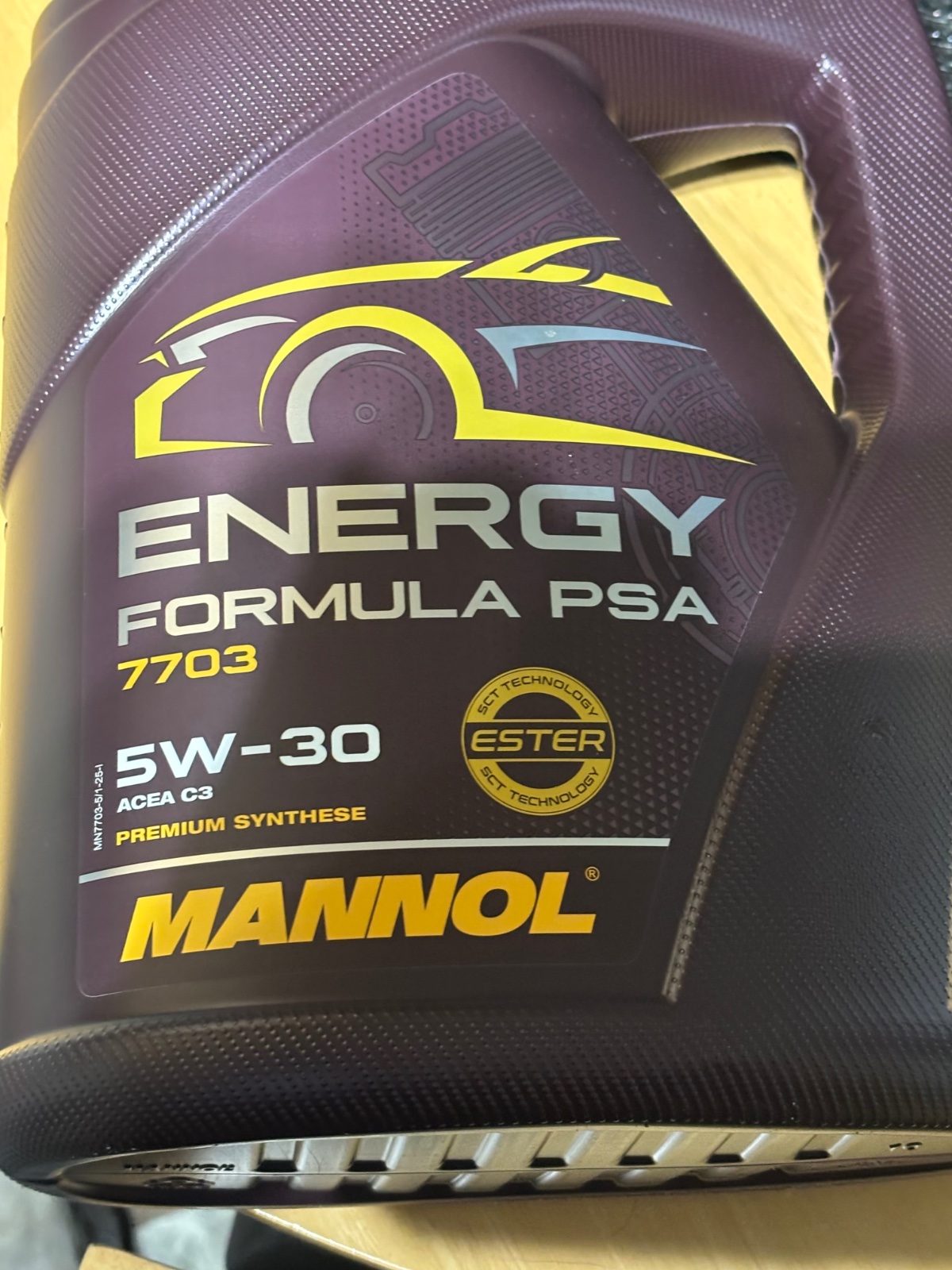

Yep the mannol oil is badged up correctly.
