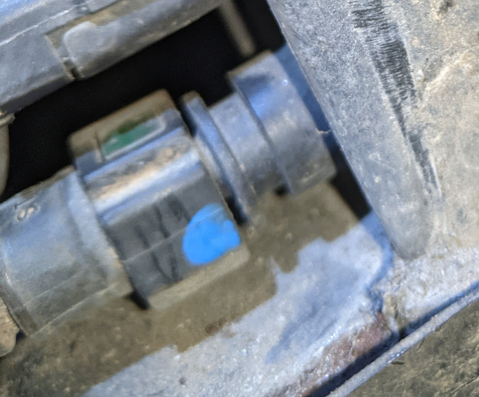

I am trying to work out the correct fluid for a Peugeot 4007 with a build date 12996 (June 2012)
I believe this indicates Eolys Powerflex.
However the click fit connector has GREEN release buttons, but there is a dab of blue paint on the click fit housing....
Can anyone confirm the factory use of dabs of blue paint to override the green click fit connector?
You have a pouch system in this vehicle - these are NOT intended for refill as the pouch will likely tear on extraction ' refit and you don't want that stuff on you.
You require a 1Lt Powerflex pouch.
Be aware you will also need a professional level diagnostic tool to reset the additive counter, or the engine ECU will not know you have changed it and this will lead to issues. The additive is NOT physically measured, so relies on being told it has been replaced and reset.
