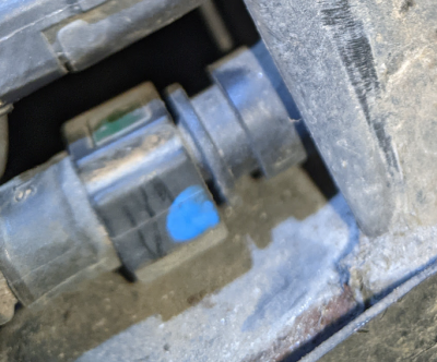

Green click fit connector with blue paint
GiveMeABreak wrote: 01 Nov 2018, 22:03 Hi Simon, ok, so your build date is 12530.
This means your vehicle should be using EOLYS Powerflex additive. Your additive tank should have a Blue cap / click fit connectors for clarification.
Walker supply this fluid product code 80620 which is a 3L kit.
I am trying to work out the correct fluid for a Peugeot 4007 with a build date 12996 (June 2012)
I believe this indicates Eolys Powerflex.
However the click fit connector has GREEN release buttons, but there is a dab of blue paint on the click fit housing....
Can anyone confirm the factory use of dabs of blue paint to override the green click fit connector?
x 6961
Re: Fuel additive level too low error
It's Powerflex for this build date. You never go on the click-fit colours, because they can use either colour.
