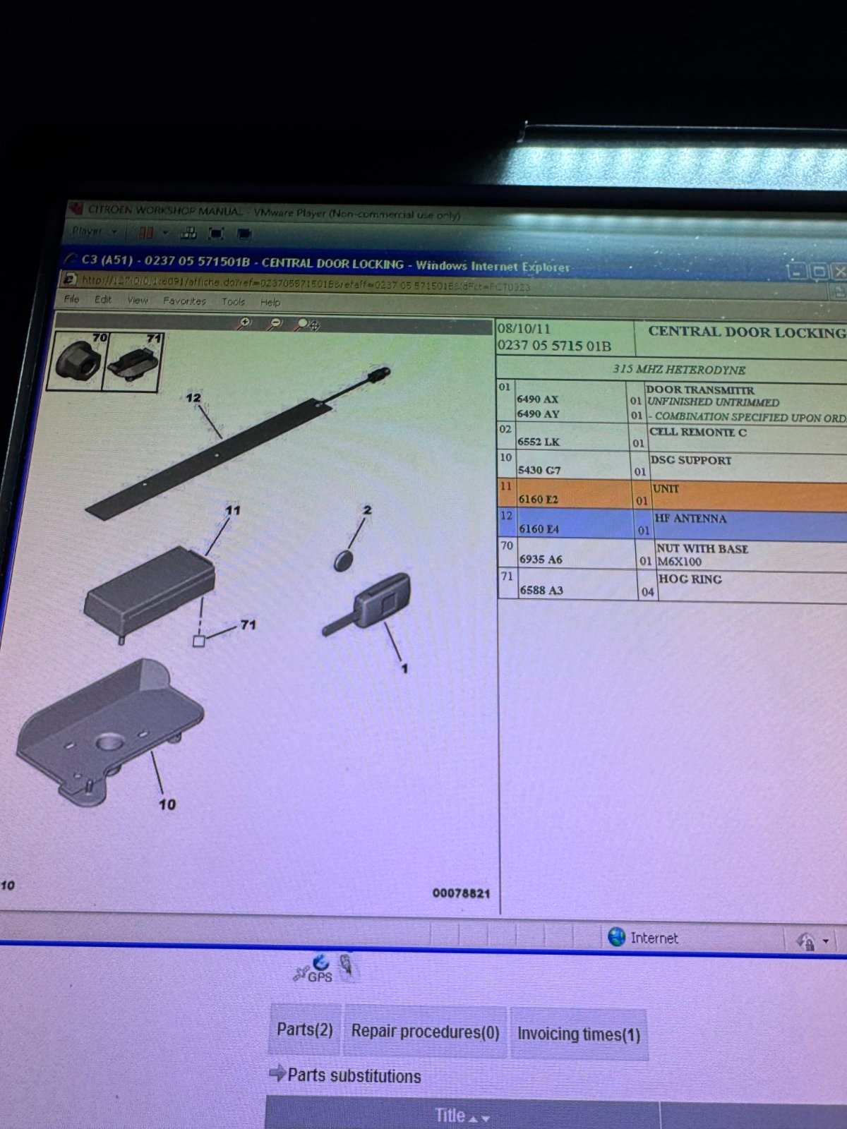

my car 2014 Citroen c3 mk2 ......can any body tell me what the attached image is what it does and its location please auto electrician told me mine is missing but then left into the unknown ?
what is this 2014 Citroen c3

Part 12 looks to be labelled HF antenna. No idea where it will be though.

What it does question. It looks like the receiver aerial and unit for the remote central locking. Does your car have that as part of its specification, and if so does it work?

This unit will only be found on vehicles destined for outside Europe that use 315 MHz Remote frequency. You can see it says 315 MHz at the top of the screen.
If you are looking for the HF receiver its integrated into the Comms unit (the wiper & lighting stalk assembly).
In Europe we use almost exclusively 434 MHz remote with a few exceptions on Audi & BMW where you can sometimes fine 868 MHz remotes

my car has remote locking but it dosnt work thanksRichard_C wrote: 03 Jan 2026, 20:25 What it does question. It looks like the receiver aerial and unit for the remote central locking. Does your car have that as part of its specification, and if so does it work?

thankyou for the info my remote locking dosnt work so auto electrician changed the comms unit but it still came up no comunictation with hf unit so he give me this picture then he disapeared ? so at least i wont buy one of these now but to be honest i couldnt find one anywaywheeler wrote: 04 Jan 2026, 13:04 This unit will only be found on vehicles destined for outside Europe that use 315 MHz Remote frequency. You can see it says 315 MHz at the top of the screen.

Yeah you will always get no comms with the HF unit...... unless you have a Japanese modelmemine wrote: 04 Jan 2026, 17:20 still came up no comunictation with hf unit so he give me this picture then he disapeared ?
