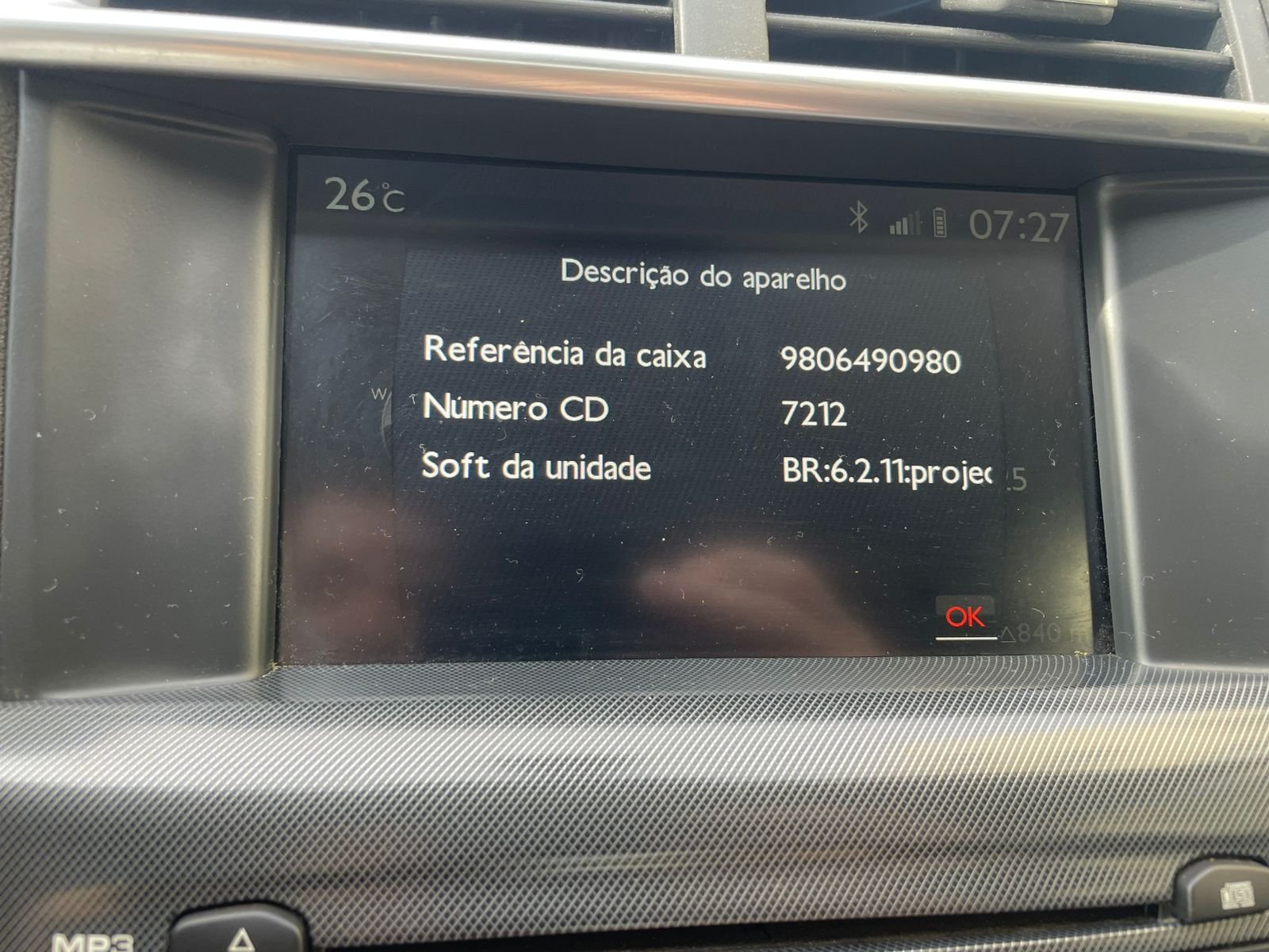

prco
- Posts: 5
- Joined: 12 Dec 2025, 21:01
Re: RT6 2.75.c.5 Firmware / Software Download
"Soft da unidade - BR:6.2.11:project"
Looks like my version is 2.11, right? I've already tried to update it but RT6 just boot into the pen drive with the newer version and don't install it. Can you teach me the correct way to update the system?

OnlinePaul-R
- Posts: 9366
- x 1938
It actually says 6.2.11 which looks like a version number for SMEG+ IV2 systems. Can you post a photograph of the system in your car? Is it touchscreen?
