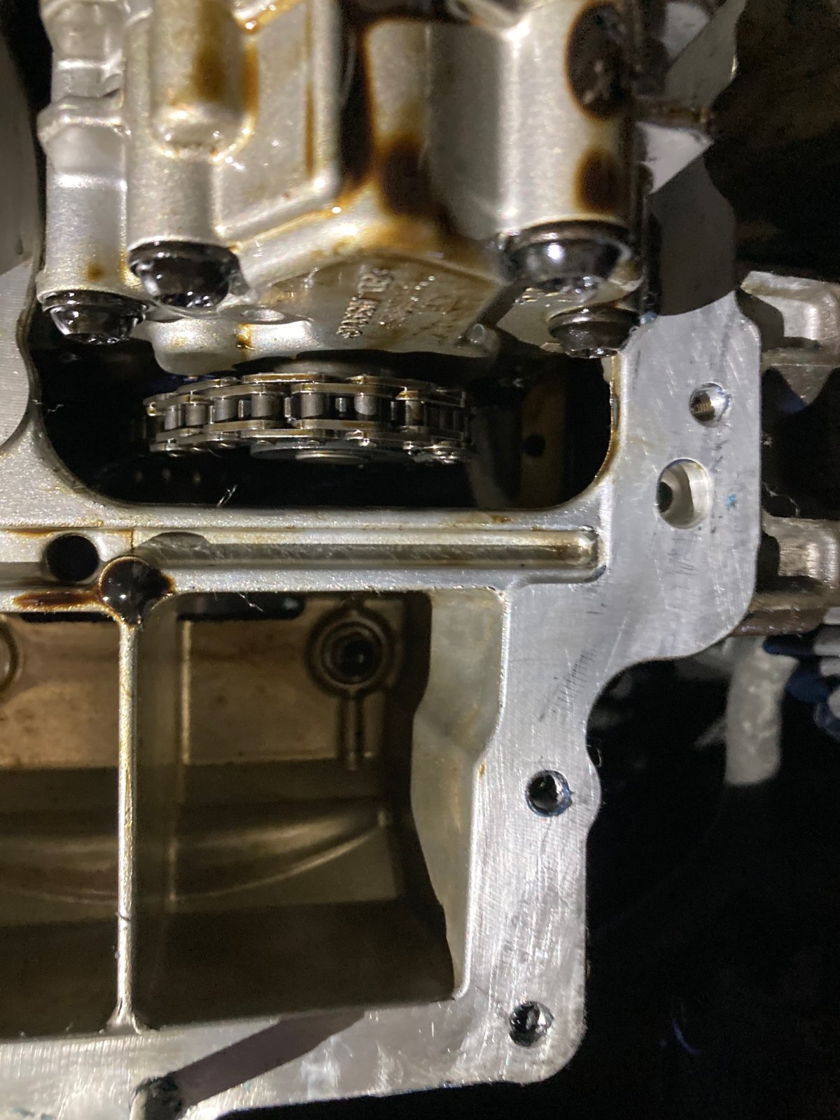

Hello all,
Quick update for the motor I happen to have
Unfortunately, the chain won't slip past the oil pump gear and engine wall. Approx 1.5 mm too narrow.
So... I shall travel forth with the loosey goosey chain I've got.
I've attached a pic after dropping the oil pan.
Cheers
