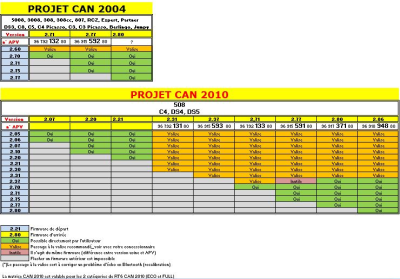

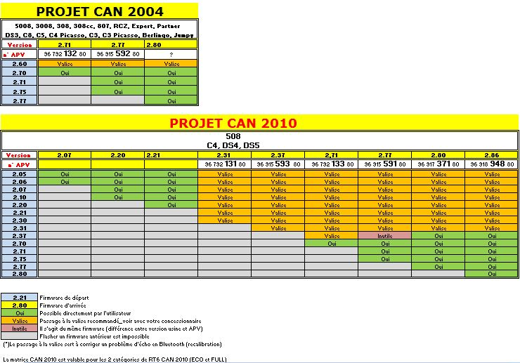

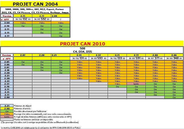

These charts may help with some understanding.
You may be looking for something that doesn't exist. The top chart in the second file suggests that your 3008 has a CAN 2004 system and doesn't show an upgrade path to 2.86. It may be out of date as my C5 is showing as belonging there as well and it most definitely has 2.86 installed. Having said that the car had a new RT6 fitted in 2016 under warranty. It's possible that an update to 2.86 is something only the manufacturers can do.
The part number showing for 2.86 in the lower chart appears to be the same as the link that Mick found on the Internet Archive.
