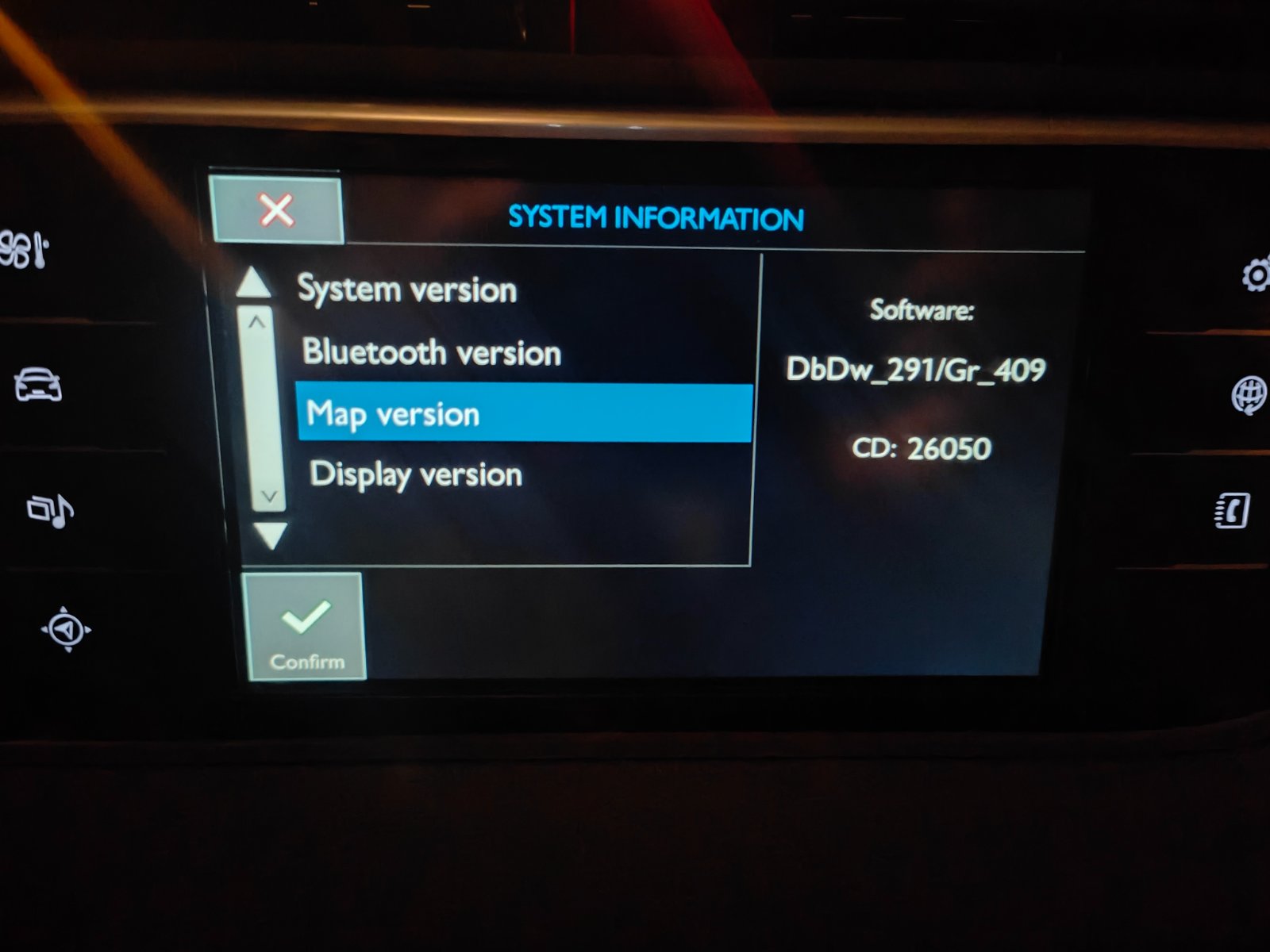

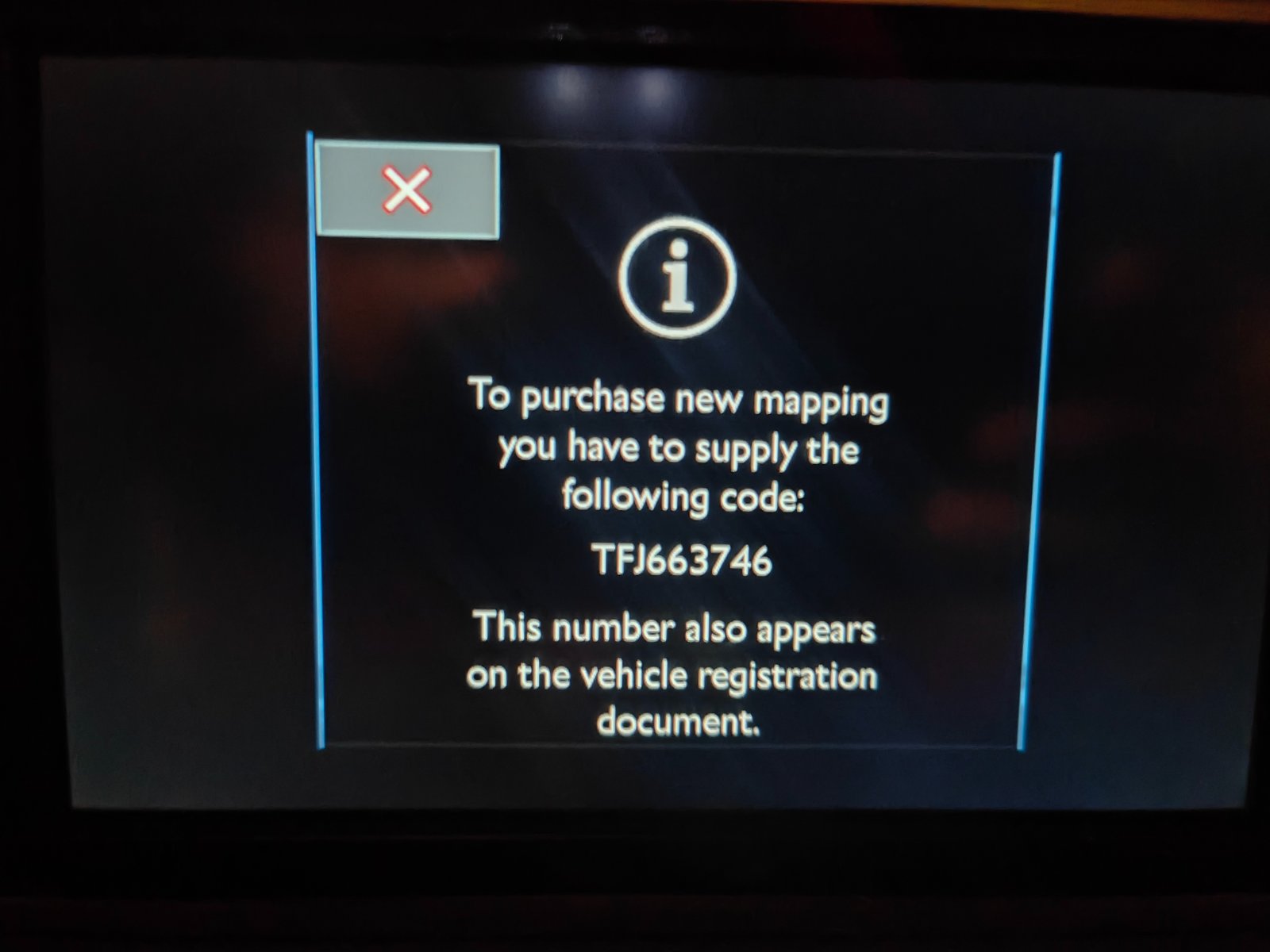

I can't find a way to even launch the map updates.
Edit. Holding the car icon until the beep, it restarts the system after a dozen seconds. And then I get "Failed. Unable to read the disc".

Hello,
I followed the instructions in the first post, I did get the map files from the Citroën links, and I do have my activation code from SMEG+ data. The map files are on the USB stick formatted as FAT32.
Updating the internal SD card might be a possibility but I don't know if it had a lot of writes since it appears to never have been updated. In the https://www.peugeotforums.com/threads/s ... re.168681/ I don't see more than 81 pages.
Maybe I should indeed update the firmware first.

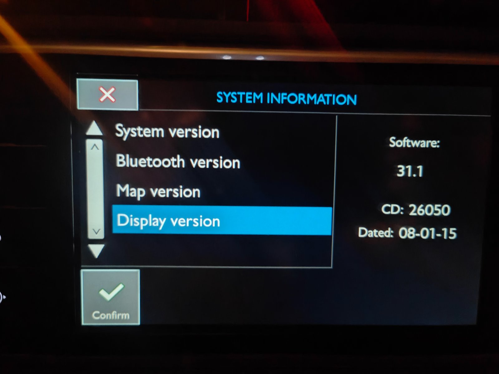

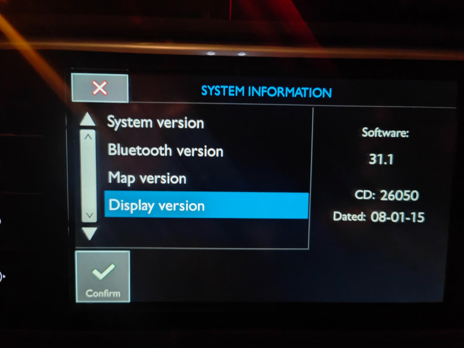

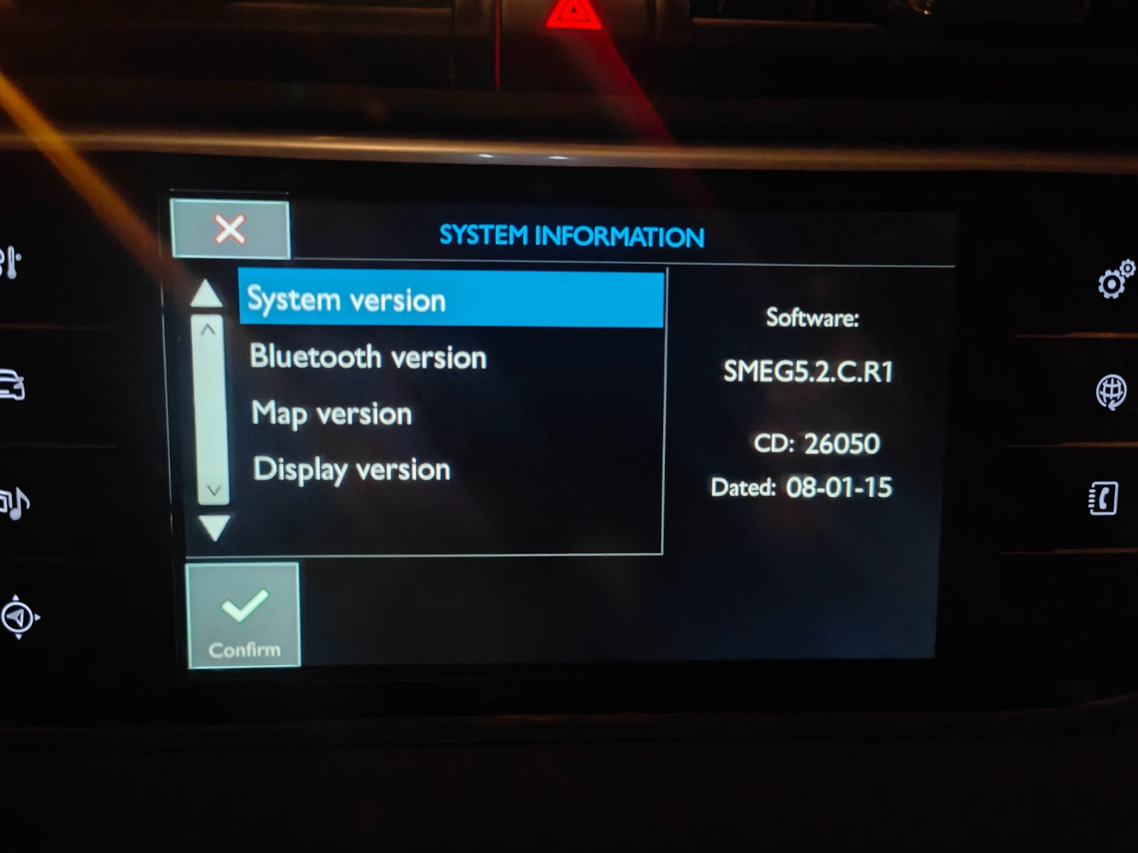

Re: C5 firmware
I didn't try as I mainly use bluetooth instead, or just silence. Maybe they do work.
I'll try to update the firmware first, I downloaded the 5.43 version, I think I need a license file in addition to the download on the first post there which I don't have

Re: C5 firmware
None of the firmware updates need a licence to install but you might need a password to extract the files from a zip.

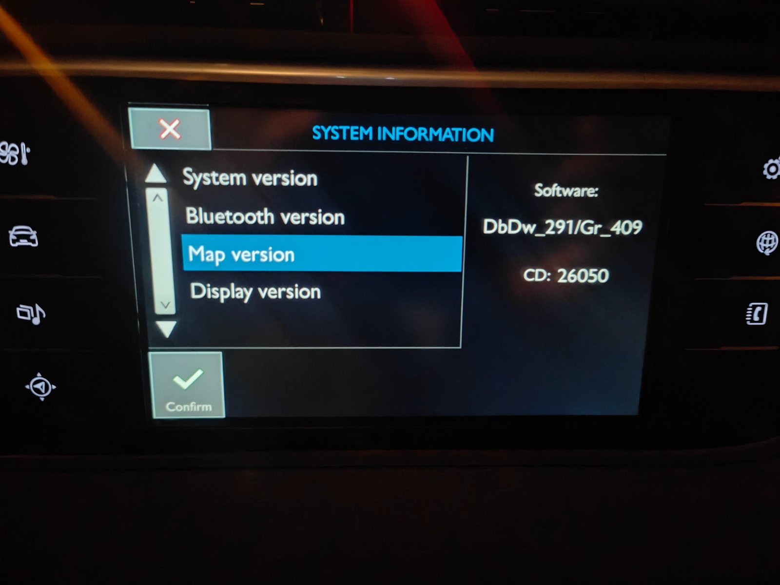

Re: C5 firmware

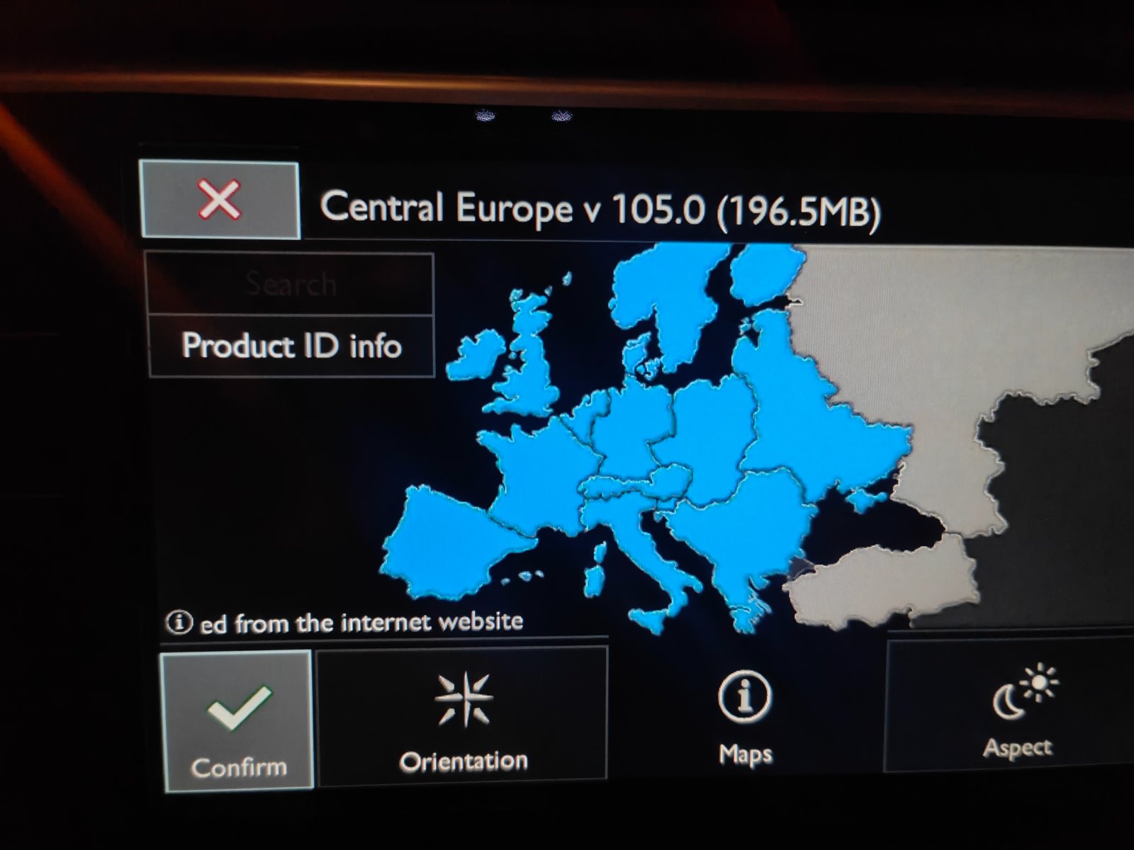

So the maps are recognized now.
I don't know about the firmware update procedure, but I'd like to complete it before updating the maps and speed cams.
