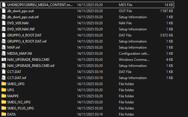

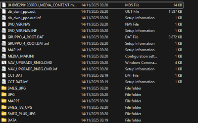

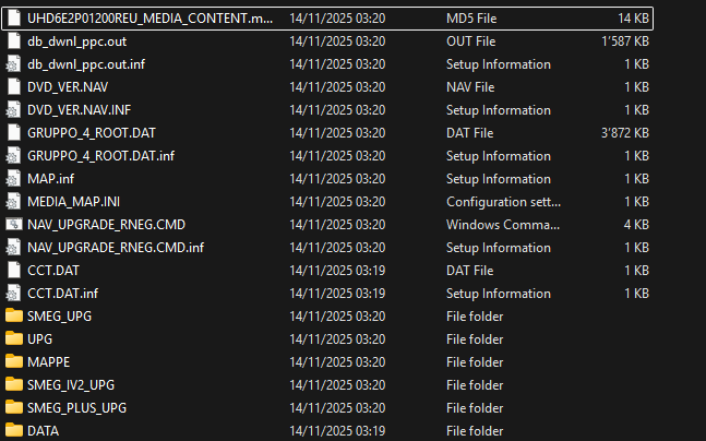

There are two things I'm trying to do.
- Update the firmware. I have no start point for this. My dealer said support has been discontinued and they don't offer updates anymore, suggesting getting a new car...
- Update the maps. This I'm starting from the files you provided above, my serial ID, activation code. USB stick is simply not recognized.
Here the requested details of the USB stick. (one for each update package). Placed on Root folder.
My C4GP has two USB sockets.
- Posts: 9148
- x 1903
Re: C5 firmware
The images aren't showing. Upload them to the forum by clicking on the Full Editor & Preview button just under the Quick Reply box below Then go to the Attachments tab and follow the instructions.
