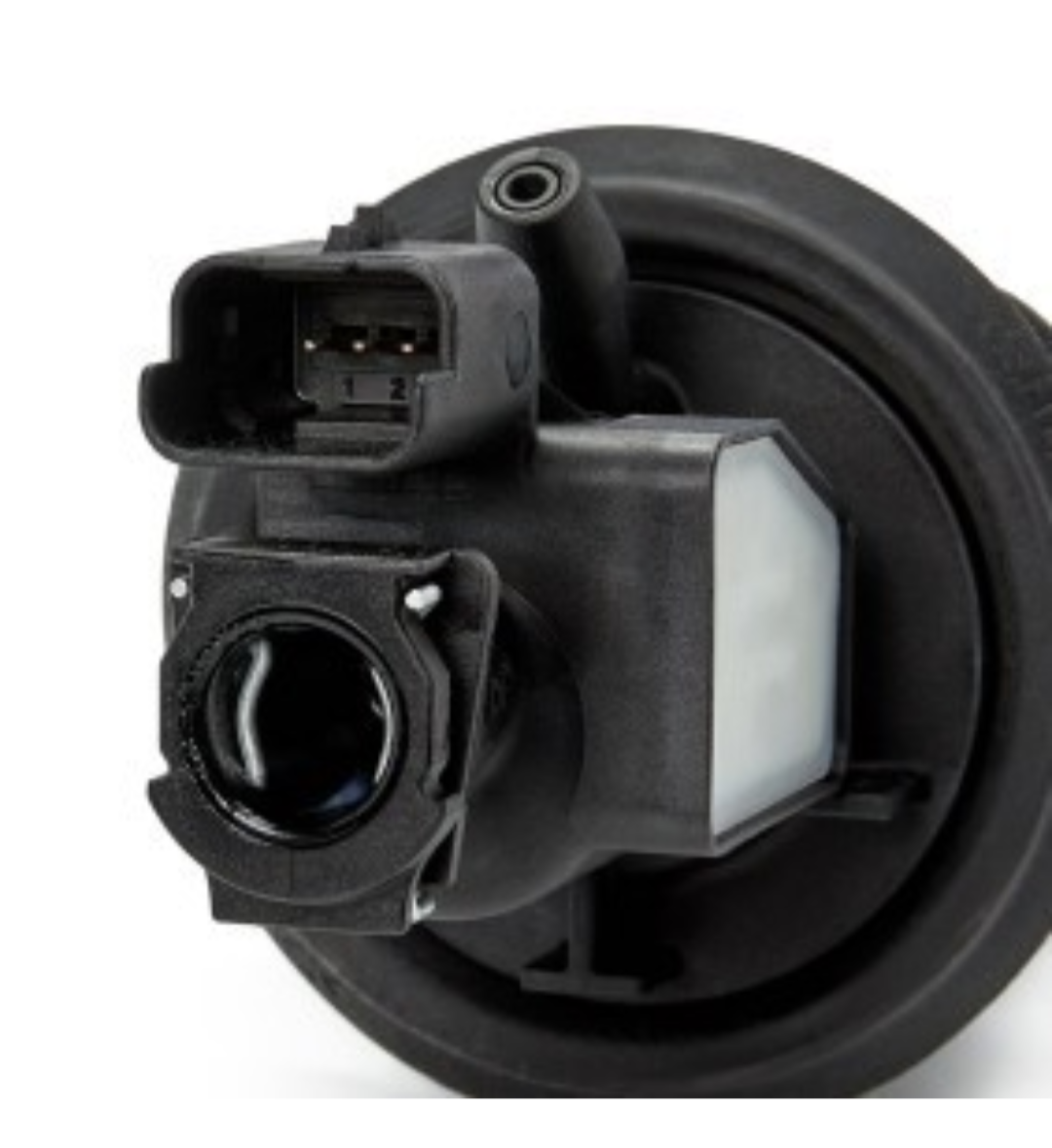

I'm intrigued by the electrical connector. Is it to signal a command to the BSI etc. to disengage cruise control when the clutch is operated?
406 has a simple, separate brake light type switch for this task, I guess someone had a great idea of combining different failure modes into one big assembly presumably saving 5 pence on the 308 production line.... :lol:

This is a good image from Autodoc of the electrical (and hydraulic) connection(s) on a master cylinder:

Does it have push button start, and do you need to press the clutch to get it to start? In which case, that will be the requirement for the electrical connector... having said that I'm pretty sure my 3008 has a clutch pedal position sensor giving a % read out, and that is key start with no need to press the clutch.....
Master cylinder failure is common on C4 Picassos, I would imagine it's the same (plastic!?!) item. Not sure how you would diagnose one or the other?

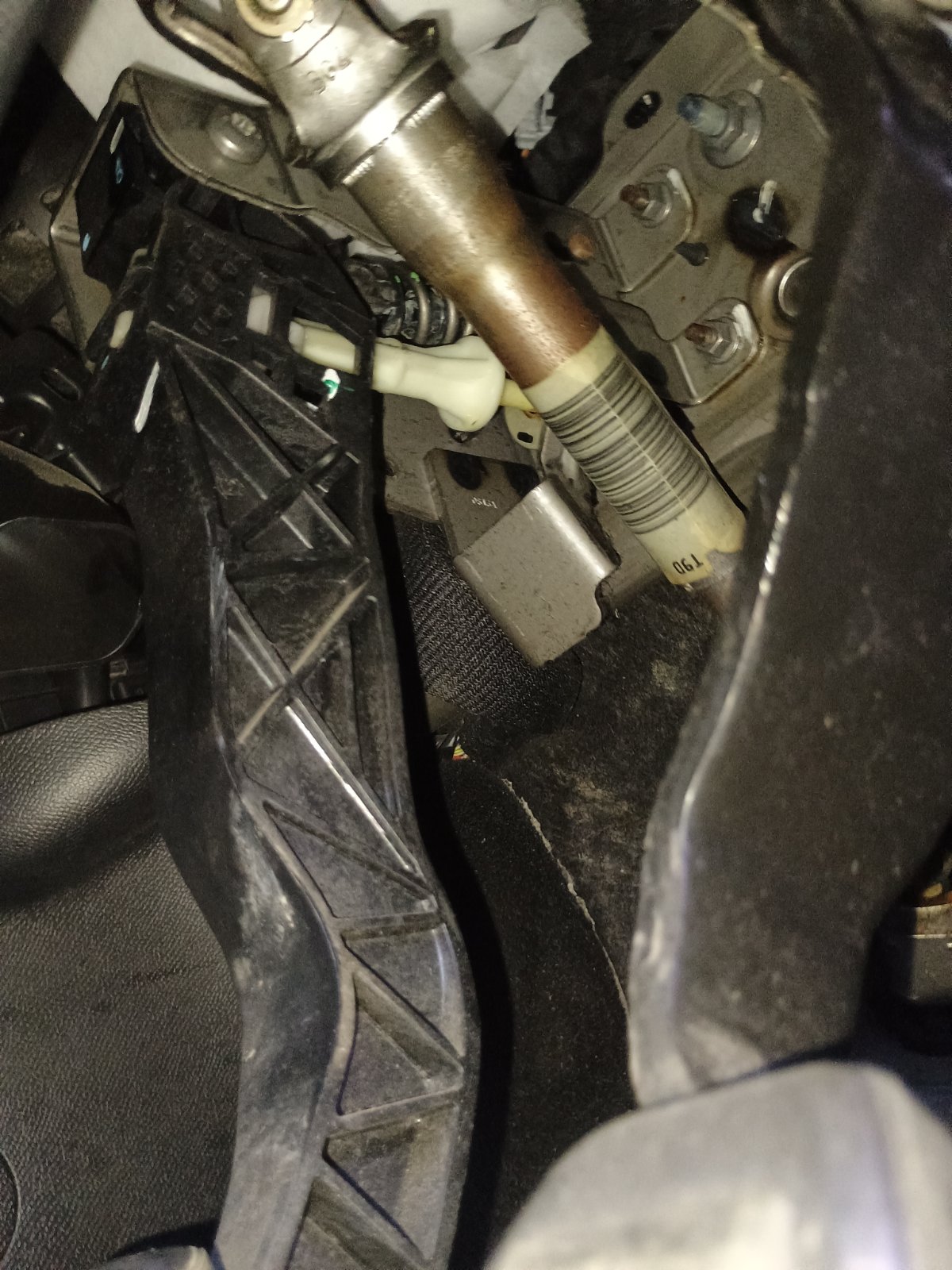

Basis for it (hopefully) being this end:
Mucky / oily on the end of here!

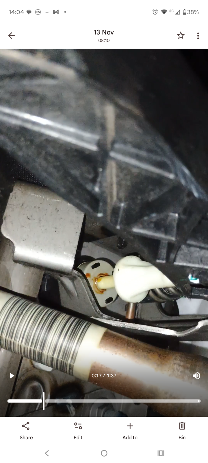

Took a video, here's a still image

If you hear that sound like air being drawn when the pedal is worked (clutch) then its pedal end , as a rule once one plays up then the other will follow suit, be alert as ebay is full of Chinese fakes. Might sound daft if you find a 308 being broken for spares I'd go that route , why I hear you say , my Picasso went through several parts off Ebay, I was ready to scrap the car then saw one bein pg broken for parts I purchased the top cylinder that connects to the clutch pedal which was a genuine psa one , and it was confirmed whe it arrived, it felt different the whole material and the feeling of the clutch when pedal being used to changed gears too , the pedal was so much lighter and easy to depress and so on , i sold the car weeks ago and the chap is still driving it around as from 4 days ago , he saw me pointed at the car and big smile on his face and thumbs up , and a little bit of advice from an old fart, dont over think the job on any car, follow your gut , then what you know will guide you to the end result., keep us posted matt. Oh just something to tick off the list , whe or has your car had the whole clucth renewed at all ? As what I've noticed these parts fail if the mass flywheel has age related wear.
