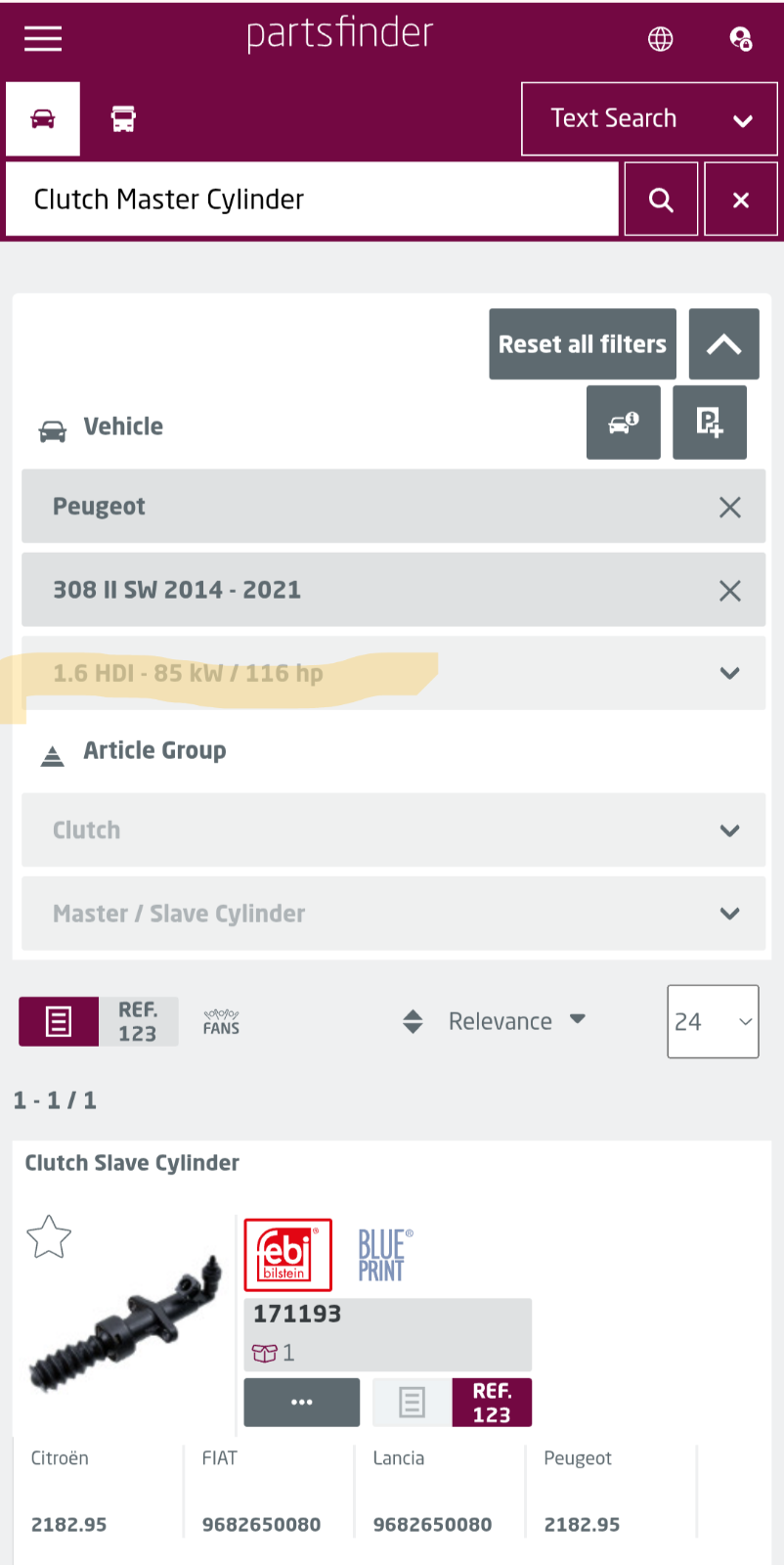

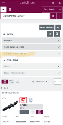

I've just had a look on the Febi Bilstein website https://partsfinder.bilsteingroup.com/en/index which is normally a good reference for regular service or replacement items but drawn a blank. You might have better luck with a more refined search.

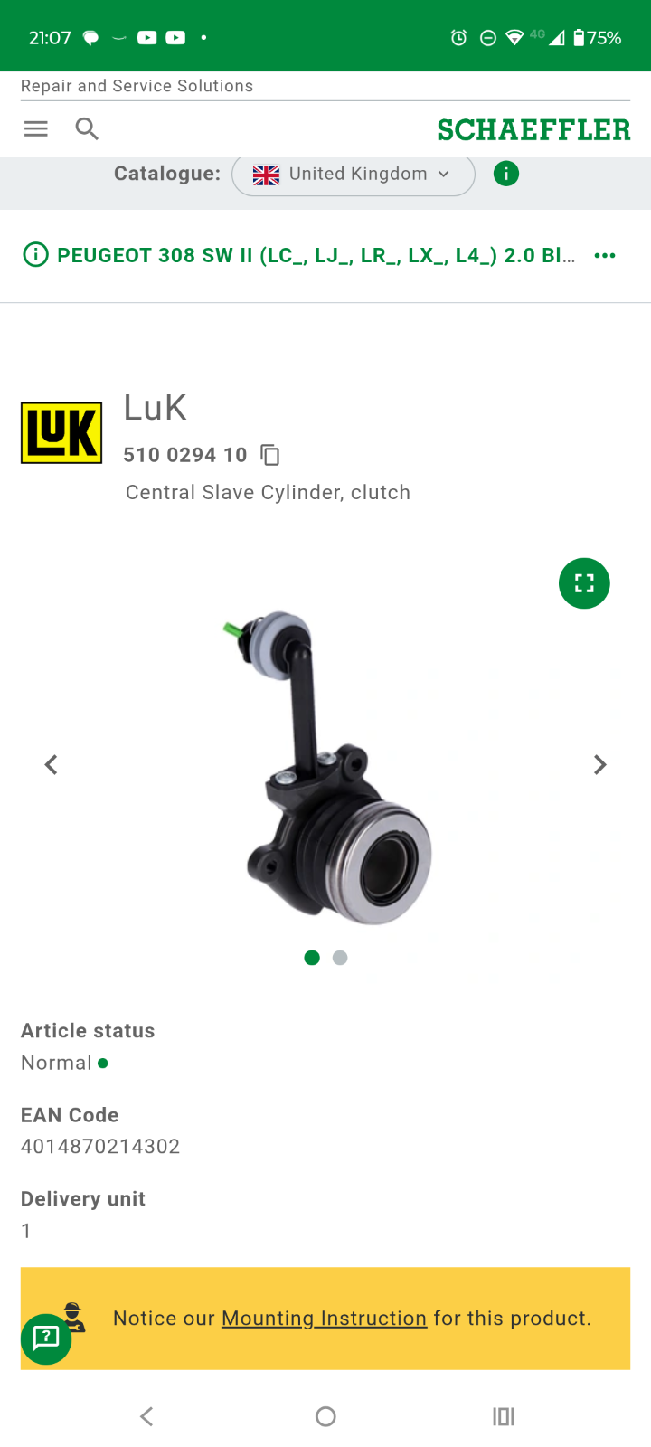

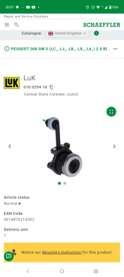

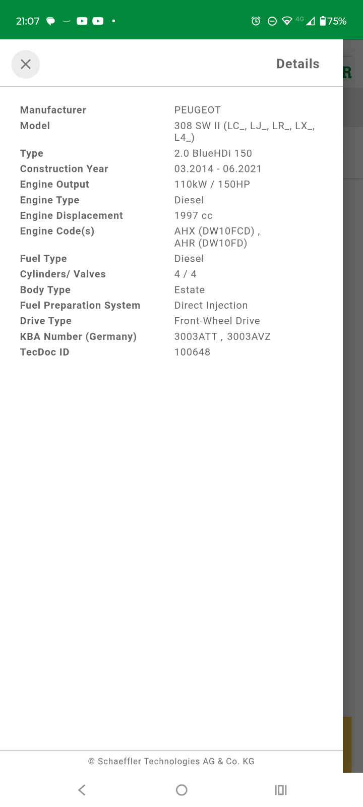

Is this the correct slave listed at LUK ?
https://vehiclelifetimesolutions.schaef ... -TA-100648
Checking ebay with the LUK p/n gives cheaper options...... presuming that's actually the correct one !

bobins wrote: 12 Nov 2025, 20:10 I've just had a look on the Febi Bilstein website https://partsfinder.bilsteingroup.com/en/index which is normally a good reference for regular service or replacement items but drawn a blank. You might have better luck with a more refined search.
Very odd, select
Peugeot
Then 308 ii SW
And ... It gives only 1.6 HDi

bobins wrote: 12 Nov 2025, 20:17 Is this the correct slave listed at LUK ?
Details seem correct:
