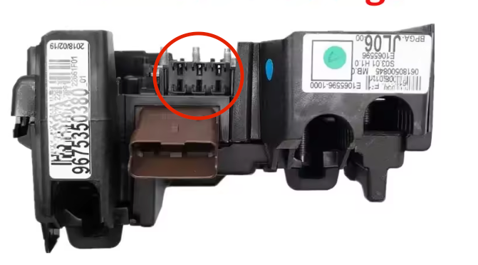

Problem solved by officials. I forgot to install fuse on new BPGA. That costed me another 120 Euros.OlYa wrote: 03 Aug 2025, 09:54 Hi there! Sorry for restarting old topic.

Ouch, an expensive lesson. It reinforces the mantra to check that a replacement item is configured exactly as per the original.
Thank you for letting us know.

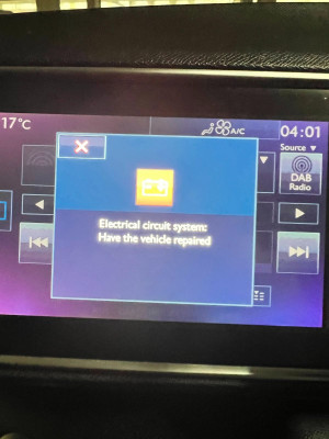

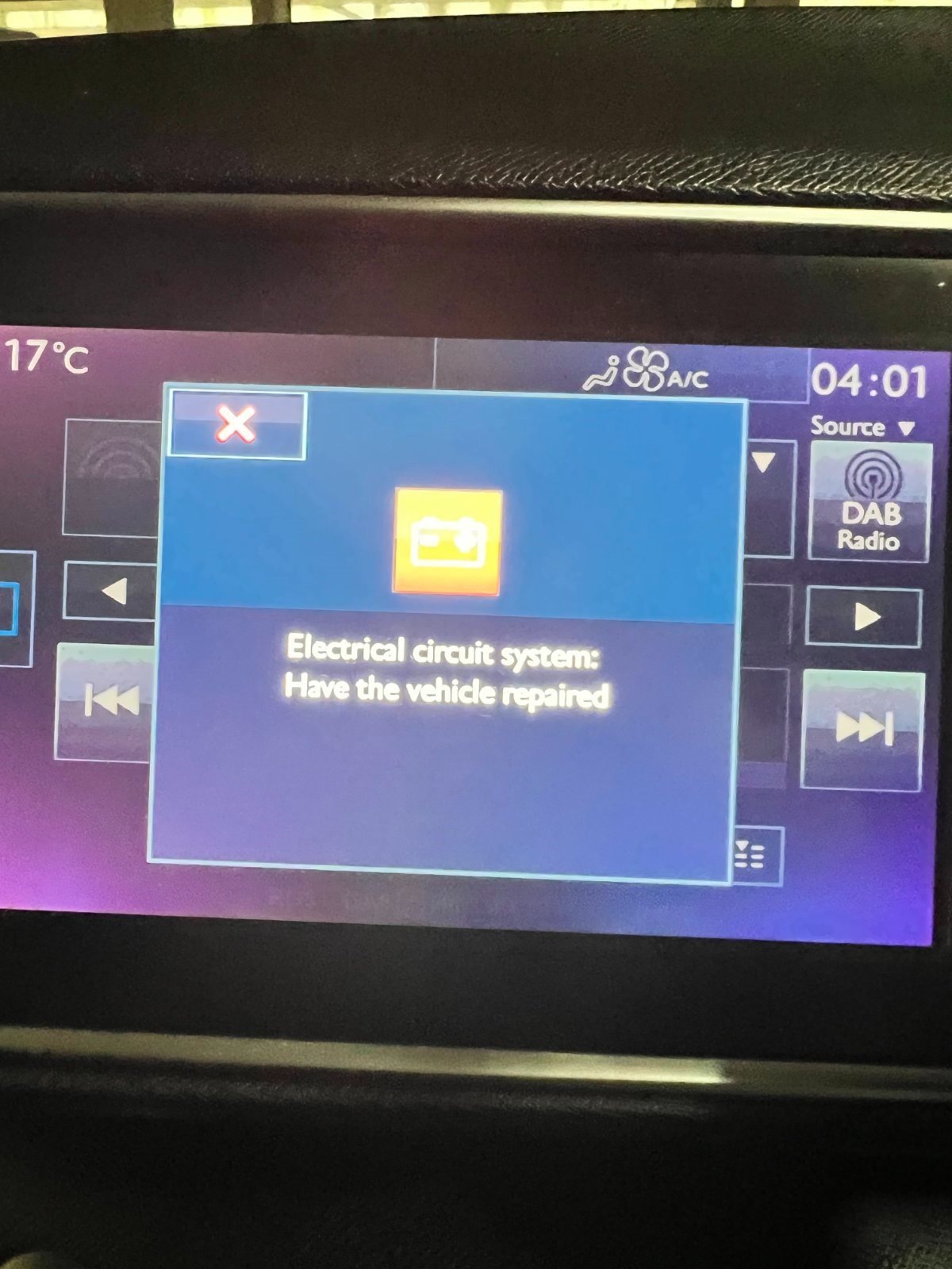

I seem to be in a very similar situation to many others here. Back in May, the warning “Electrical Circuit System: Have the vehicle repaired” first appeared on my 308 SW (2016). I had it serviced at a local garage, and after being told it was sorted, the issue came back within two days, the battery drained completely and I had to use the key to open the driver’s door.
I bought a replacement battery, and the mechanic kindly came over to install it, then ran a diagnostic check at his garage. He suspected the BPGA was the likely culprit.
Oddly, after that the warning only appeared sporadically and the car seemed OK for a while. But yesterday, the power went completely again. The electronic fob wouldn’t work, and after opening it with the key, I found the car was totally dead with no power at all.

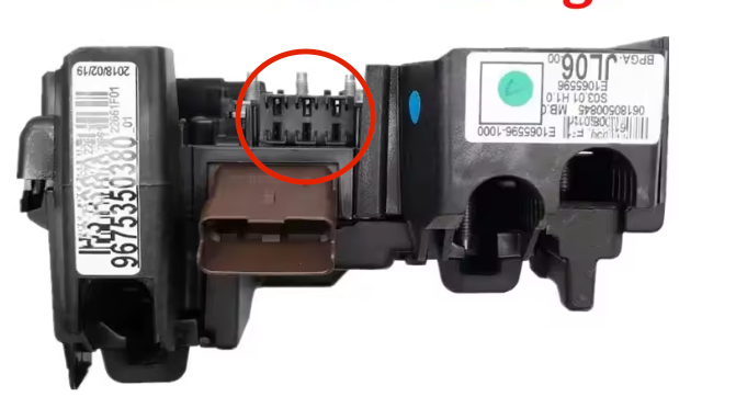

Some pictures here: I nearly missed these too! Not obvious at all!!OlYa wrote: 15 Aug 2025, 11:43Problem solved by officials. I forgot to install fuse on new BPGA. That costed me another 120 Euros.OlYa wrote: 03 Aug 2025, 09:54 Hi there! Sorry for restarting old topic.
The problem (Electric circuit error, Battery charging error) came first a year ago. I replaced a battery (it was still original) and problem disappeared.
Till now. Besides dashboard messages the car experienced no faults. After yearly maintenance I was told to prepare 800 Euro for new part and work and I took time to think about.
But after one week in garage the car's battery was drained completely.
As 800 euro was still not an option, I have replace BPGA following advices from this thread with completely drained battery.
The part: https://de.aliexpress.com/item/10050031 ... pt=glo2deu
1. I did connection to a new BPGA one contact after another to avoid mistakes.
2. Two fuses on a new part were missing, so I took them from old.
3. After replacement I started my car using booster (don't know how it can be properly called)
Electric circuit error is gone, but I have now engine error and permanently shimmering rear lights.
Do you gays have any thoughts why lights shimmer (flicker quickly)?
And was engine error mainly due to completely drained battery?
https://frenchcarforum.co.uk/forum/view ... ga#p841600
