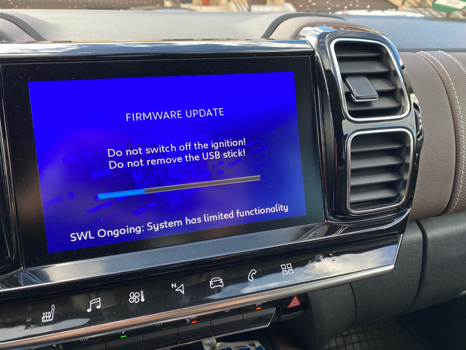

@owl : So you are in the second case - your car has the 3x.xx.xx.xx firmware version installed, but it is already identified as a NAC_EUR_WAVE4 system. You need to download the latest NAC Wave 4 firmware (44.07.33.32_NAC-r0) and you also need the respective license for that version (MediaVersion/UpdateID 001315031692686757) and your infotainment system serial number/unique identifier (UIN). To do that, you need to know your UIN, a 20-digit hexadecimal number. You might have an old license file ("license_xxxxxxxxxxxxxxxxxxxx_001315031*.key") or you could export the current infotainment system configuration to a FAT32-formatted USB flash drive:
- Press the cog/hours (top right corner);
- OPTIONS (lower left);
- System settings (top left);
- System info (lower right);
- Export config.
And it should create 2 files, "instkey_xxxxxxxxxxxxxxxxxxxx.xml" and "packageslist_xxxxxxxxxxxxxxxxxxxx.txt". All those xxx...xxx is your UIN. You can also see your UIN in the "Engineering mode":
- Press and hold the media/audio button (2 semiquavers) for 6 to 7 seconds (use a timer);
- Input 1134 in the code (you should not see any output);
- Input 1122;
- Go to the last page and search for "SUID: (--------------------), UIN: (xxxxxxxxxxxxxxxxxxxx)".
Download the license key file for that MediaVersion and UIN at (replace the xxx...xxx with your UIN):
Copy that file to a "\license" folder and extract (do not copy) the .tar update file to the same FAT32-formatted USB flash drive.
Edit:
After that firmware update, you could use the official "Citroën/DS/Opel/Peugeot/Vauxhall Update" to download the latest NAC Wave 4 map, map-eur_17.0.0-r0.

Thanks rui_saraiva finally i was able to update from wave 3 *****62 to the newest!

The certificates have been updated, so you can now upgrade from Wave 3 to Wave 4. The Peugeot Update program no longer downloads the large update (firmware + maps) — only the firmware, which is about 6 GB. I expect that once the system is updated, the option to update the maps will become available. I haven’t checked this yet.

The old file (24 874 096 640 bytes) also included the European map 10.0.0-r0. The new file (6 158 254 080 bytes) only has the 42.03.33.42_NAC-r0 firmware, and it is the exact same firmware, but signed with valid certificates.
After installing this update, you must manually install the 17.0.0-r0 European map (or other zone) for the NAC Wave 4 - it will take some time for Stellantis to acknowledge you already have a Wave 4 infotainment system, so the "Citroën/DS/Opel/Peugeot/Vauxhall Update" software won't be able to offer you any updates for Wave 4. For the same reason, you won't be able to update the system to the latest 44.07.33.33_NAC-r0 - no license is available.
