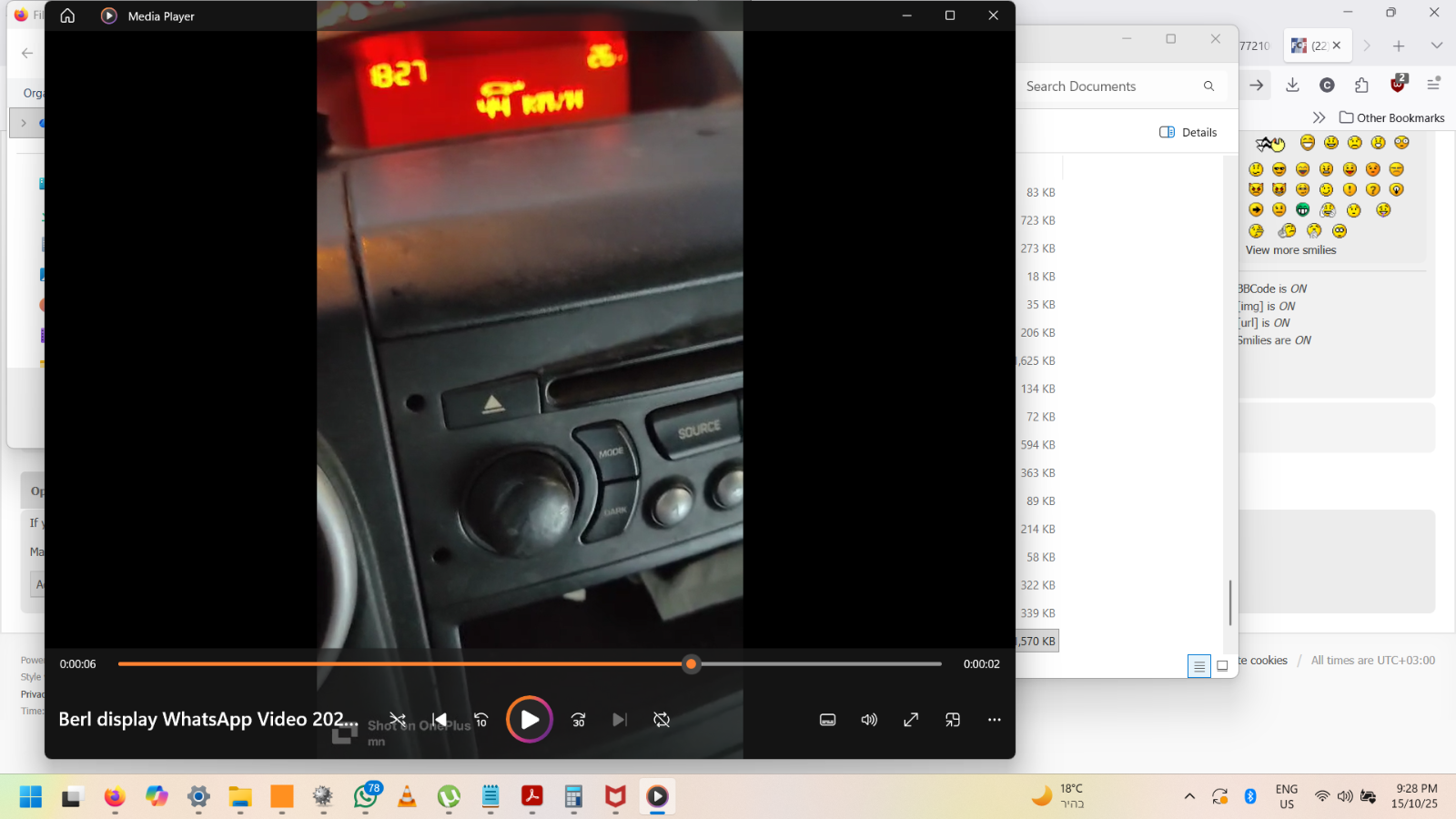

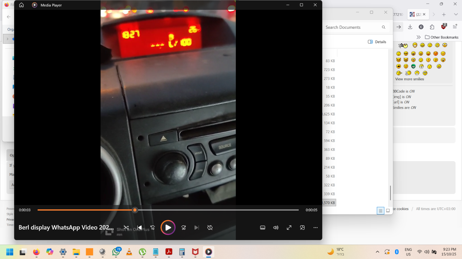

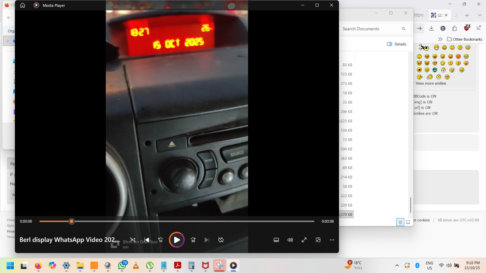

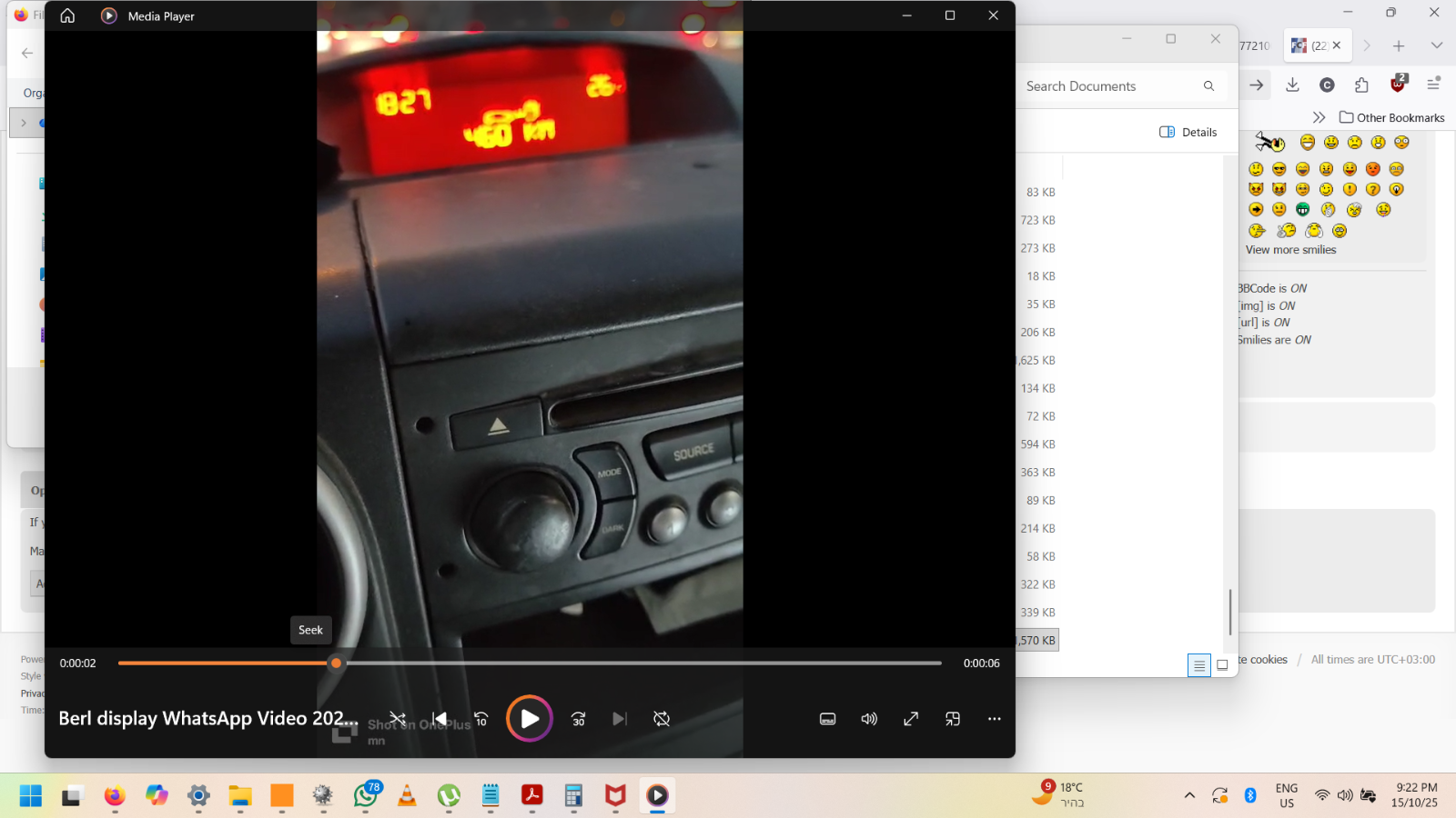

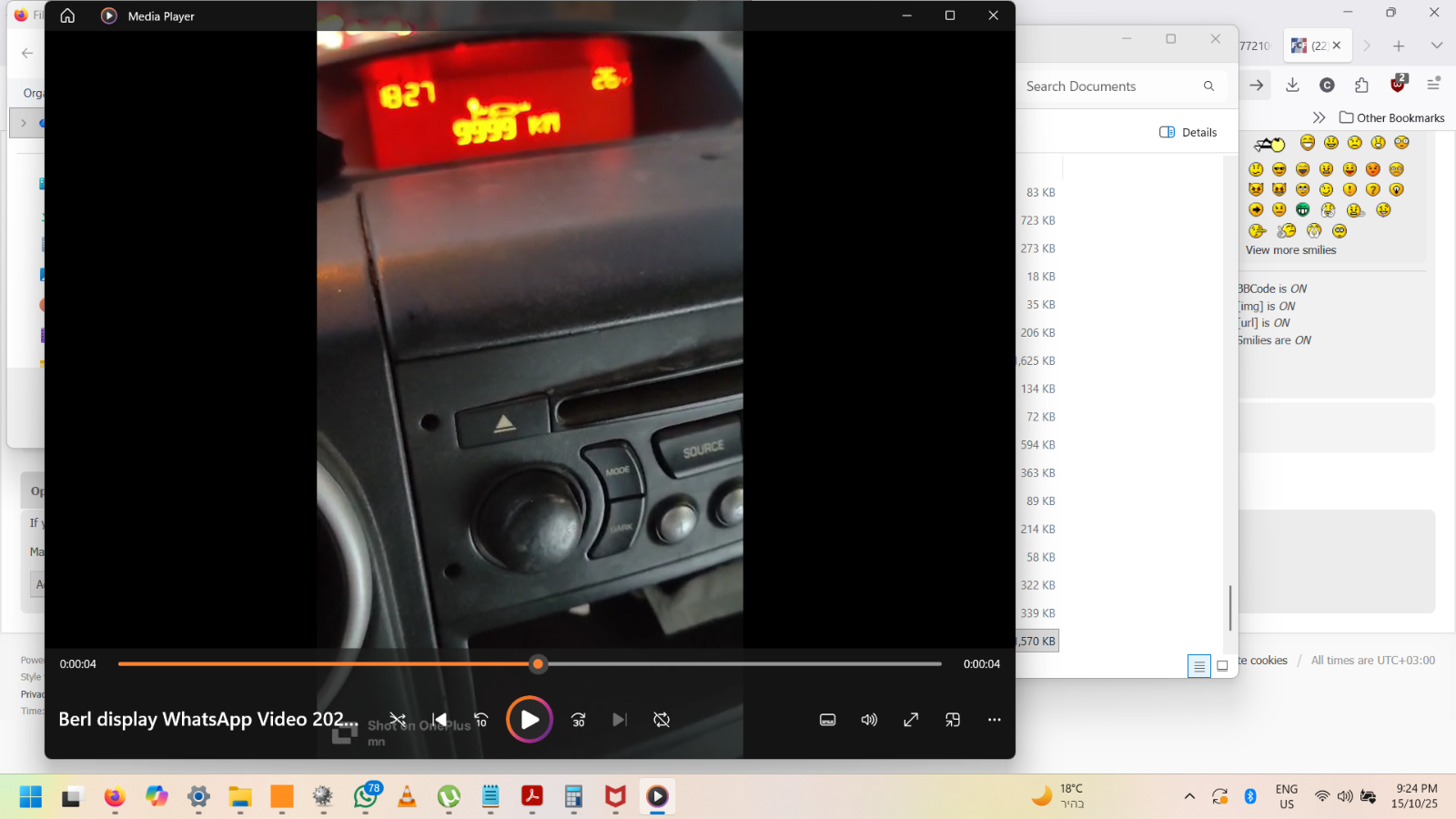

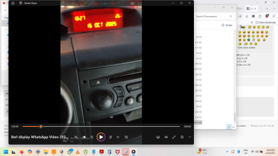

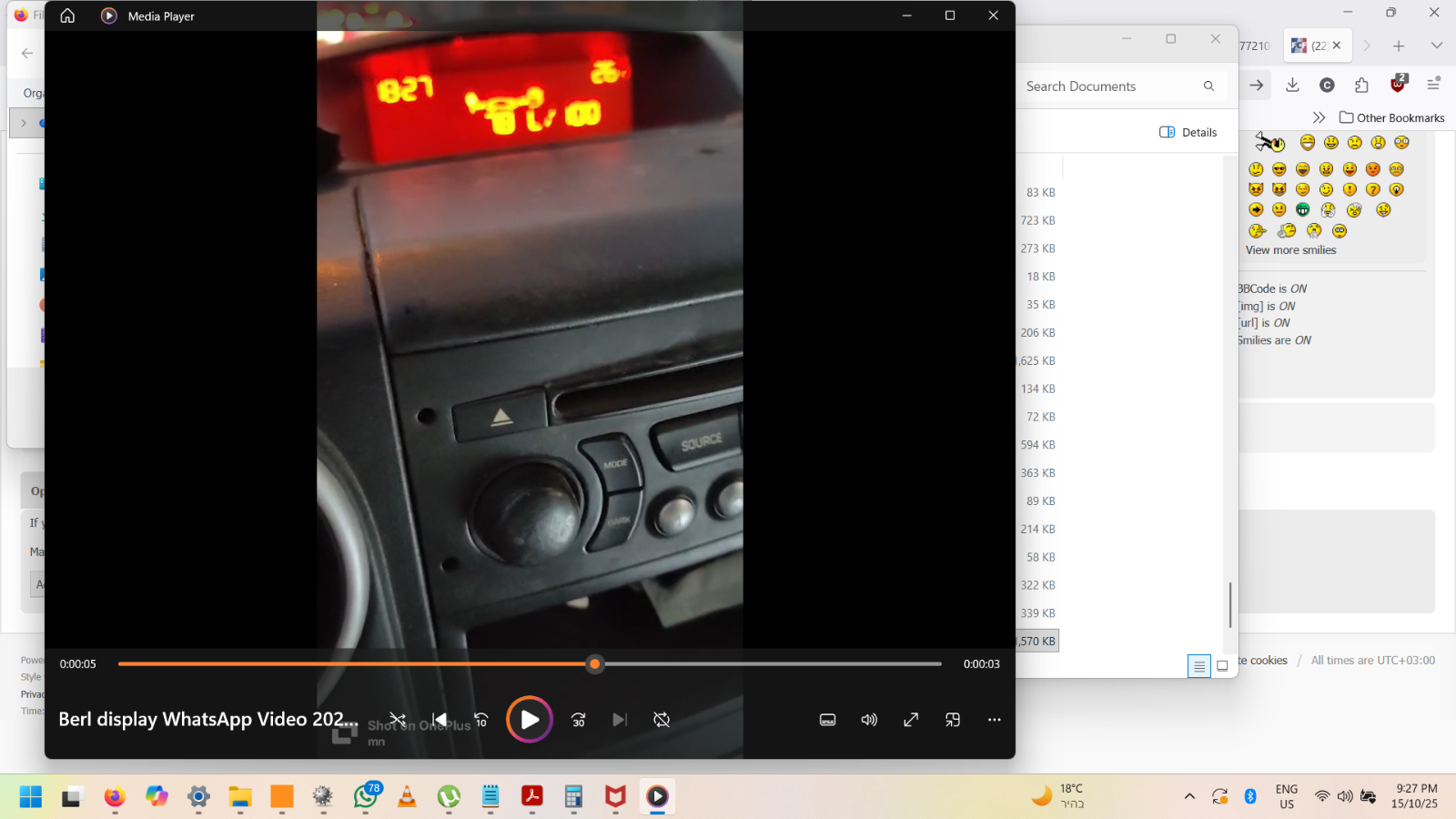

I have a 2016 Berlingo, VIN VF7**************[VIN obfuscated, can be read by forum staff]. Suddenly, the display was limited to what is shown in the pictures. The radio won't work. None of the diagnostics work. Occasionally, when I first turn on the ignition, the display will show "Initialize pressure" but does not give me access. Anyone have any ideas?

I would suggest you try a BSI reset to have a blank sheet to start from and then see what you have. You will probably need to scan the car with Diagbox to determine what is going on. BSI reset procedure: viewtopic.php?p=601679#p601679 :)

Just wanted to say Thank You to Mick. The BSI reset solved the problem. Can I buy you a "coffee"?
