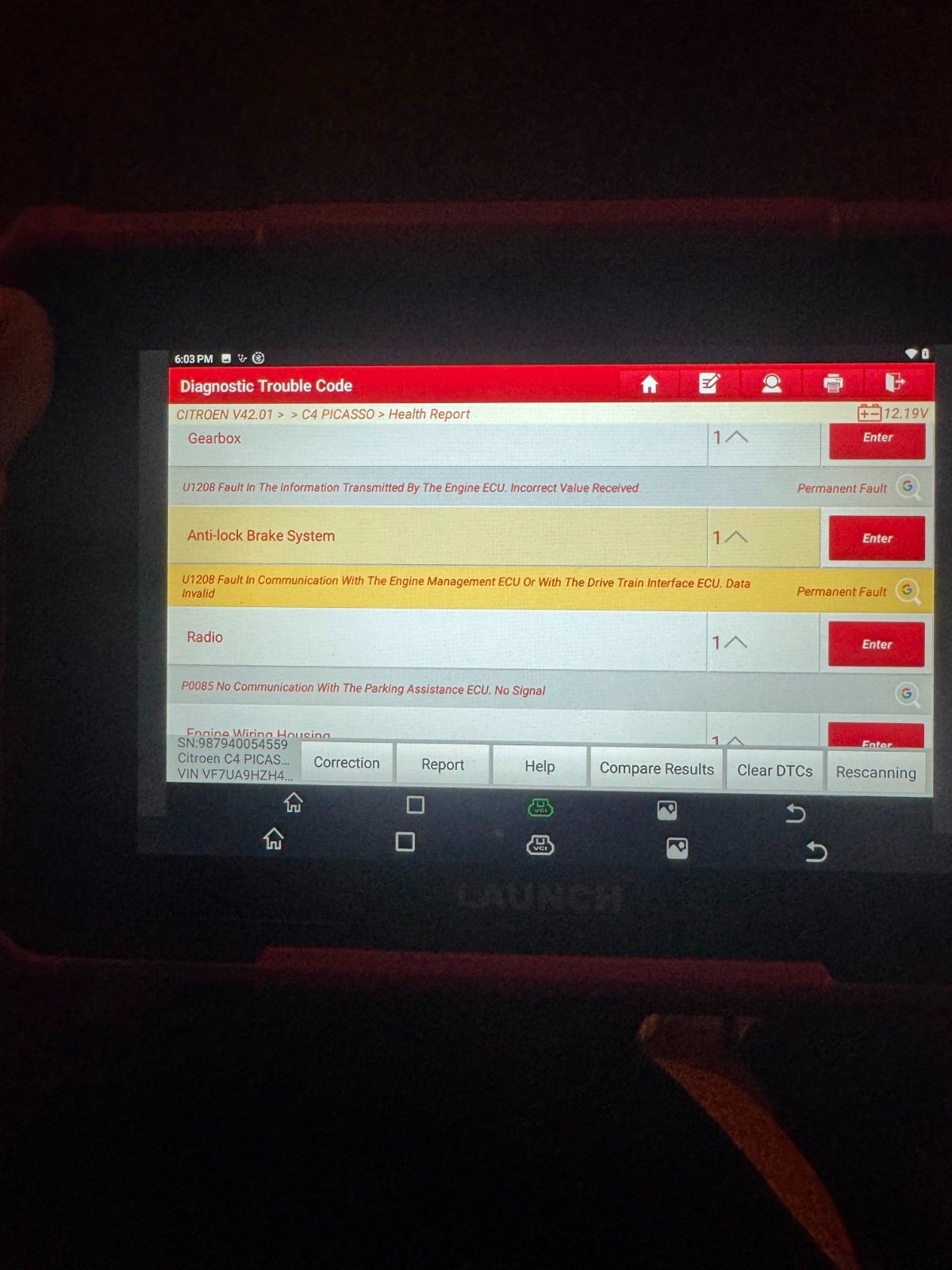

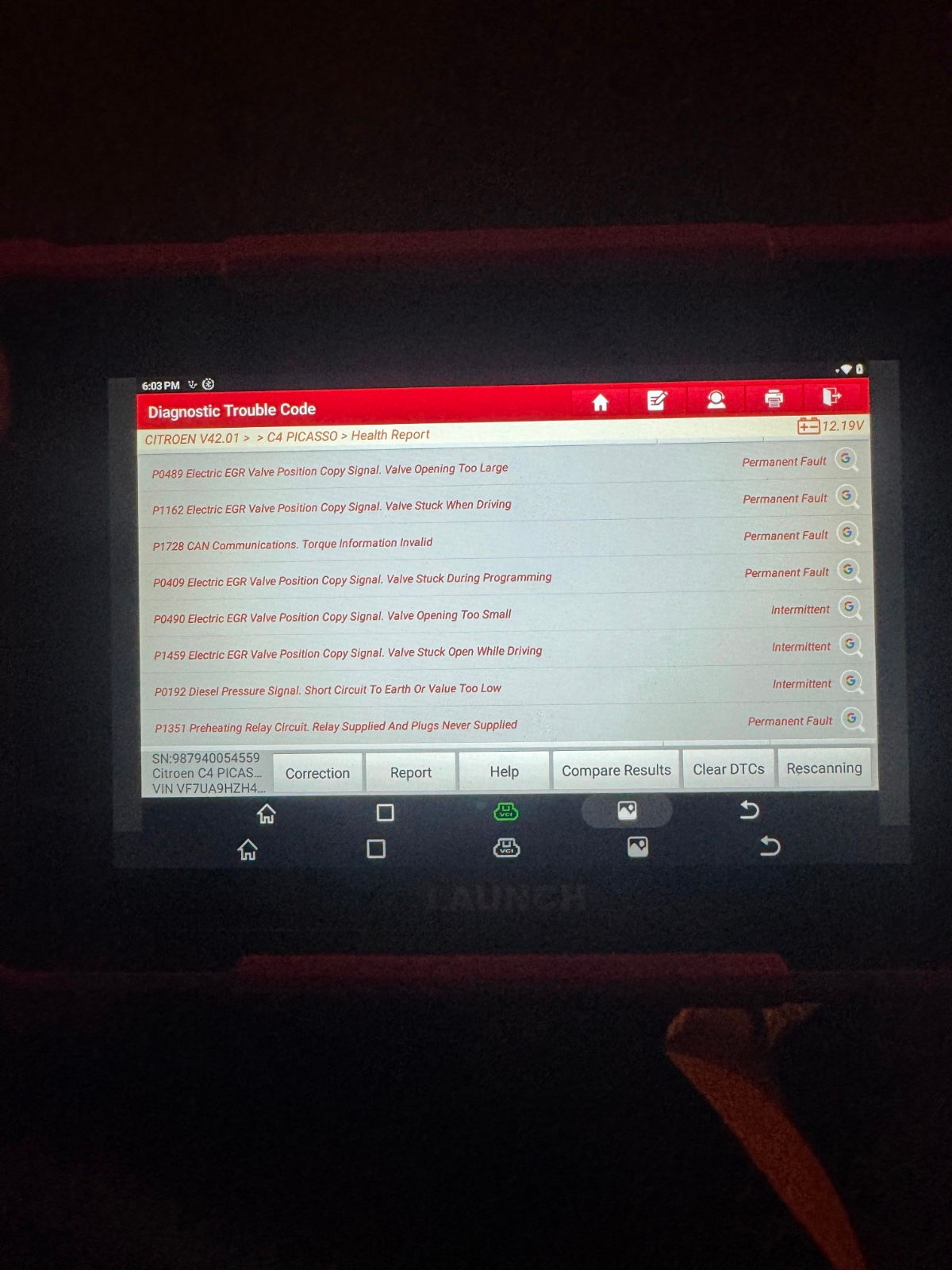

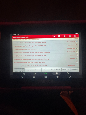

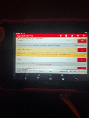

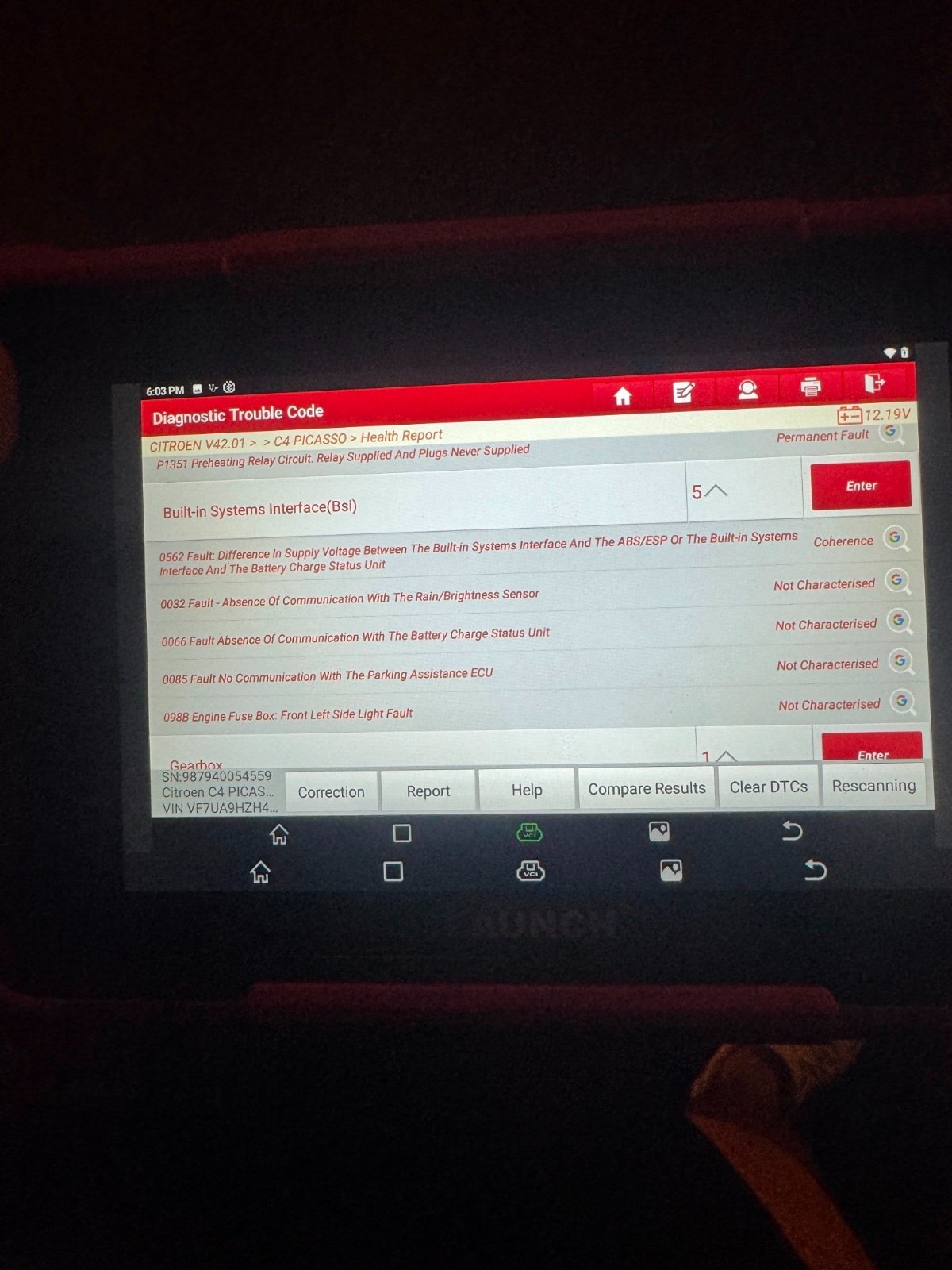

My car stopped on the way last, and after few minutes I was enable to start it again. After I connected diagn tool, I got a lot of errors with ecu/park brake/egr. I checked few forums/topics and is it EGR which need to be cleaned/changed?
C4 citroen 1.6hdi 2008

I would try running an EGR cleaner through the system, check the battery and charging, reset the BSI following this procedure, then run another global test and see what you get. :)

This car needs a good old fashioned de coke
