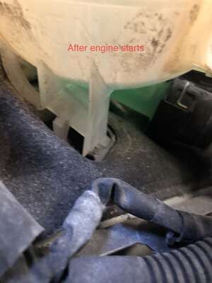

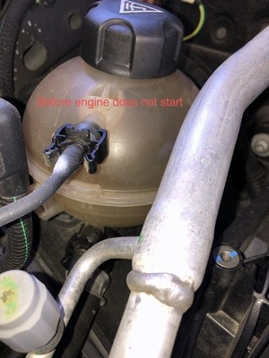

About 3–4 months after the coolant replacement, I noticed that the coolant level had dropped, and when I checked the expansion tank on a cold engine, the level was below the minimum mark—it even looked completely empty.
Despite that, the temperature gauge always stayed at 90°C, the AC system worked perfectly, and I didn’t experience any performance issues or warnings.
I contacted the DS service and brought the car in for inspection. When they opened the coolant cap, the level suddenly rose back up between the MIN and MAX marks. They explained that these cars operate under pressure, so this was supposedly normal and that I could continue driving like that.
