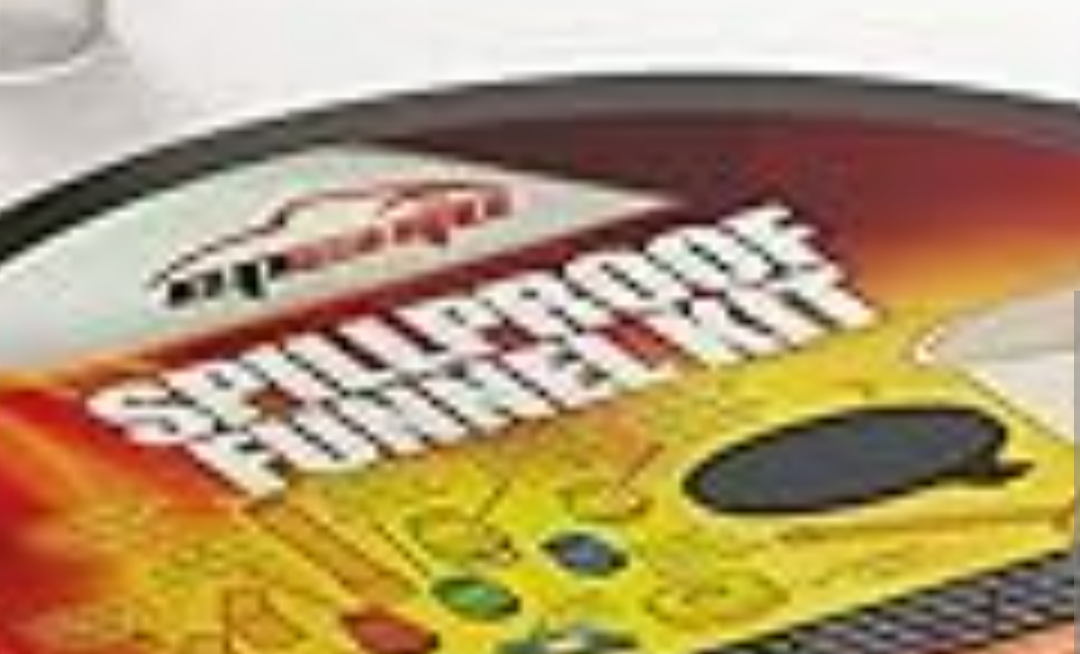

I did some more research last night and it seems that airlocks are a very common problem with this engine. I watched a fair number of videos and came to the conclusion that this device is my best bet when used in the bleeding process, it also has the advantage of fitting various other cars so will be generally useful I feel. Anyway it's on the way and due here later today.

Funnel kit looks a good gizmo, though anyone claiming
"spill proof" clearly hasn't seen me at work!
I do, really, honestly, try not to make a mess, but...........

Or meMattBLancs wrote: 29 Jan 2025, 13:45 Funnel kit looks a good gizmo, though anyone claiming
"spill proof" clearly hasn't seen me at work!![]()
Seriously, that funnel looks a seriously useful bit of kit...
- Posts: 6847
- x 3565
Re: DIY Car Maintenance with function over finesse!!
Like most things, you could do the job cheaper if you're resourceful - a coke bottle could be utilised for filling..... but the proper kit doesn't half make the job easier, slicker, and just better in the end. I've got the Sealey equivalent of that kit and have used it in the past - and it just works

I've used the bottle method in the past but you always end up pouring coolant everywhere when its time to lift the bottle off. The thing I like particularly about this kit is the stopper you insert through the coolant into the neck of the funnel when you are ready to take it off. Then you just pour the excess coolant back into its container!!

Yes the stopper is a good idea, though with a length of tube you can syphon back out of the bottle...

I set up the funnel which fits perfectly:
