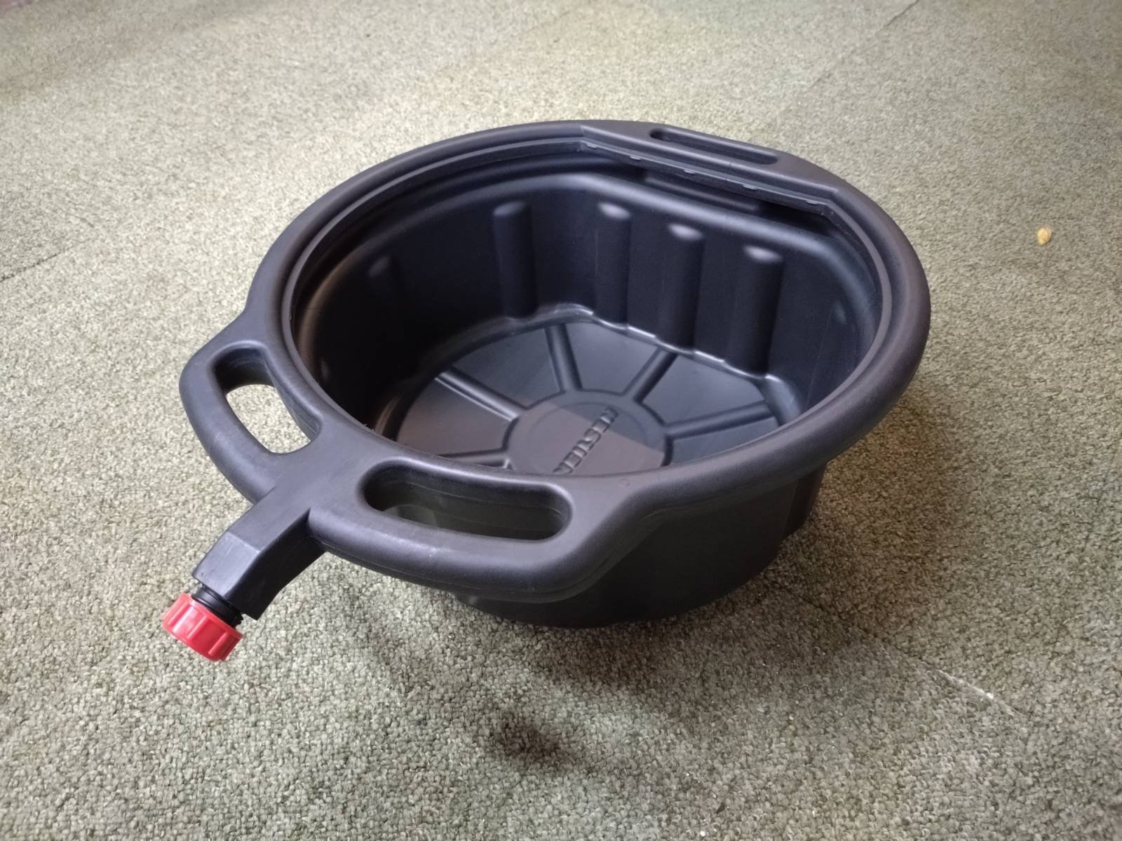

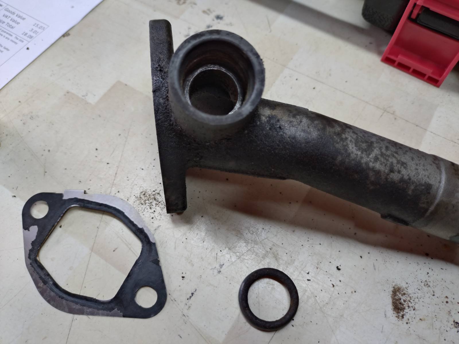

This morning I decided to try and resolve the coolant leak on the MX3 which has been getting worse!! So the first job was to remove the exhaust heat shield and the under engine cover, 11 x 10mm bolts in all no issues:
Next it was under the car and examine the bottom hose pipe connector:
Time to put my new drainage tray into service and drain the system:
Once drained I removed the hose connector and immediately saw that the 'O' ring had perished and was looking very sad. The gasket was fine and the housing just needed a clean:
So from there it was a simple matter to clean and reassemble the connector, then refill the cooling system and stand back to watch my newly assembled joint dripping profusely! Grrrrr!!
At that point my hands were too mucky to take any more pictures so after I took it all apart again, fitted two 'O' rings, reassembled and then bound the whole thing with self amalgamating tape, I refilled it and then with no leaks went through my cooling system bleeding process and called it done.

Oh gosh Mick, that was a bit of a game
Pleased it's all now sorted and happy again
It's good to see the drainer bowl spout has a cap on it... Wish mine had one to avoid drips from the spout when hung up...

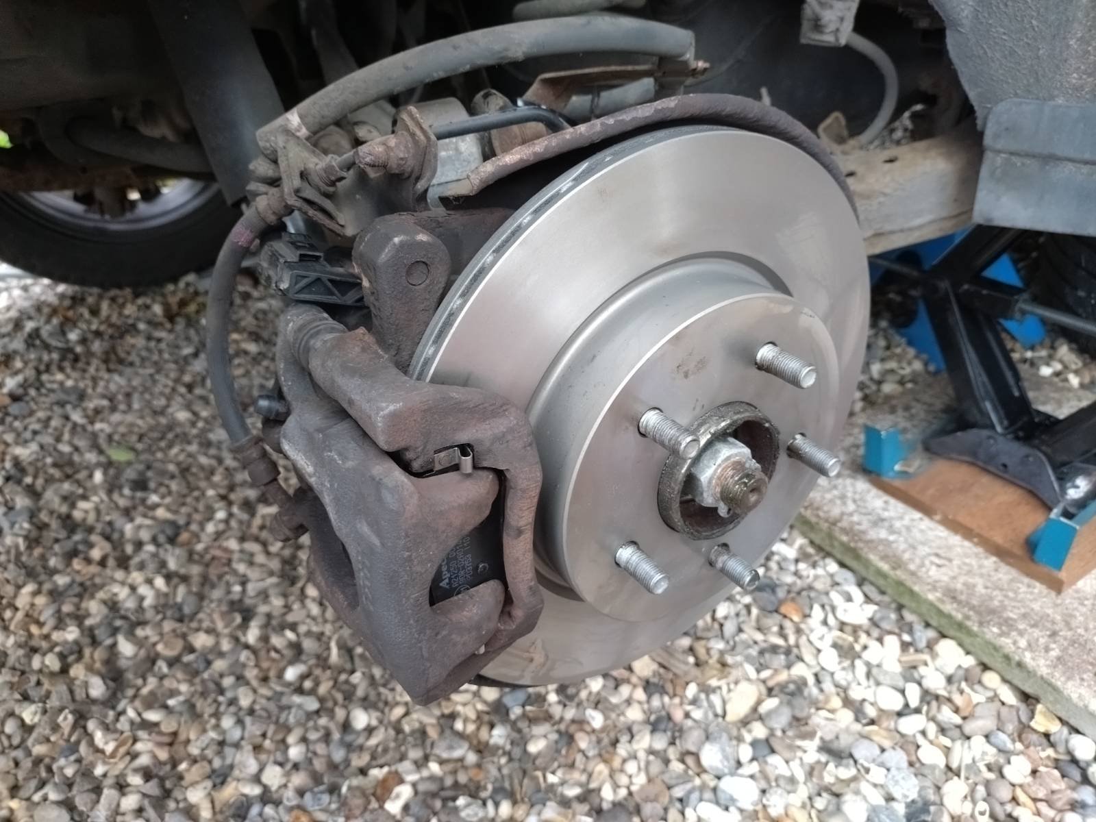

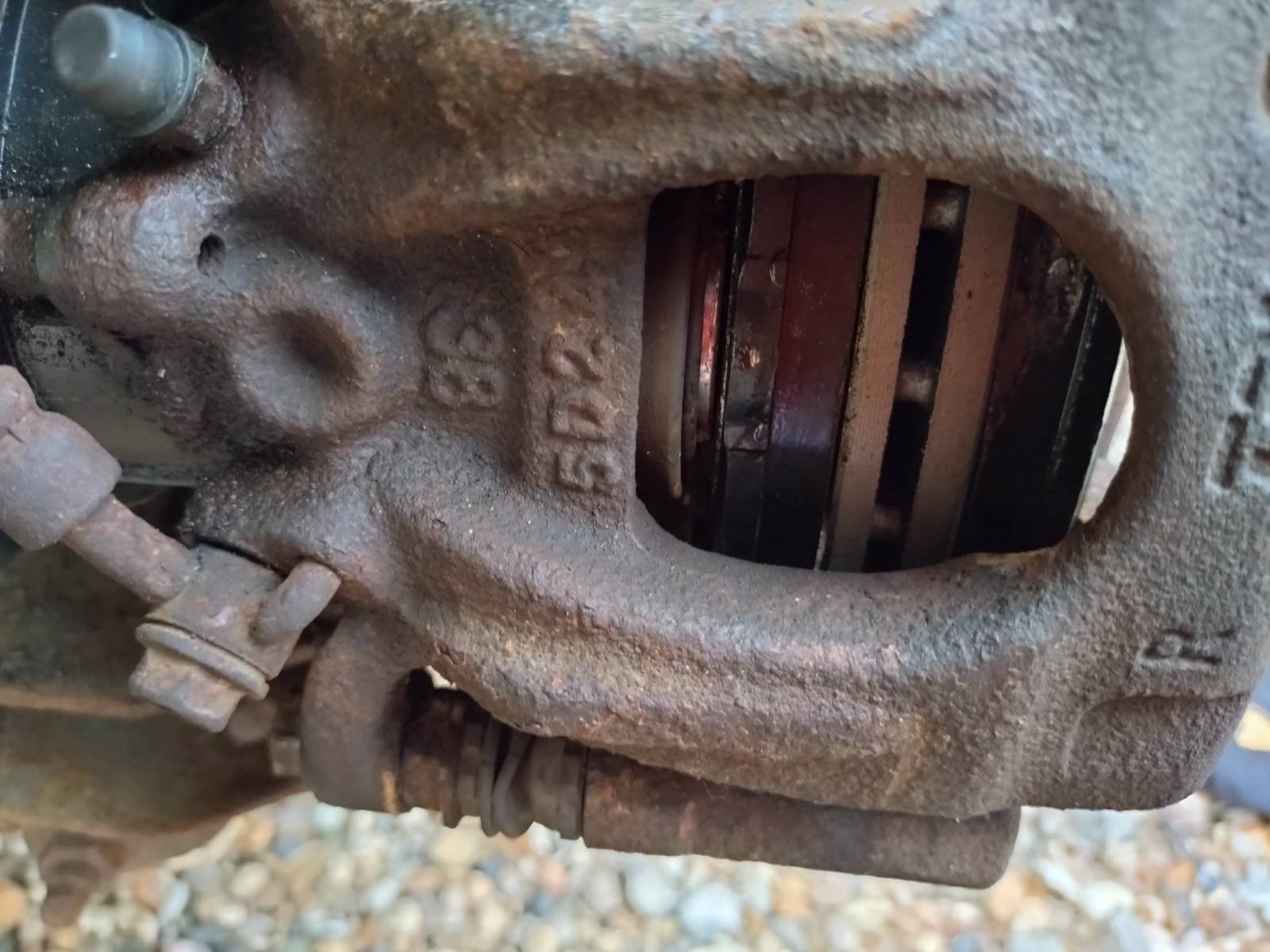

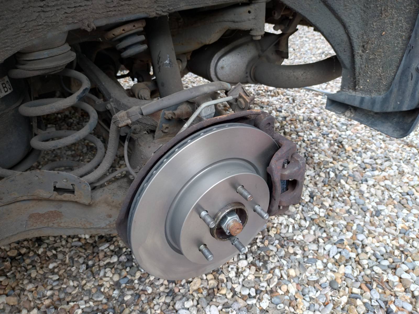

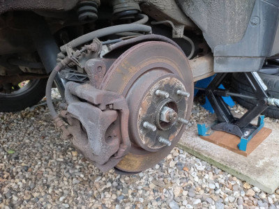

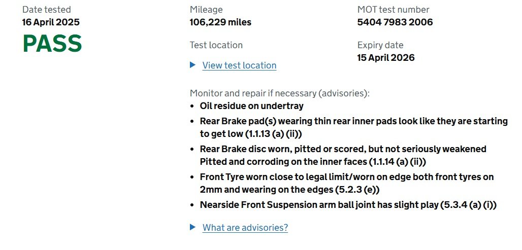

My friend in Elstree has been trying to sell her Nissan X-Trail for some time with no success so she asked for my help. It was MOT'd earlier this year and passed with advisories for rear brakes, nearside front ball joint and minor engine oil leak.
As any prospective buyer has access to the MOT history I felt that the advisories may well be putting people off as the ad has had 89 views and only one enquiry. That enquiry wanted at least £750 off because of the issues on the MOT so we decided to lash out £280 to get all the parts and sort them all.

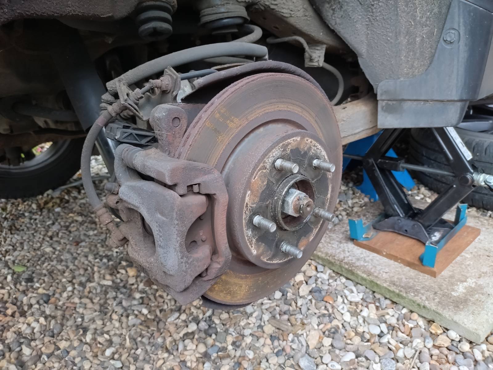

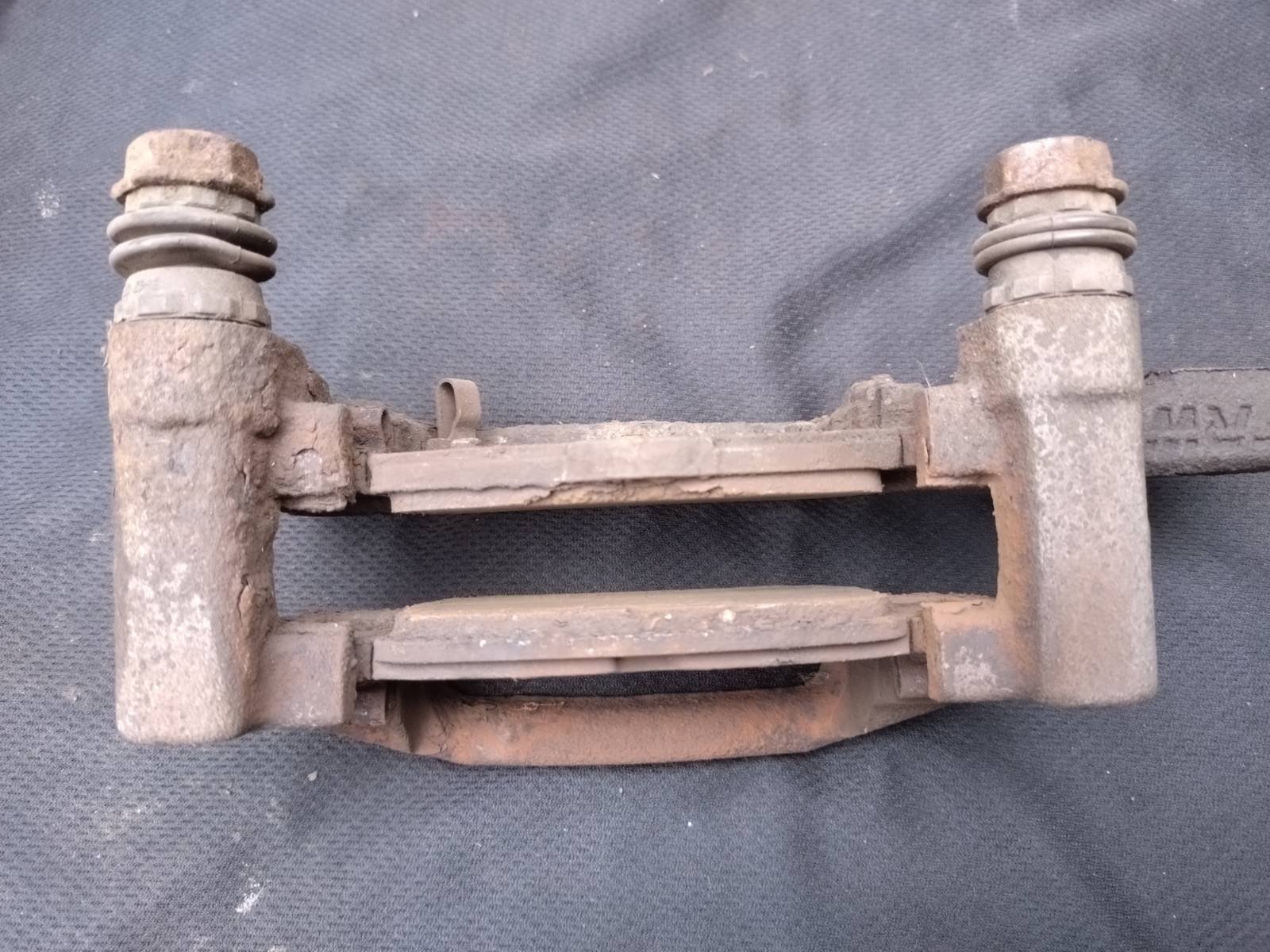

So yesterday I started to prepare it for a new attempt to sell it by replacing the rear discs and pads. It turned out to be a pain because the caliper pistons have to be wound back, not just pressed. They have three notches at 120 degree intervals around the perimeter to fit the tool into. Unfortunately my tool only has 2 peg adapters so it was a messy job involving keeping pressure on the piston while tapping it round a few mil at a time. It took almost 30 mins each to get them back.
So here are the pics:
I then added some of the above pics to the ad to see if that gives potential buyers confidence. You can see the revised ad here: https://www.ebay.co.uk/itm/326767785906
Now waiting for the control arm to arrive and then I'll get the front up, send the wheels for new tyres, replace the control arm and investigate the oil residue, which I have a feeling is the result of spillage from the last oil filter change!!

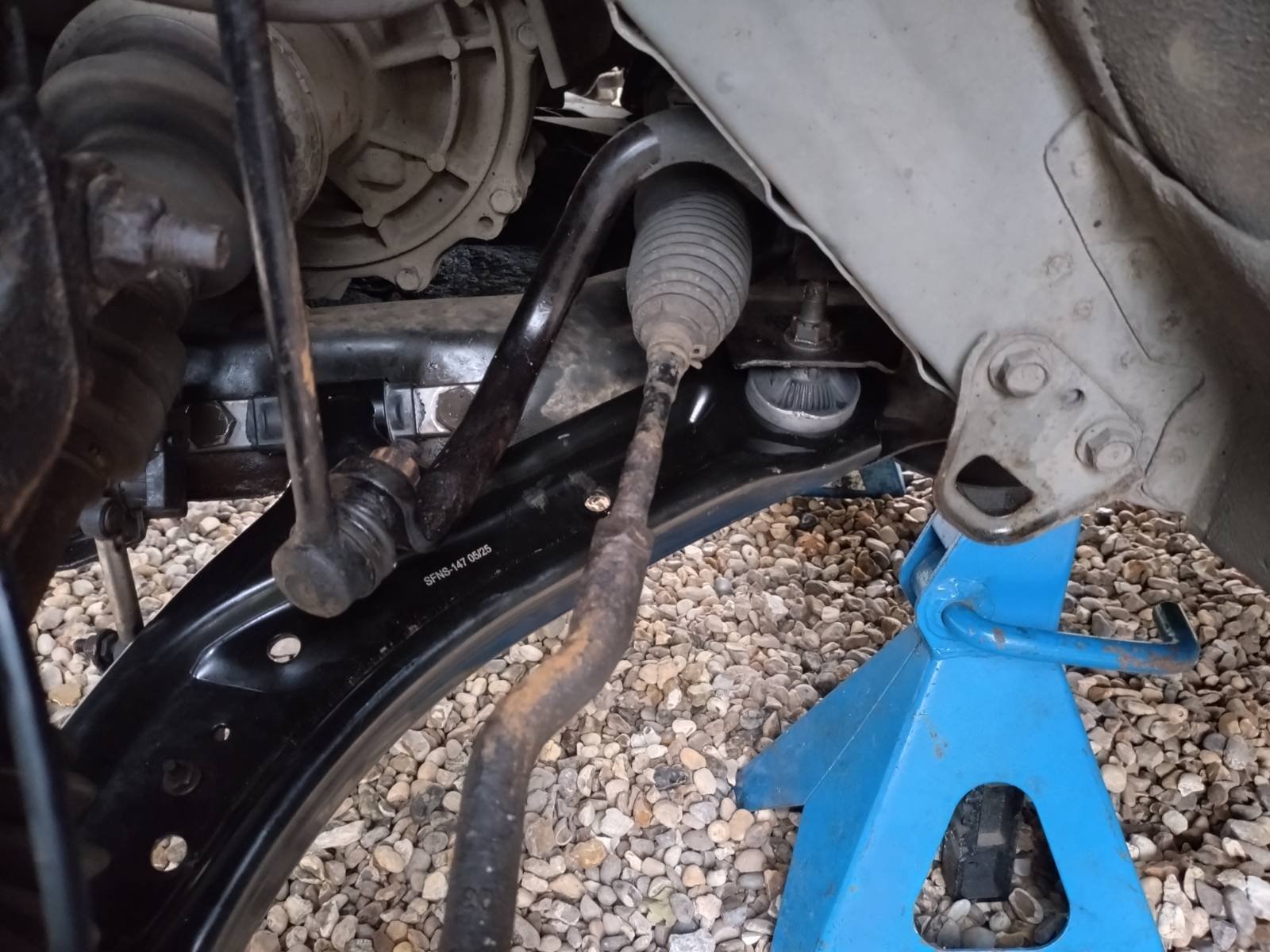

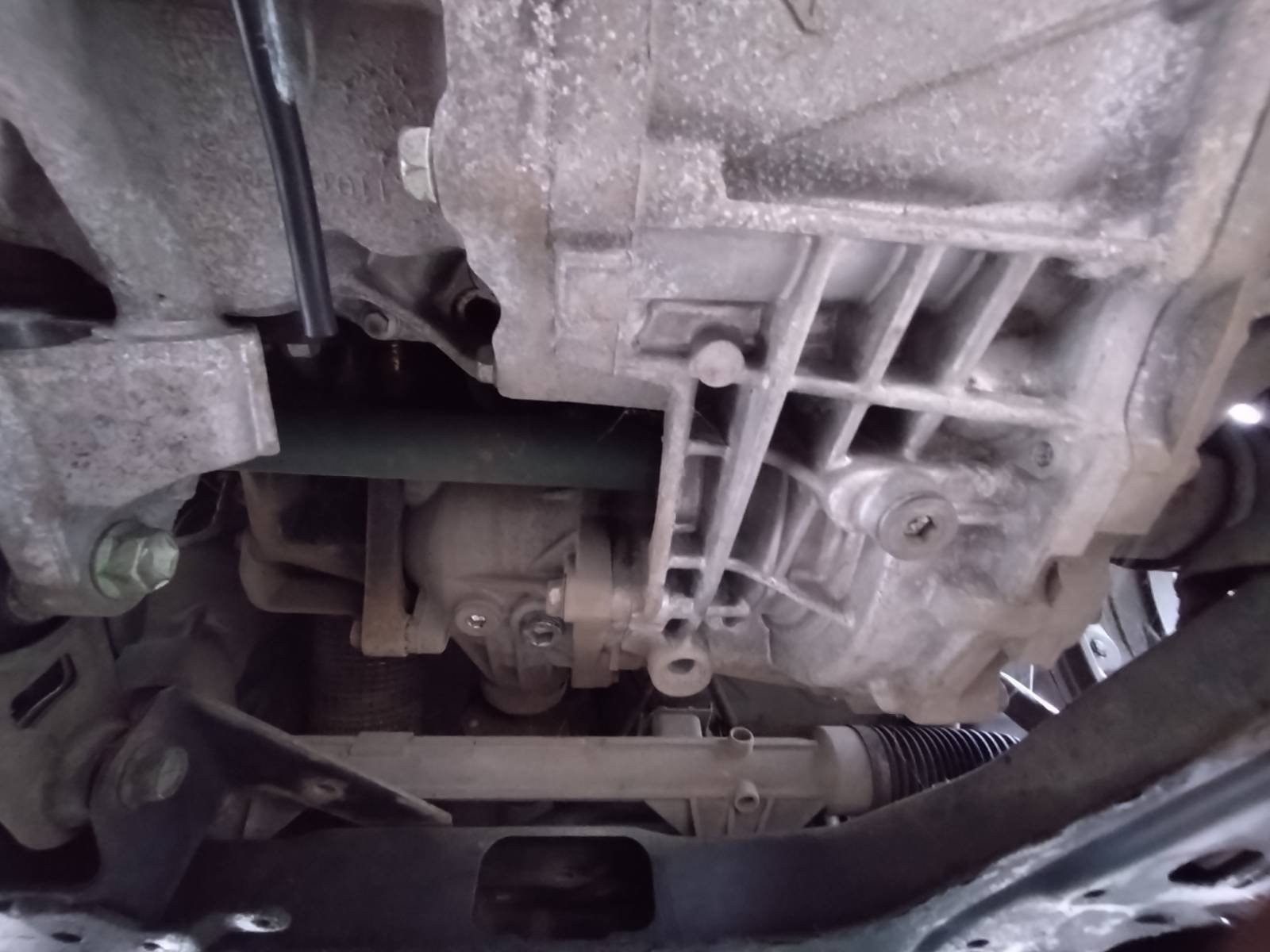

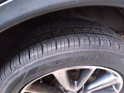

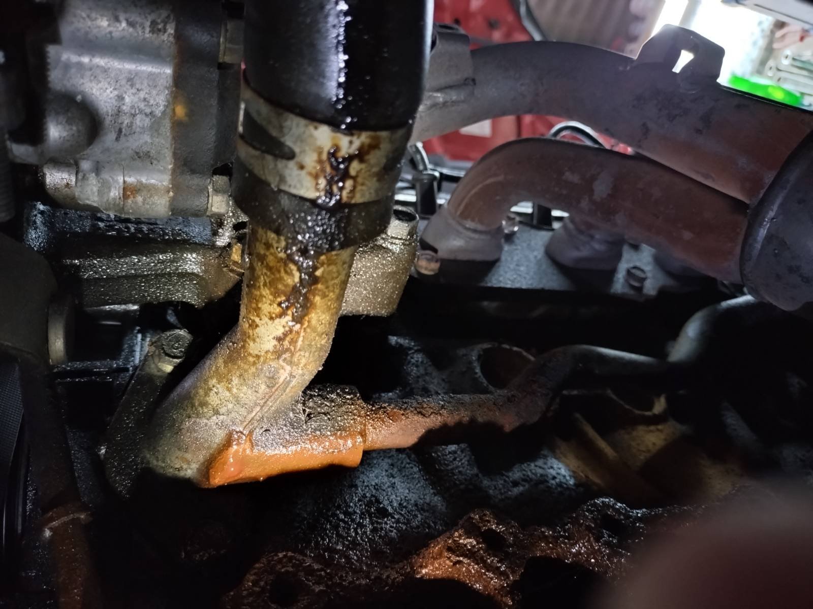

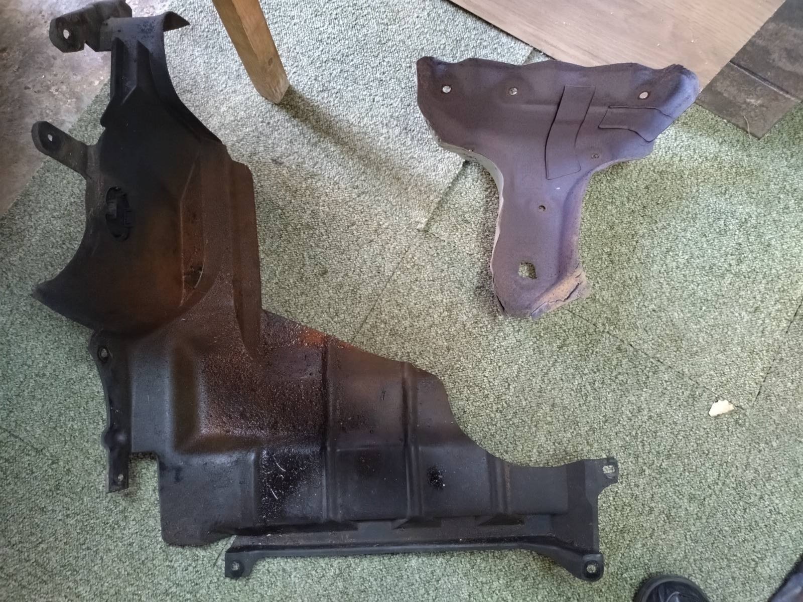

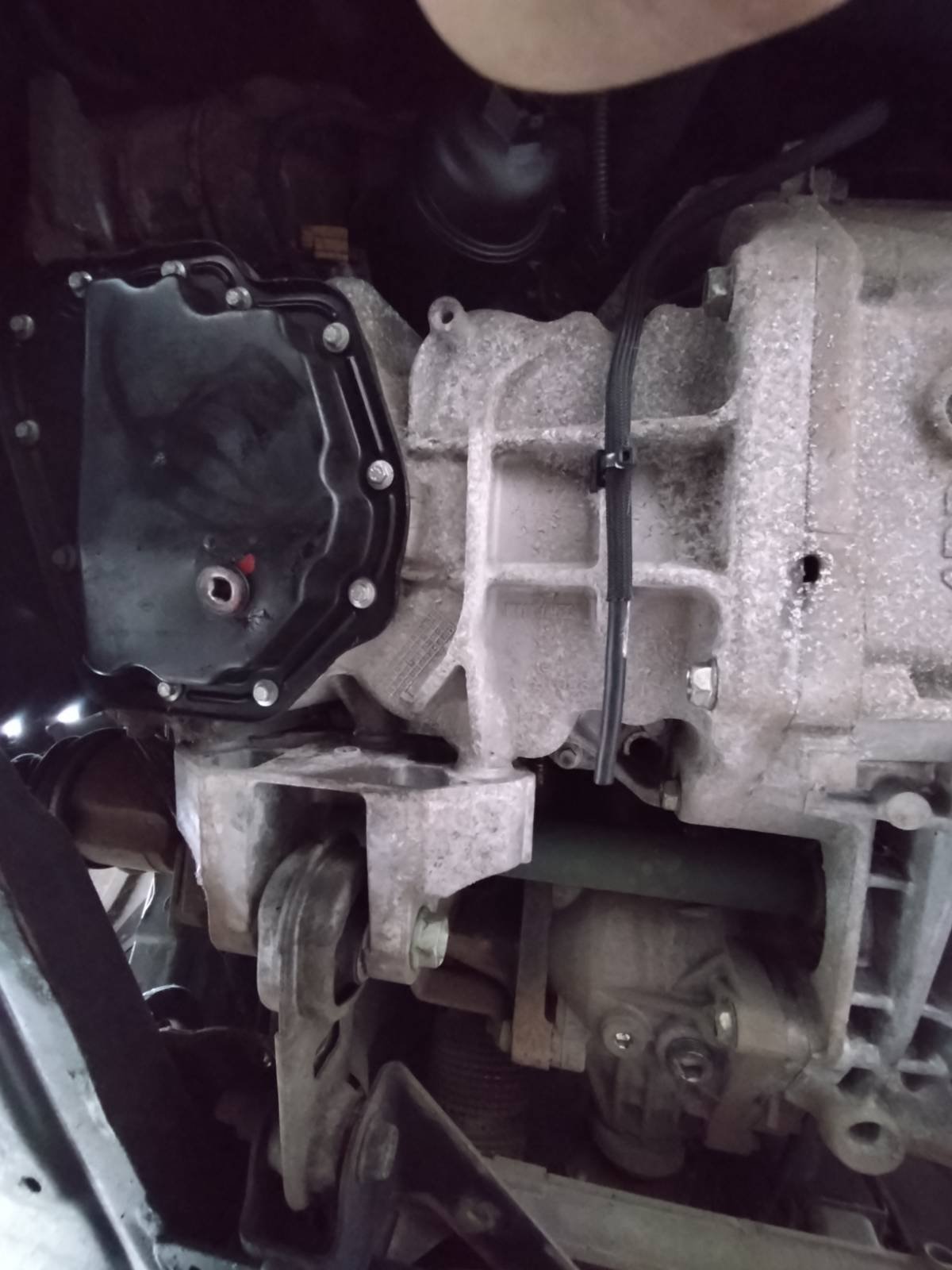

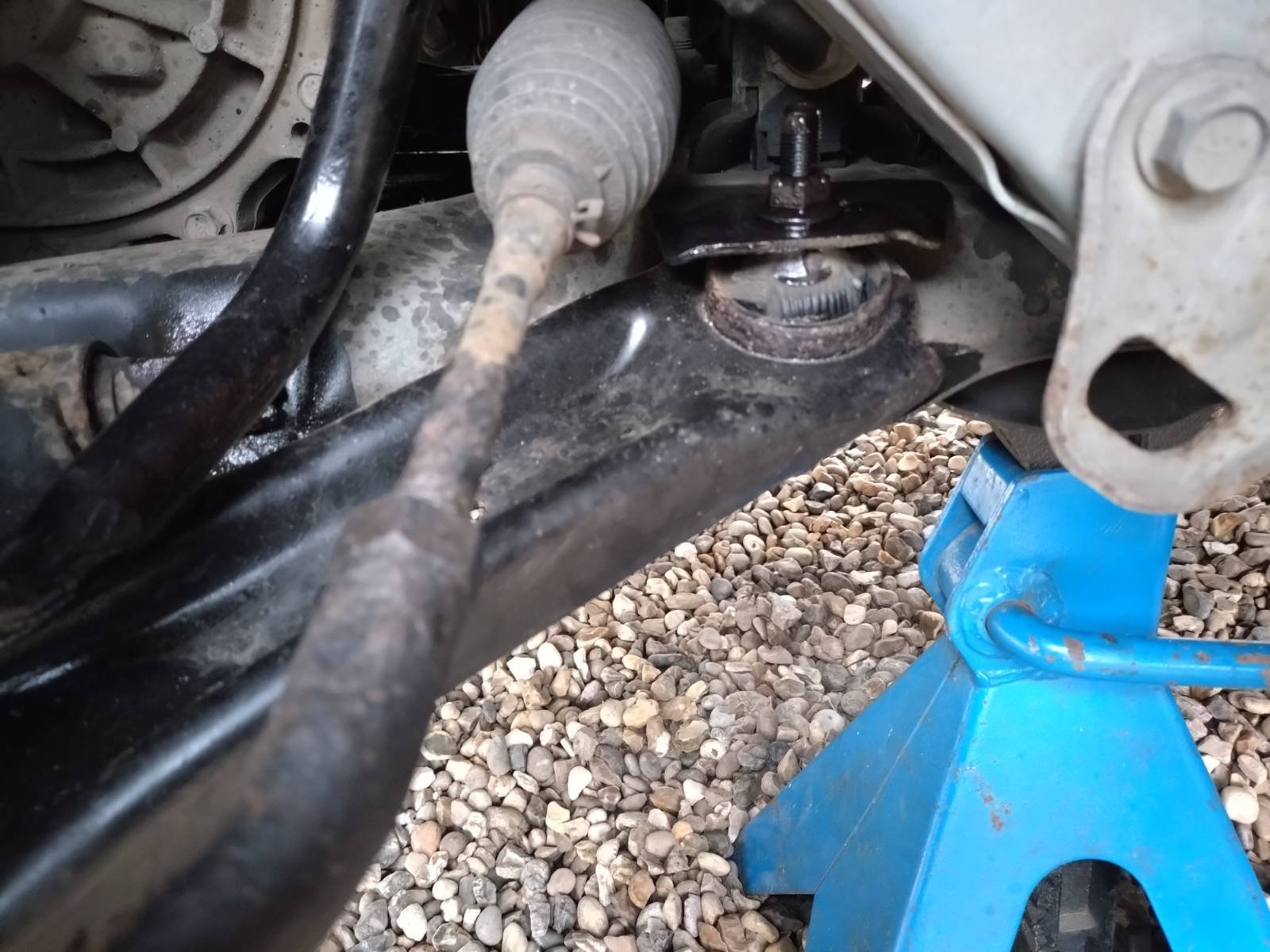

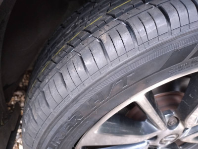

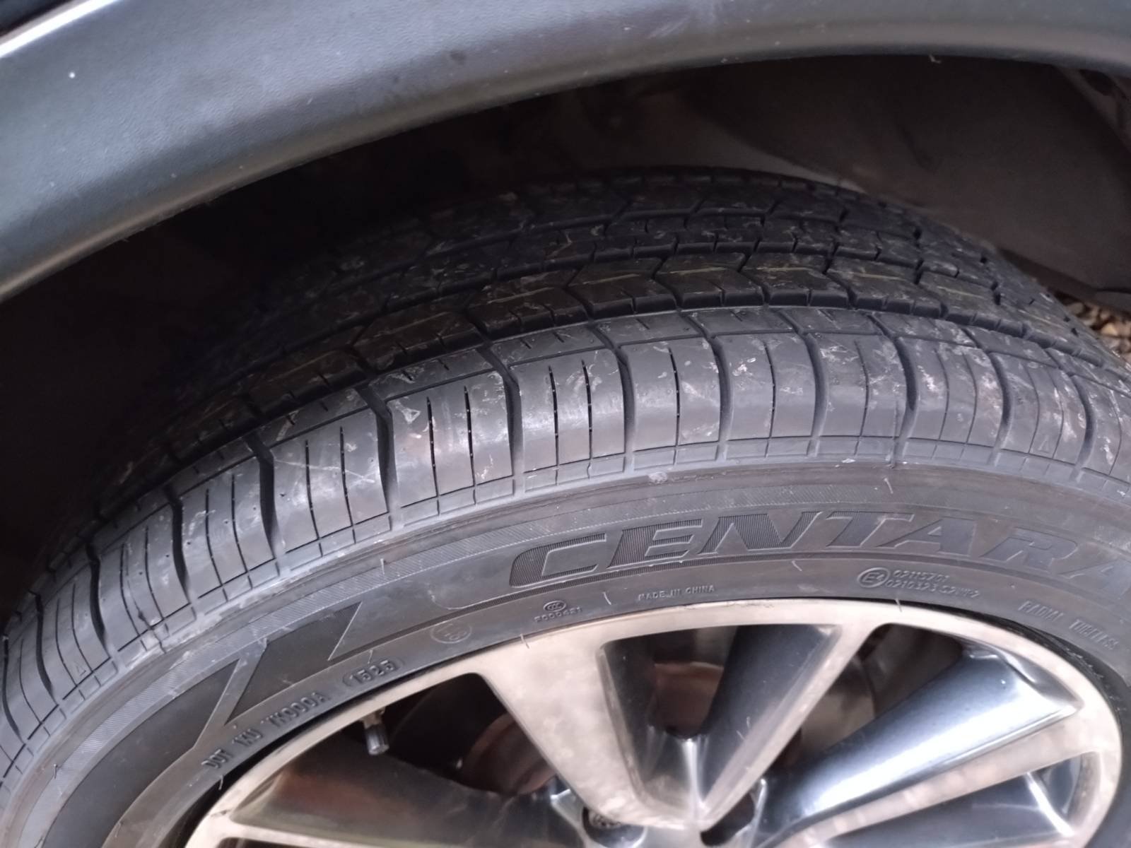

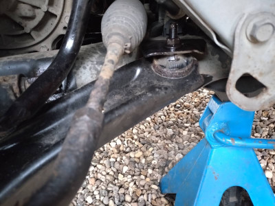

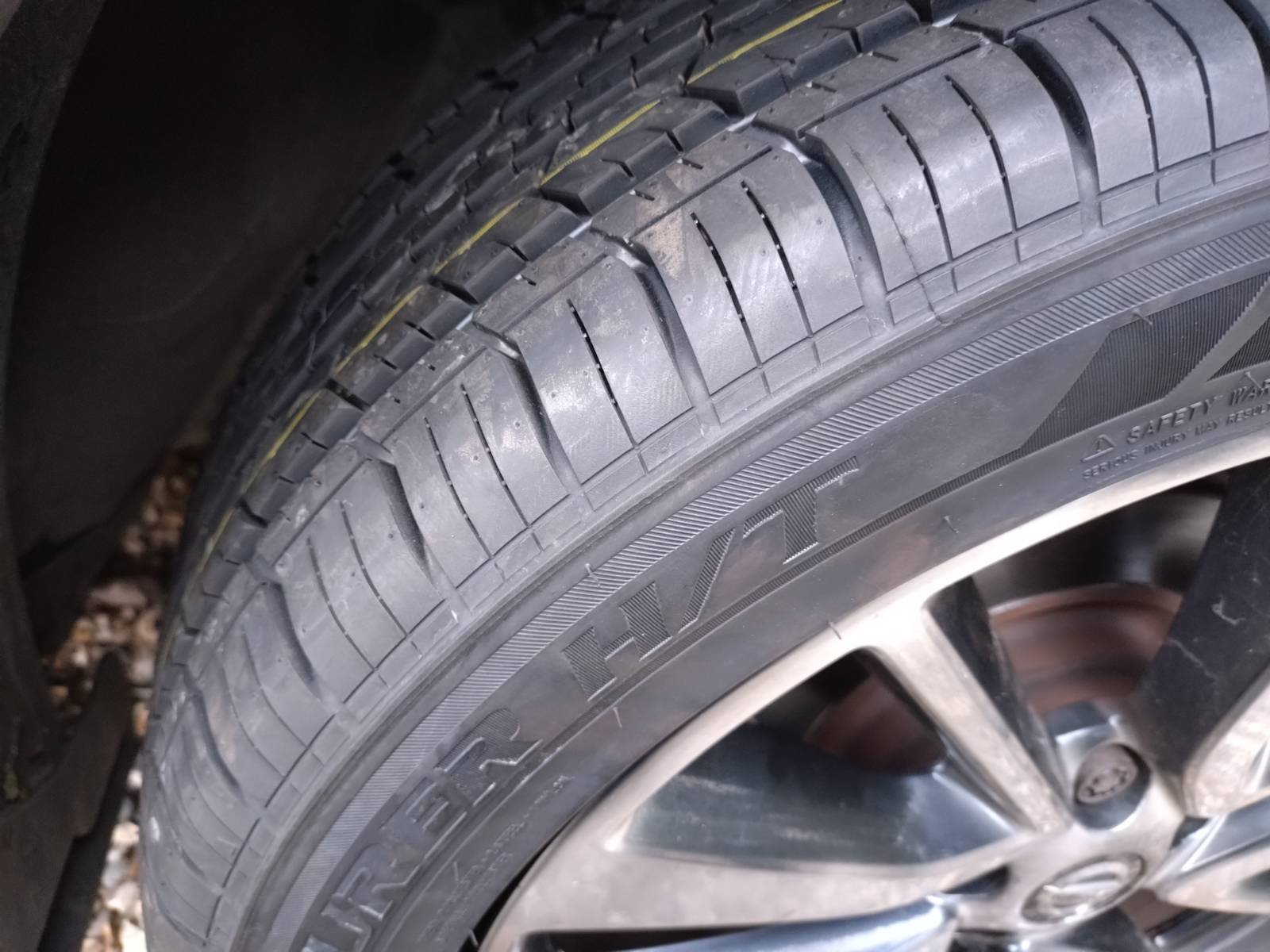

Back to Elstree to finish the work on the X-Trail today. I jacked up the front to remove both wheels and disconnect both drop links. That allows moving the antiroll bar away from the control arm mounting to give access to the bolts. Then out with the impact gun and remove the two bracket bolts, the back bush bolt and the balljoint clampbolt. On this arm I also had to remove the leveling sensor and then tap out the arm. New one installed with a bit of jack help amd everything back together.
Meawhile the wheels had been taken for a pair of new tyres to be fitted which went back on. Lastly I had to remove the engine undercover to investigate the 'oil residue' advisory on the MOT.
I suspected the residue was the result of a mishap when removing the oil filter at the last service and so it proved to be. Both engine and gearbox were clean undeneath so just cleaned the undertray and refitted it:
So relisted with all MOT advisories taken care of and now just need a buyer!!
