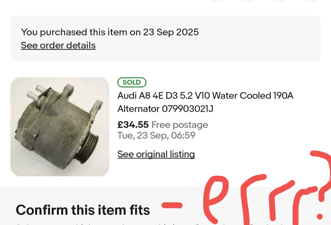

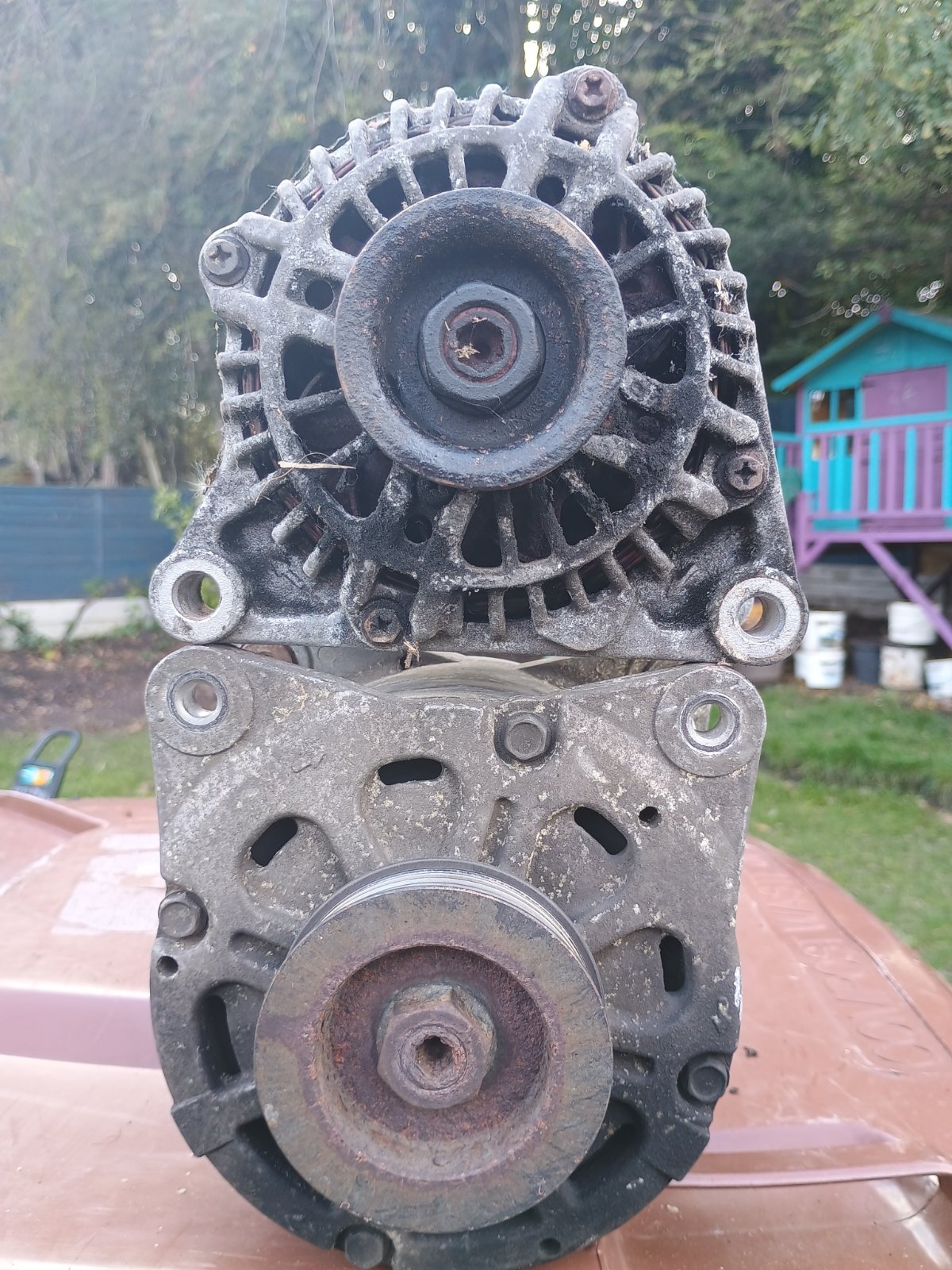

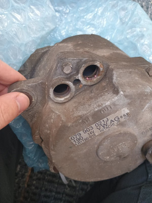

Initial look at my silly purchase. Quick comparison against the EW10J4 alternator (made by Mitsubishi) that's sat in the garage awaiting its eventual return to the 406 Coupe.
On the water cooled (made by Hitachi) alternator:
Mounting points use M8 rather than M10.
Along the axis of the mounting bolts, the lugs appear to be same distance between alternators.
Interestingly, between pairs of fixings, they are a fair distance further apart 10-15mm, will measure it when I get chance. Drive pulley is obviously a larger diameter (presumably to suit a high revving V10 Vs 4 cylinder??)
But also of note it's a 5 groove "5PK" pulley, not the 6PK of the EW10J4 alternator.
Centre nut is same size, so a pulley swap seems feasible.
Offset of pulley Vs mounting lugs looks about the same but will measure to confirm.
Both EW10J4 (year 2000) and the HDi Coupe DW12 (year 2002) are both standard rather than "smart" alternators (the Audi / Hitachi one is smart)

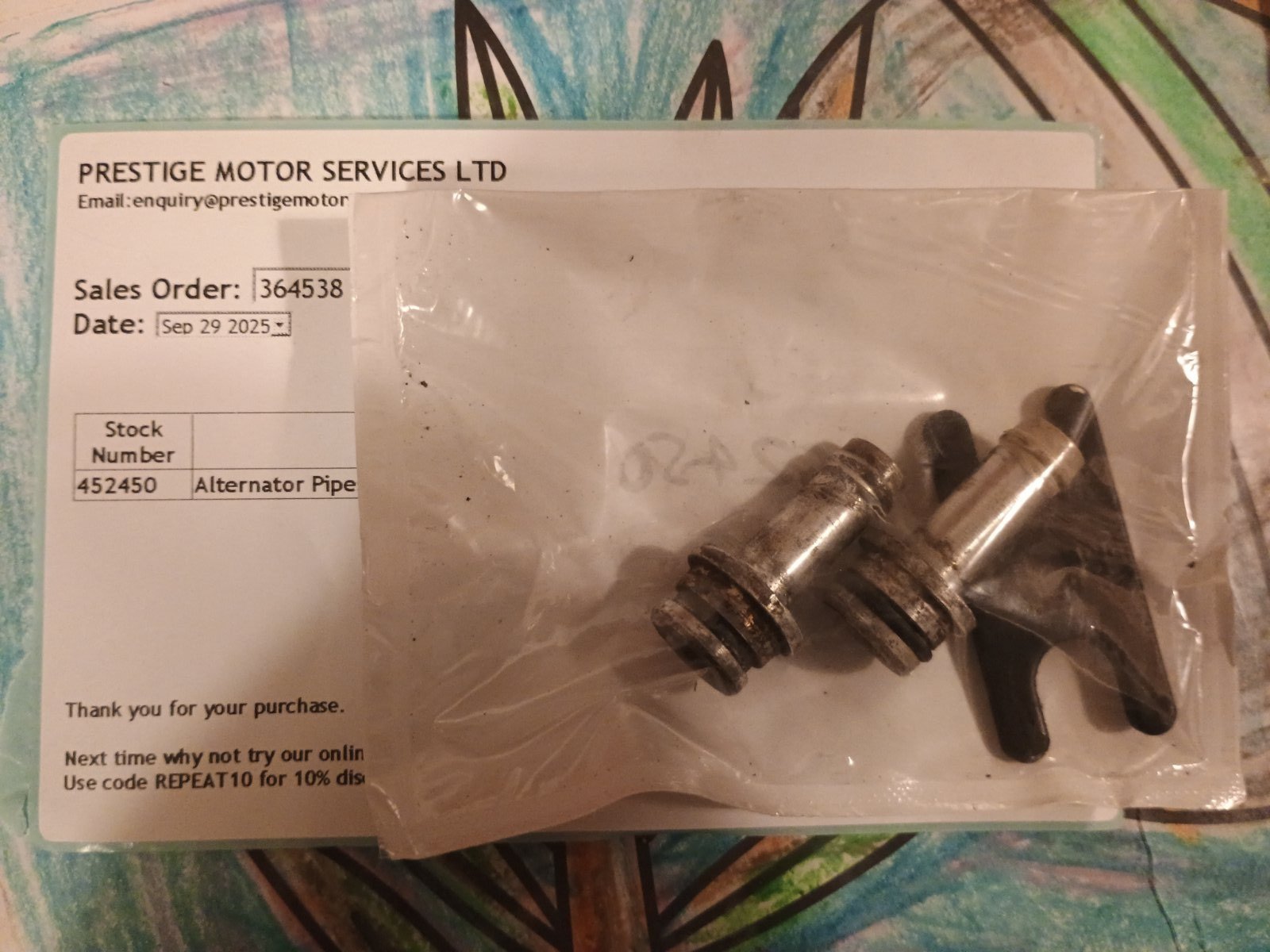

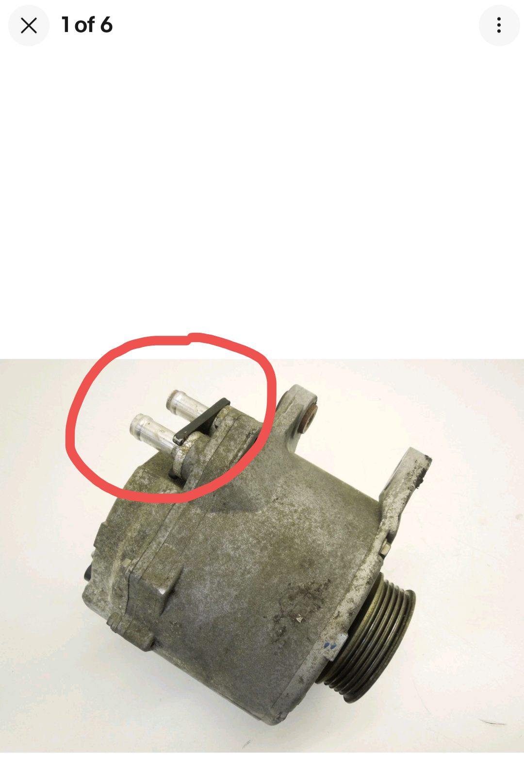

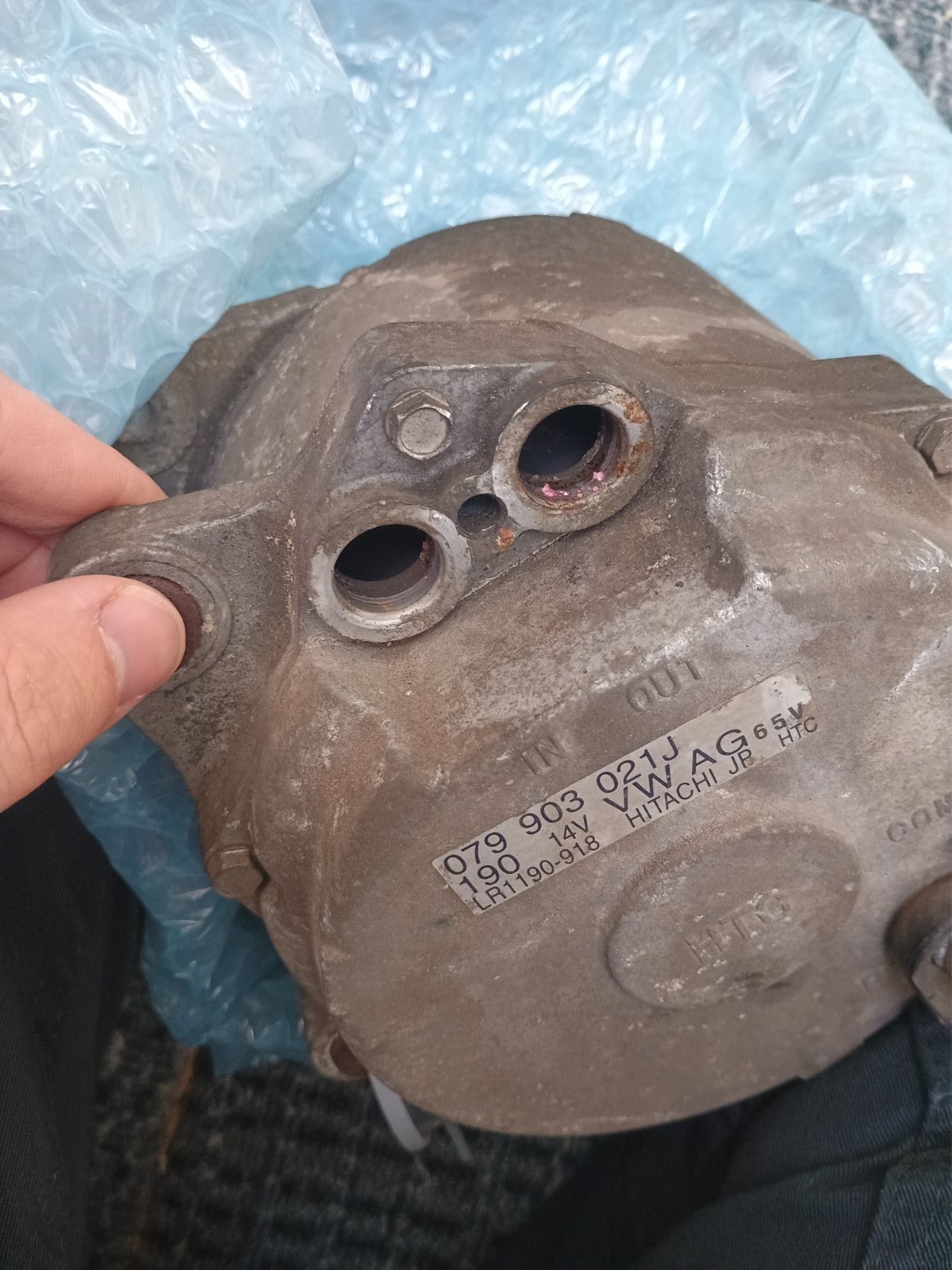

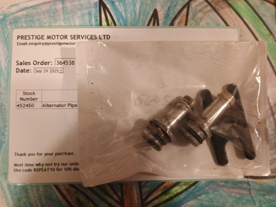

Spot the difference between listing photo and what arrived:
A message to the seller, apology and very swift in the post, today arrived:
Great service!
Great service!

That is good service for the bay Matt must be your lucky week!!

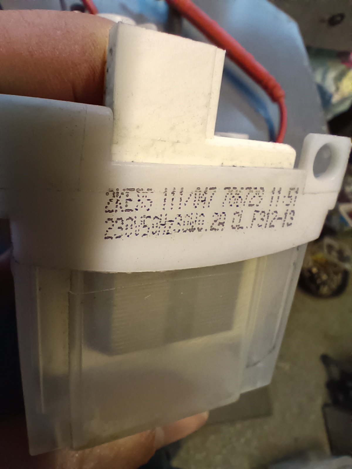

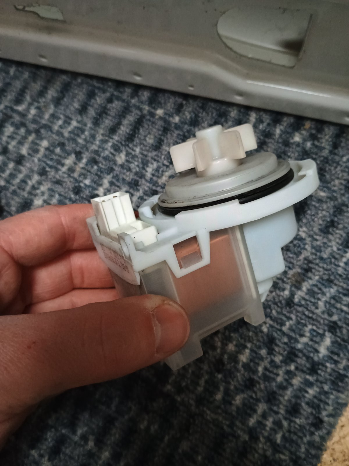

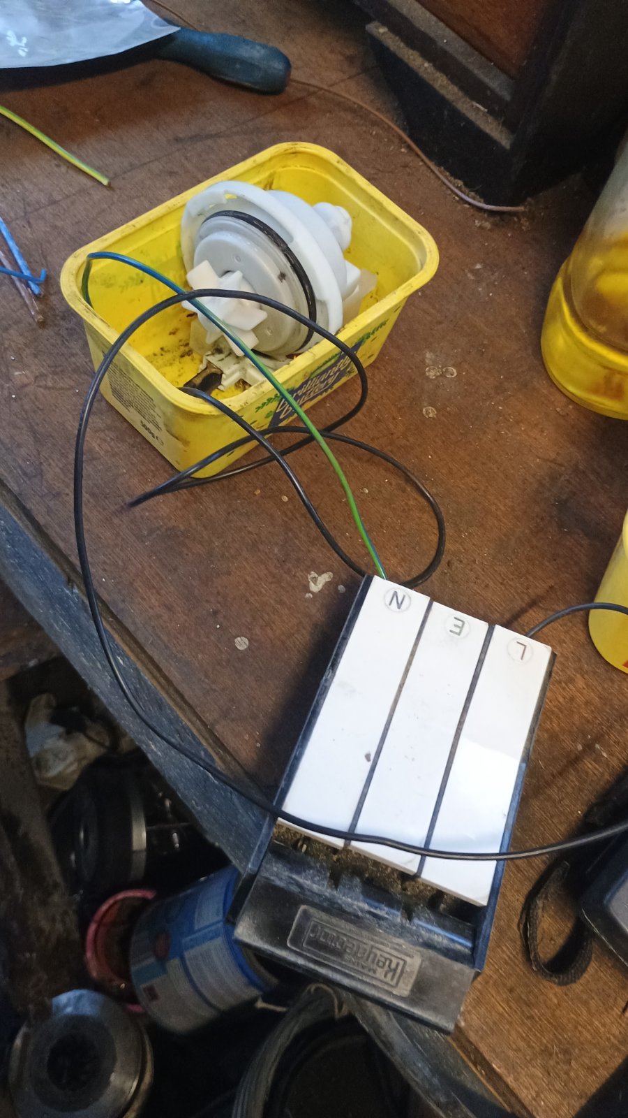

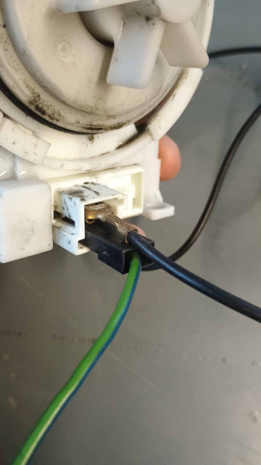

Not really "Picture of the day" worthy, but yesterday revolved around this:

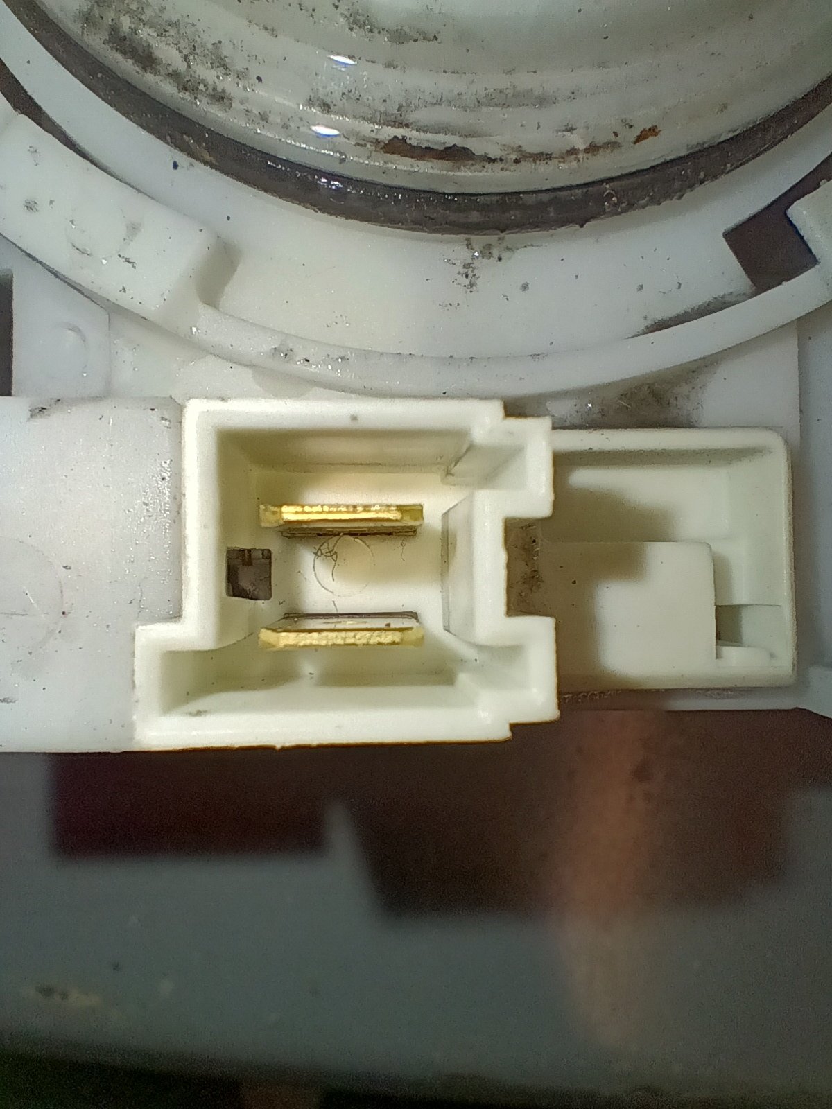

Which was then tested:
Also multimeter across terminals = open circuit.
£26 for a new one.

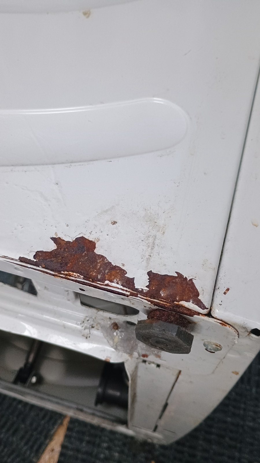

Washer itself is going to need a spot of "bodywork" as seemingly is rusty in places not seen usually!

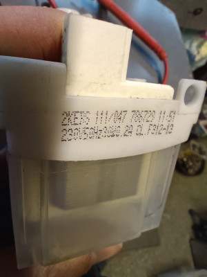

£26 for a new one.

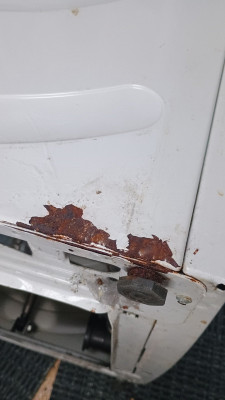

"Not really "Picture of the day" worthy, but yesterday revolved around this:"
Not wishing to pump you for more details but it would seem that it didn't revolve at all, hence the problem?
