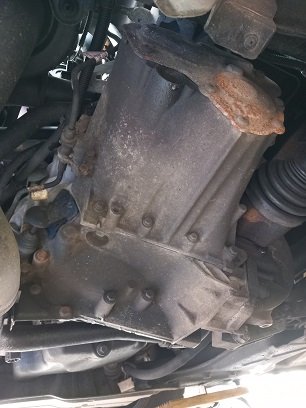

I have a 2014 (2013 manufacture) Boxer 2.2 130 with a manual 6 speed box. I wish to change gearbox oil to see if it improves slightly notchy gear changes when on sustained long hot runs (no notchiness when cold or normal driving) in case there is water ingress.
Trouble is there seems to be a lot of conflicting info on refill quantity depending on type of box.
My gearbox has the almost flat steel end cover, is it an MLUC or a MGLU they have different quantities for each? and which oil, is Total Traxium Gear 8 GL4 PSA B71 2330 correct
I also found the stampings on the gearbox:
20GP15
0489232
2.91
Got the attaching photo sorted with help from forum admin team, thanks.
Any help appreciated
Billy

Hi, I have a 2019 boxer VF3**************[VIN obfuscated, can be read by forum staff] , can you help please, I want to change the gear box oil and i don't know how much oil goes in ?
- Posts: 9344
- x 1942
Re: Peugeot Boxer gearbox capacity
This information from viewtopic.php?p=790637#p790637
ML6C Gearbox with fins will look like this:
And without fins like in beelag's post above.
The correct oil is 75/80 and must be GL4 spec, not GL5.
| ML6C | Gearbox casing without fins | Gearbox casing with fins |
| Drain and refill | 2,6 litres | 1,9 litres |
| After overhaul | 2,8 litres | 2,2 litres |
