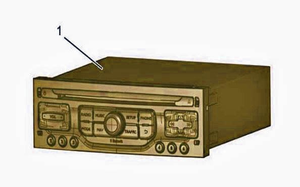

RT6 Head Unit, Role, Connections & Pin Out
This is the RT6 Unit, showing Functions and Rear Connectors with Pin Outs.
Role
Main functions:
To receive audible radio broadcast transmissions in amplitude and frequency modulation (AM and FM)
To receive digital audio broadcasting transmissions (DAB: Digital Audio Broadcasting, T-DMB)
To present the list of stations available
To play compact discs (format M4A, M4B, AAC, FLAC, OGG, MP3) via the integral CD player (mono-CD)
To improve the sound quality with "Sound Staging ARKAMYS"
To manage 4 stereophonic audio outputs
To be operated by the controls on the steering wheel
To display information on the remote multifunction display
To read a storage peripheral via the auxiliary socket (*)
To read a storage peripheral via the USB socket (*)
To control the stereophonic audio outputs, superimposed over an audio source (if necessary), for the parking assistance function
To adapt the volume to the vehicle speed
To operate the hands-free kit via Bluetooth (With a telematic unit) (*)
To carry out diagnostics of its own operation and of that of its peripheral devices
To give protection by way of the vehicle’s VIN code

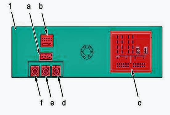

Rear of RT6 Unit
Key
(1) Audio system RT6.
"a" USB socket connector (4 way black connector).
"b" LVDS cable connector (10 way black connector).
"c" 40-way black connector.
"d" Aerial GPS (blue) (*).
"e" Aerial AM/FM1 (white) (*).
"f" Aerial FM2 (grey) (*).
Note (*) According to version.

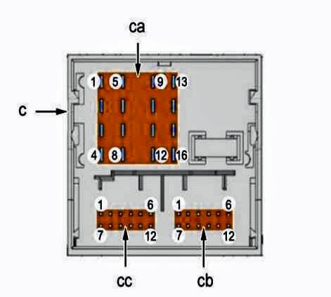

"c" 40-way black connector:
"ca" 16-way black connector
"cb" 12-way black connector
"cc" Natural 12-way connector
"ca" 16-way black connector (Without HiFi option)
Channel numberAllocation of channels of connector
1Rear right speaker positive control
2Front right speaker positive control
3Front left speaker positive control
4Rear left speaker positive control
5Rear right speaker negative control
6Front right speaker negative control
7Front left speaker negative control
8Rear left speaker negative control
9Colour screen power supply
10Comfort CAN High
11Channel not connected
12Battery +
13Comfort CAN Low
14Channel not connected
15Colour screen earth
16Earth
"ca" 16-way black connector (With HIFI option)
2Positive control of the front RH output amplifier
3Positive control of the front LH output amplifier
5Channel not connected
6Negative control of the front RH output amplifier
7Negative control of the front LH output amplifier
8Channel not connected
10Comfort CAN High
12Service battery positive
13Comfort CAN Low
16Earth
"cb" 12-way black connector (Only with CD changer)
1CD changer earth (*)
2Comfort CAN Low : CD player(*)
3Permanent supply : CD player (*)
4Right audio system : CD player (*)
6Comfort CAN High : Remote control (*)
7Comfort CAN High : CD player(*)
8Audio earth : CD player (*)
9Sound cut-off control (MUTE) (*)
10Left audio system : CD player (*)
11Comfort CAN Low : Remote control (*)
12Channel not connected
1 (*)Video positive input 1
3Microphone negative input
4RH audio signal auxiliary positive input
5LIN bus for screen DG4
6 (*)Video positive input 2
7 (*)Video negative input 1
9Microphone positive input
10LH audio signal auxiliary positive input
11Audio signal auxiliary negative input
12 (*)Video negative input 2

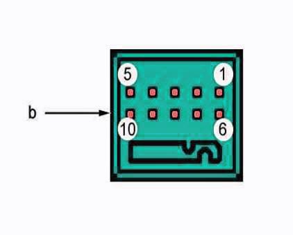

"b" 10-way black connector
1Clock LVDS CLK1 +
2Clock LVDS CLK1 -
3Earth
4Channel LVDS A0 +
5Channel LVDS A0 -
6Channel LVDS A2 +
7Channel LVDS A2 -
8Earth
9Channel LVDS A1 +
10Channel LVDS A1 -
