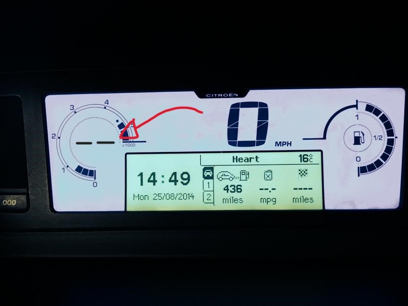

Hi everybone, im new in this forum to see if someone can help me with my problem.
I have a Citroen Picasso C4 that starts normally and wouldn't display the gears on the screen (it's automatic). It only shows two lines.
I replaced the gearbox, the selector sensors, and the selector lever, but nothing.
The main relay was also replaced, and all the fuses were tested.
I don't know if anyone could help, i have this for six months.
Thanks in advance.

Re: BIG PROBLEM WITH CITROEN C4
Hello thanx for reply Mickthemaverick!!
Well , I forgot to take a photo.
But I found one on Google of a manual C4, and I edited it to show the problem.
