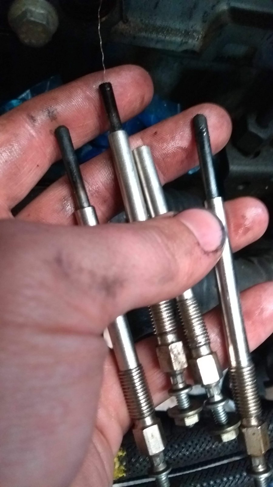

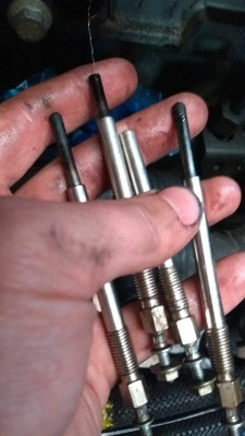

I'll stick to penetrating oil then. But wouldn't that piece of tungsten sticking out be a good thing if I can grip on to it with some pliers? The whole glow plug body is already out so either I'll pull the whole tip out (hopefully) or just the tungsten bit. One way I'm really glad the thread itself came out clean, drilling that out would be a huge pain in the butt.
Here's a picture of this glow plug:

Took some measurements and the other plug electrode (the one that snapped off completely) has moved about 27mm up, so maybe turning the engine and letting it shoot out isn't that unreasonable...
As for the other one, currently letting it soak penetrating oil, going to use some heat and pray it will move, a 2kW hair dryer is the best I got besides a blow torch.
