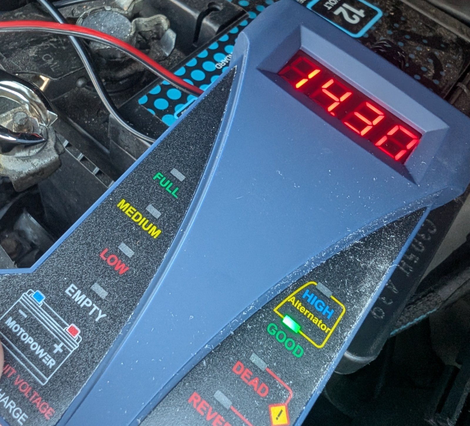

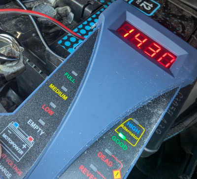

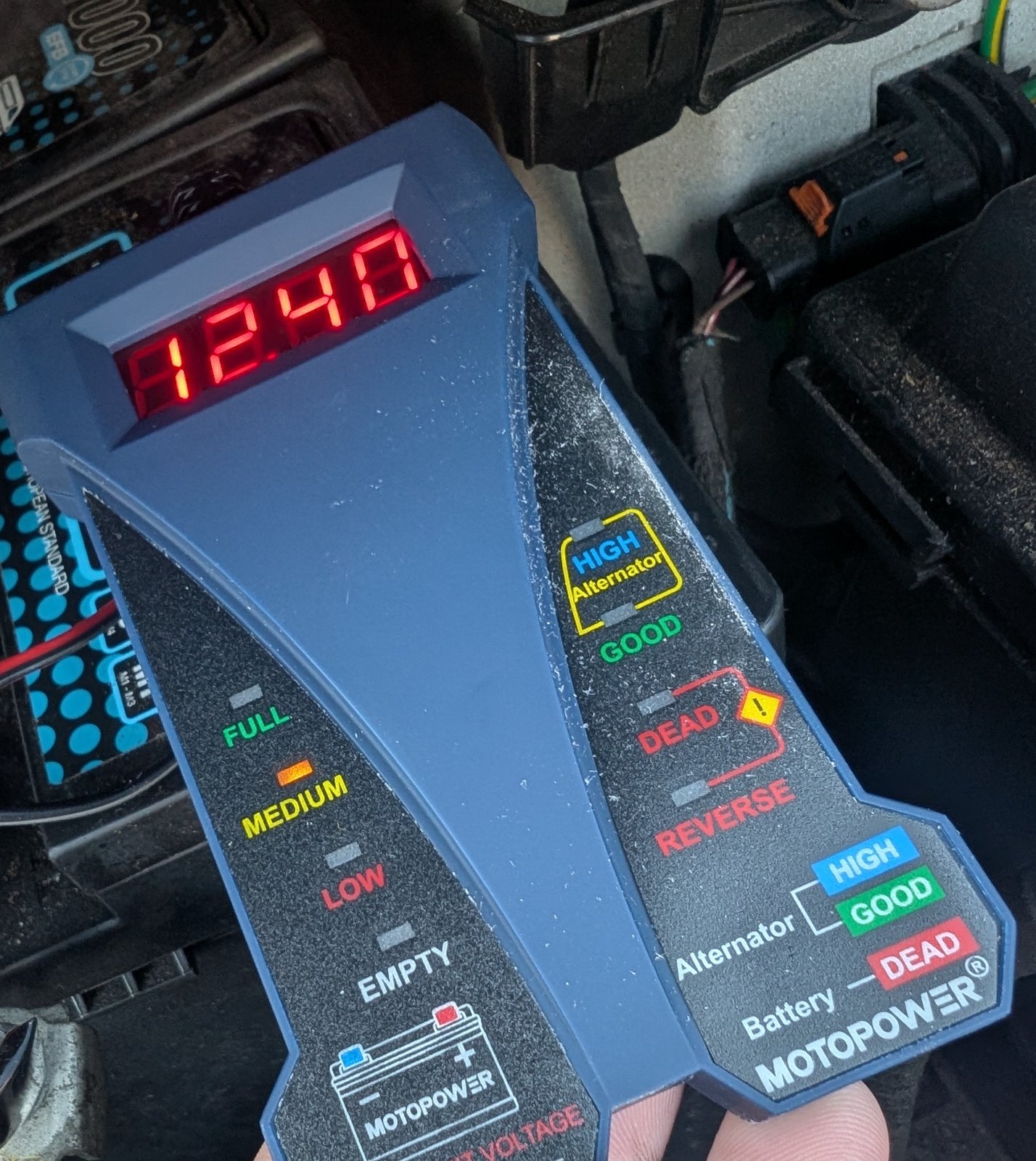

So I did a battery test this morning on my CGP 2017, the voltage was 12.40, but when running went to to 14.30.
Would this battery start to cause electronic issues to appear on the car.

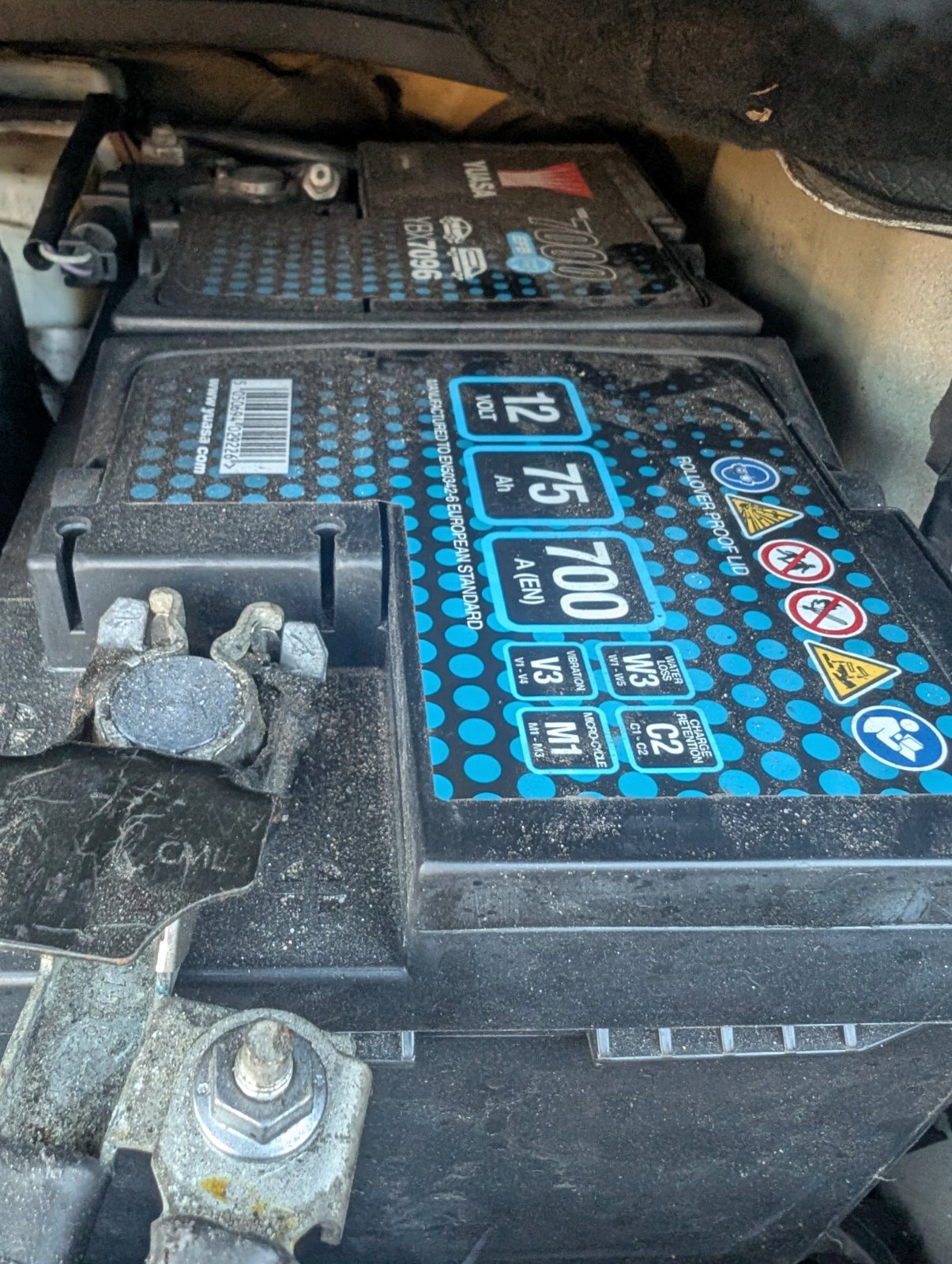

I don't know when the battery was installed, so think worth getting a new one?

Those voltage readings are normal.
You’d need different test equipment to check the battery condition - can’t determine that on voltage alone.
