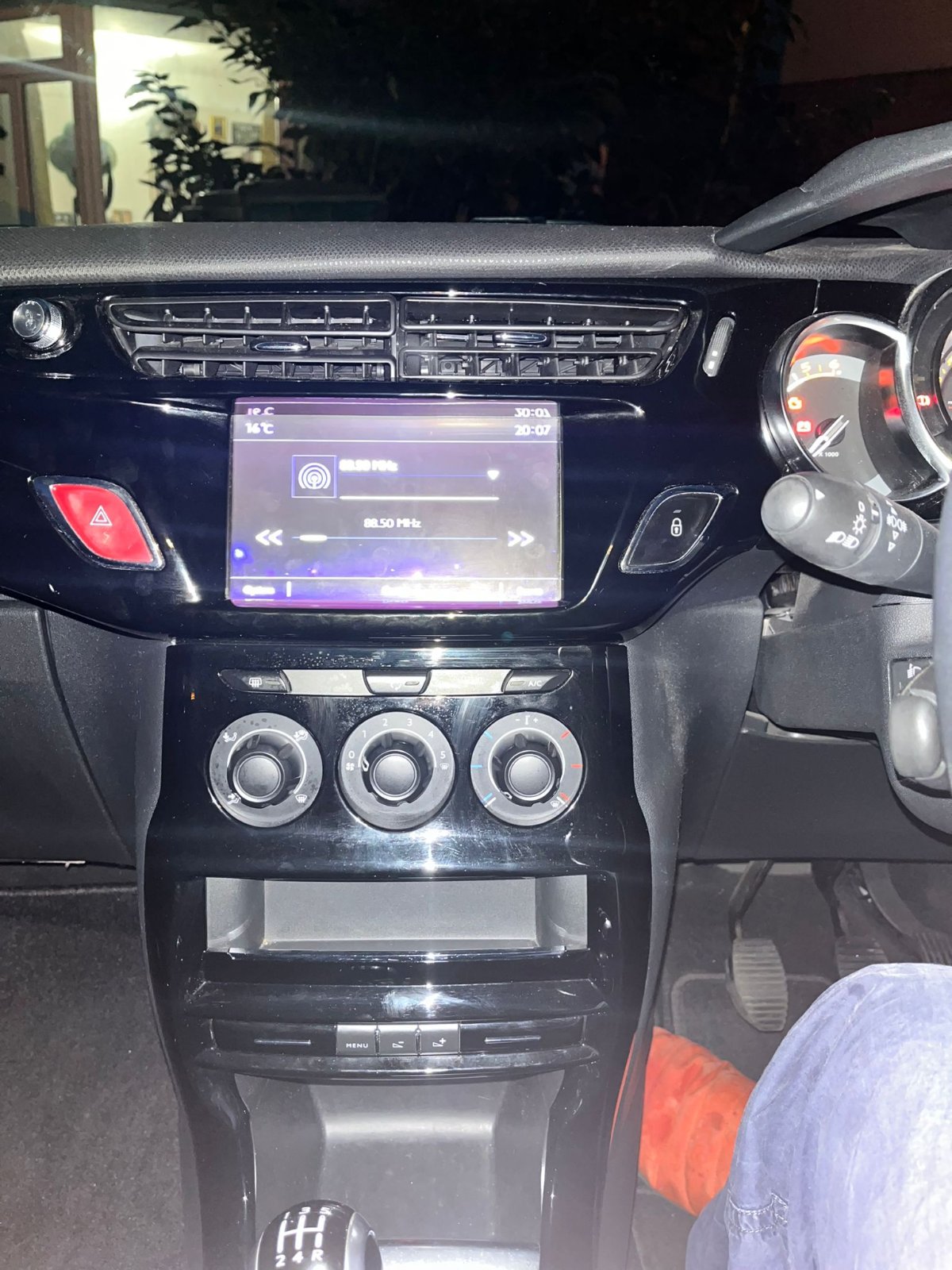

Do you know what type of radio is fitted? A photo of the front of the unit would help?

I don't know the type of radio, but please see the attached photo. There is no obvious 'on/off' buttonPaul-R wrote: 09 Sep 2025, 18:34 What are you pressing to switch the radio off?

If there isn't a dedicated 'Mute' button on the steering wheel controls try pressing the volume 'up' and 'down' buttons together.
I don't recognise the radio but my best guess, given that it's a touchscreen, is that it's a SMEG unit.

Looking in the handbook using the link above for a 2015 DS3 shows a normal radio in the space below the heating controls but in one for a 2018 shows one like your photo where everything is done via a touch screen and the radio unit must be hidden behind the console. Possibly your 2015 car had a later radio/screen installed by a previous owner. The menu button lower down between the 2 volume buttons might take you to somewhere that can change the auto switching on. Also the steering wheel volume switches if both + and - are pressed together it mutes the sound so something to try.

Judging from the picture that’s SMEG+ or SMEG+IV2 (possibly even NAC Wave1). Those can’t be switched off - only muted.
Switching off was introduced only later with NAC Wave3/4…
