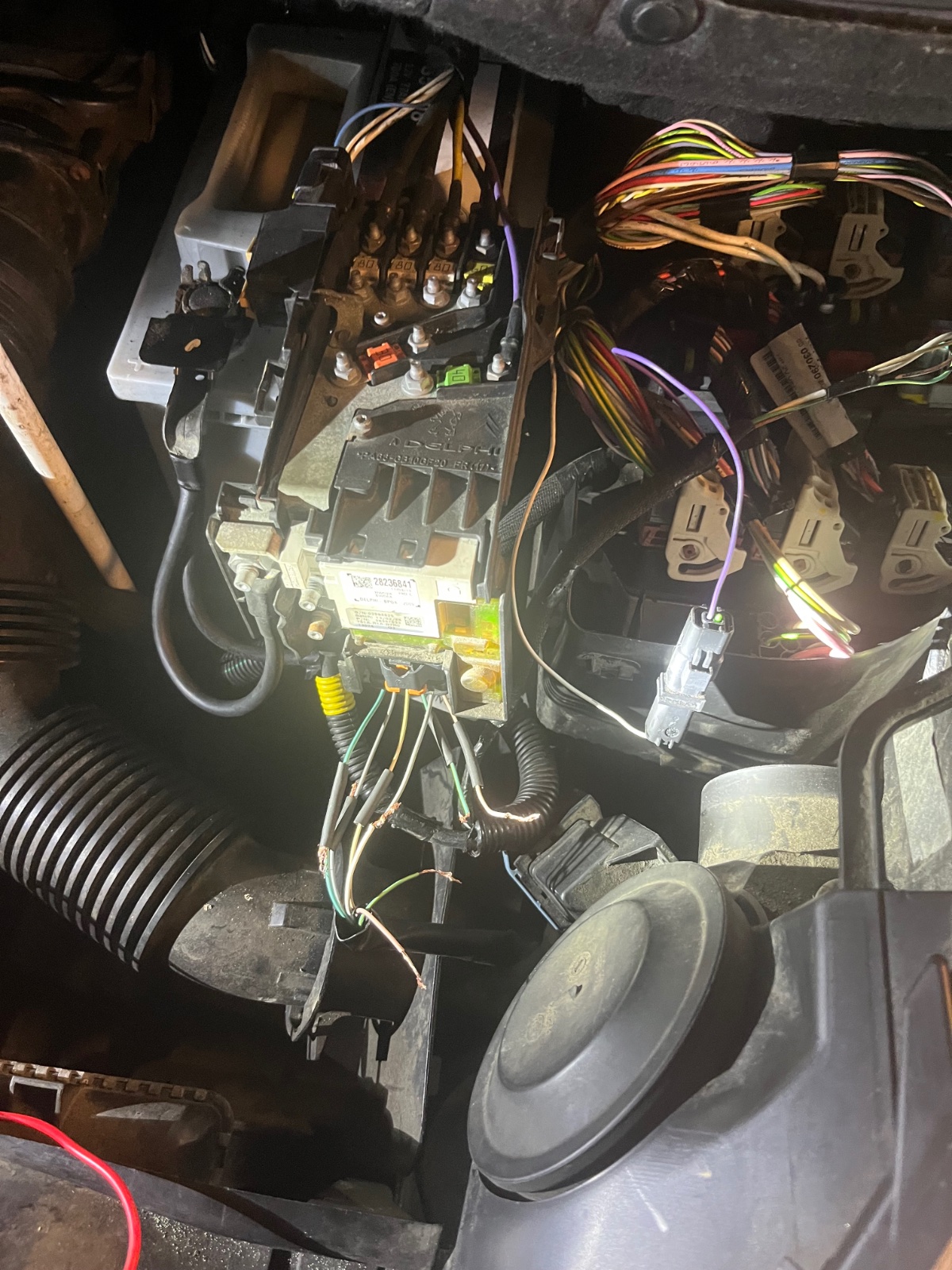

But I have one question, and it might be based on a wrong supposition: I have started up diagbox, and I have tried activating all the actuators, and everything is working, but it says I should feel the high pressure fuel pump vibrating when I activate it, but I can't feel it, but it is buried under a lot of stuff so that could just be me.
Since I heard that that pump gets fed from the fuse box on top of the battery, I thought I'd do some experiments, since I'm seriously considering scrapping the car.

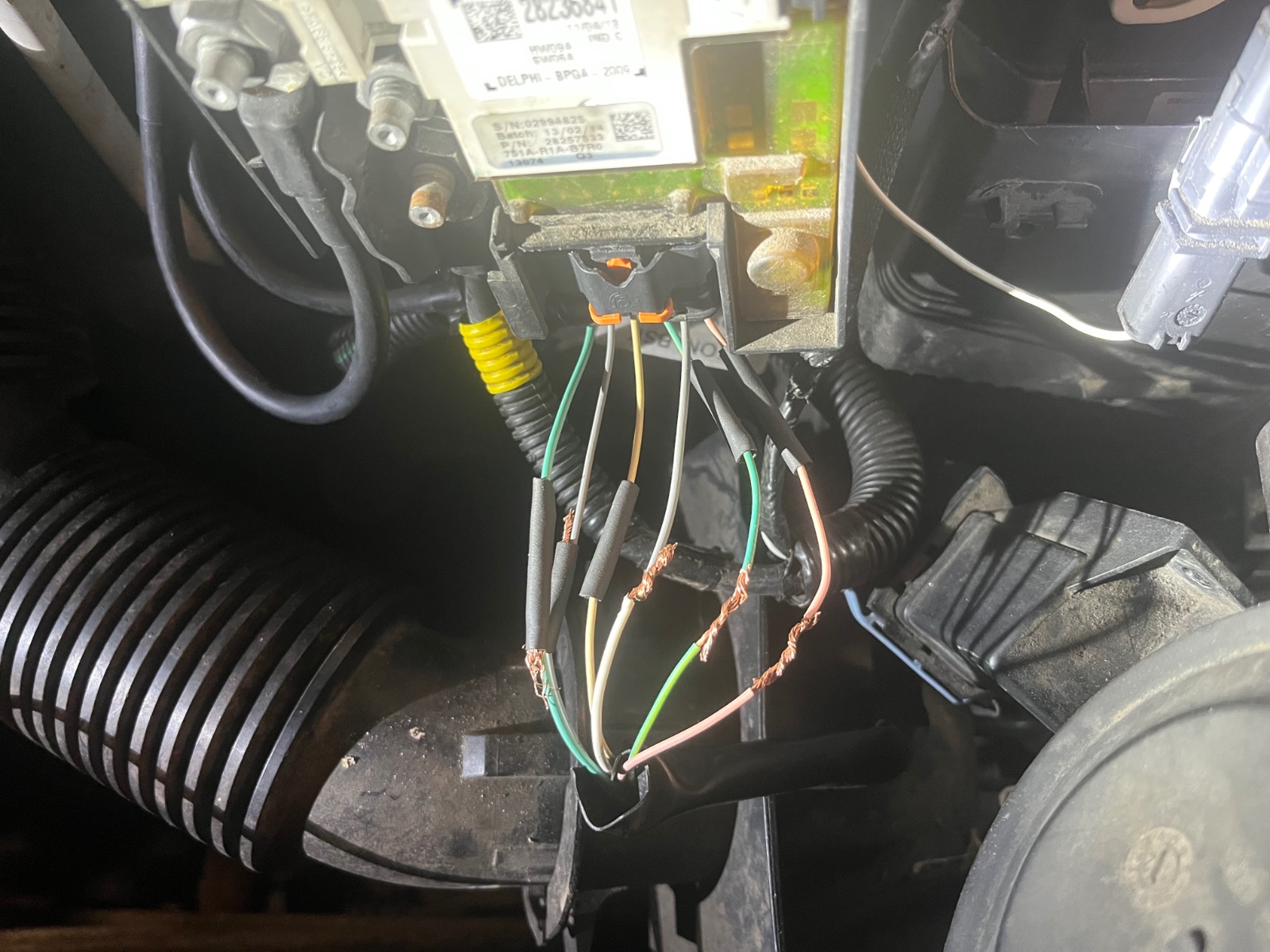

Here I have cut the wires and put some moveable tubes on. With the ignition on All wires except 4 and 6 fluctuate between 10-12V. 4 and 6 have no power.
Uncoupled 4 and 6 also fluctuate between 10 and 12V like the rest.
This leads me to suspect a short, and since I have heard that some of these wires go to the high pressure fuel pump, is it possible that my problem is not my timing belt but that pump?
I might have done something even more stupid afterwards, since I’m considering scrapping the car. I circumvented the relay/fusebox on the right of the battery and attached the plus on the battery to the slightly thicker white cable on the starter cable, and the engine continues to crank as long as I have the cable attached.

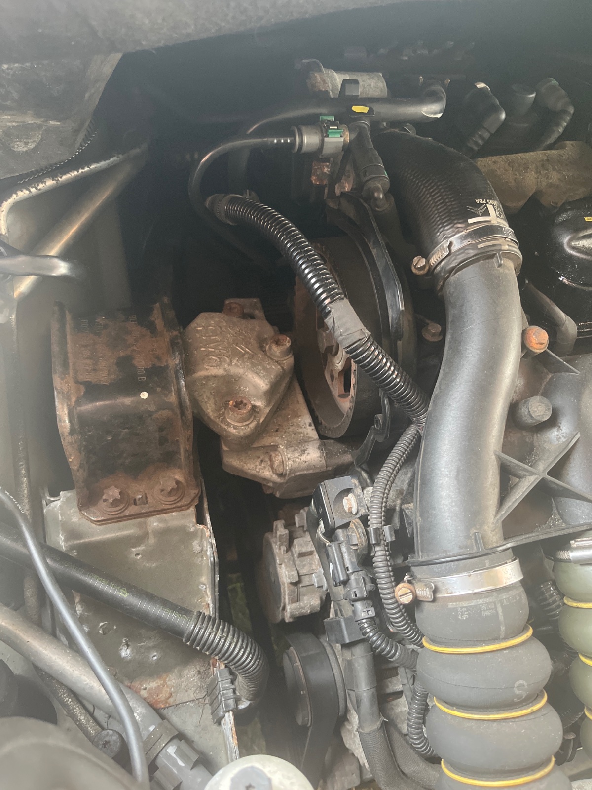

Before you crank it over again, I would take the top cambelt cover off and check the state of the belt.

You could look inside the oil filler point and if you can see a cam shaft, put the car in gear, handbrake off and give the car a push to turn the engine a bit. If the cam shaft turns the belt is probably not broken, it might have jumped a tooth though which this will not check.

I have done that, and I can't say that I see any damage on the belt.Steve Walsh wrote: 01 Sep 2025, 11:32 Before you crank it over again, I would take the top cambelt cover off and check the state of the belt.
There is a suspicious tiny shiny splinter lying on one of the gears though.

I will try that. Should the timing belt move together with the camshaft?PaulC5 wrote: 01 Sep 2025, 11:48 You could look inside the oil filler point and if you can see a cam shaft, put the car in gear, handbrake off and give the car a push to turn the engine a bit. If the cam shaft turns the belt is probably not broken, it might have jumped a tooth though which this will not check.

If you still have the cover off you can see the belt this way without looking in the oil filler neck but you can check all the belt for damage by turning the engine this way. As the belt moves it should turn the cam shaft.

The place my car is currently located is very flat, so I will have to wait ‘till I can have some help actuaæly moving the car, but I noticed that, while I was rocking the car back and forth, that the alternator belt was moving but the timing belt was not
- Posts: 9330
- x 1940
Re: No start Citroën C4 Grand Picasso HDI-110 2010-2013
That is not a good sign and points towards a snapped/stripped timing belt.

And I have final conformation: we managed to move the car a foot or two, and the timing belt just moves a tiny bit (like an eighth of an inch) back and forth in tiny “jumps”
