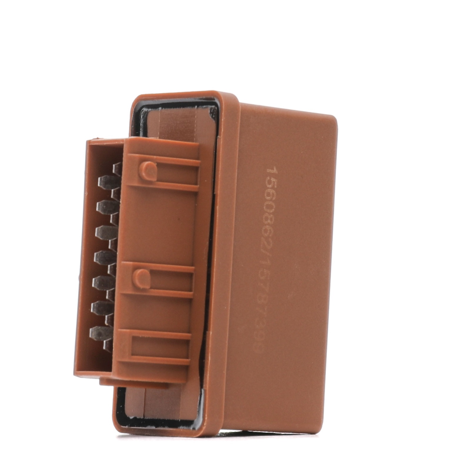

I've noticed that pin 10 on the double relay for the fuel pump is not being grounded from pin 3 on the ECU (Bosch MP3.2)

I think the problem lies else where, more than likely the fuel pump multi function relay, they often play up. You must get that poor wire sorted first though. When you order a relay make sure it’s the exact same part number, there are different ones. If you get the wrong one the slots on the plug will not line up. When you get the car going it would be best to get rid of that key pad.

If I bypass and apply my own ground I can get the fuel pump running. The car still won't start unless I apply the throttle. Then it will run but cut out as soon as I let go of the throttle.
I did get a new one of those relays. I couldn't get the exact part number but found one with exactly the same pinout. The slots do not line up for the plug but I've cut slots off the relay for the time being to be able to plug it in. If I can get the car running I'll modify the plug to accept the new relay as a more permanent solution

Don’t modify the relay plug, it’s important to get the exact replacement relay. Search the net with the number on the old one, you will find the correct one, I did.

I did try to look for a relay with the exact part number but I could not find any stock anywhere.Oldpug wrote: 26 Aug 2025, 17:47 Don’t modify the relay plug, it’s important to get the exact replacement relay. Search the net with the number on the old one, you will find the correct one, I did.
