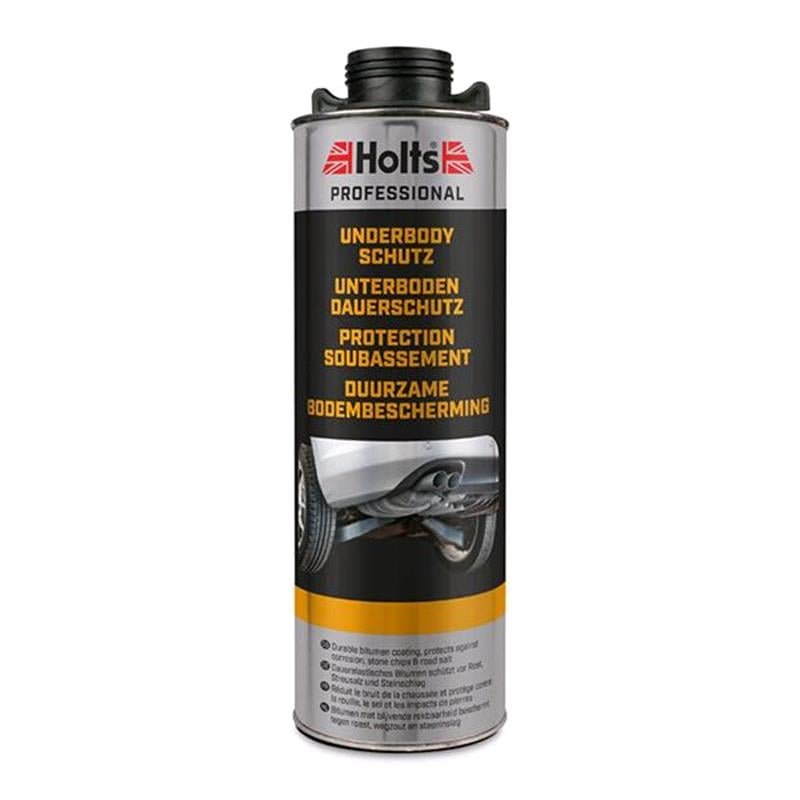

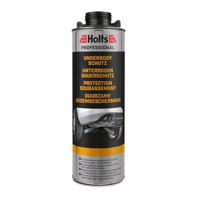

Cheers for the feed back, looks like stay away from waxoil, due to cracky finish, not happy with having to annually retreat the lanolin.
May now look into the old spray underseal(bitumin), as it sticks like you-know-what! But it's rather messy to apply - or it's just me!

Re: Lanolin, Waxoil, or..........
I wouldn't use an underseal or schutz type gloop unless the underside is completely free from rust or even a hint of rust as the underseal would just hide the rust problem whilst it grows. Even treating it with the usual rust treatments won't really cure the problem, merely slowing it for a year or so. I've heard very good things about painting it with POR15(?) which sets harder than a very hard thing and has its uses when it comes to dealing with rust.
That is all true.bobins wrote: 10 Aug 2025, 17:41 I wouldn't use an underseal or schutz type gloop unless the underside is completely free from rust or even a hint of rust as the underseal would just hide the rust problem whilst it grows. Even treating it with the usual rust treatments won't really cure the problem, merely slowing it for a year or so. I've heard very good things about painting it with POR15(?) which sets harder than a very hard thing and has its uses when it comes to dealing with rust.
POR15 is outrageously expensive though. If going for a paint, good ol' Hammerite is brilliant - been around so long that most people tend to forget about it these days! I use the smooth satin black and the spray can gives brilliant finish.
If going for spray on non-paint products, totally agree with Sticky - Dinitrol or Bilt Hamber products are the best (personally I use Dinitrol).
Way back in the day I did Waxoyl in all the cavities on one of my CXs and a Sunny and it dried and cracked after a few years - not happy.
