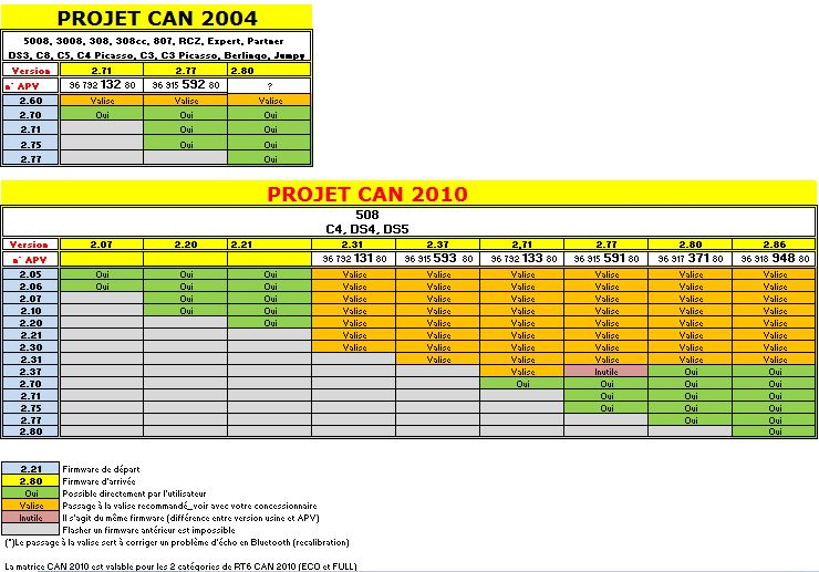

Are you sure it's 2.6? There's no 2.6 anything for the RT6 system.
