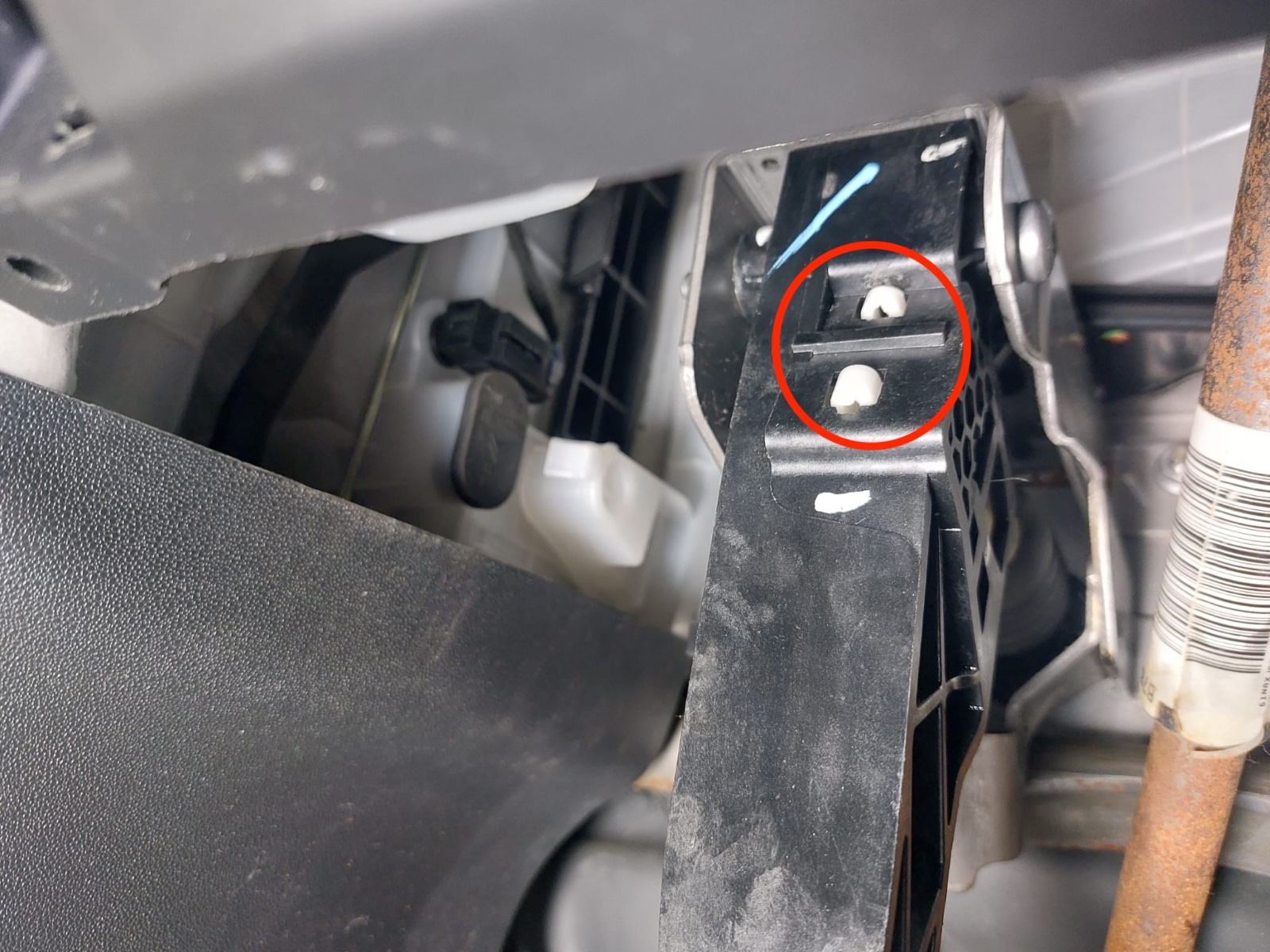

Did some investigation and the noise seems to be coming from the top of the clutch pedal. When the pedal is depressed the 2 small white plastic lugs move and clicking noise made.
Ive got a video clip which picks up the noise and movement really well, just not sure how to upload?
Anyway, something is moving and creating the noise but not sure what that part is, what it does, if it's a easy fix?

This recent thread might be relevant! https://www.frenchcarforum.co.uk/forum/ ... hp?t=86740 On the second page there is a note about the clip wearing out, I suspect this is what is happening to yours.

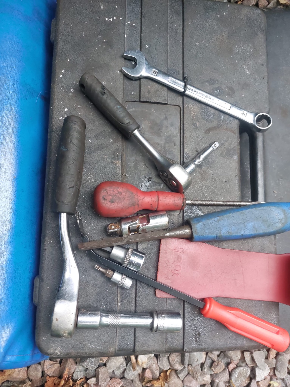

Tools for the job
T40 Torx
T15 Torx
13mm socket
13mm spanner
Trim removal tools
flat head screwdriver

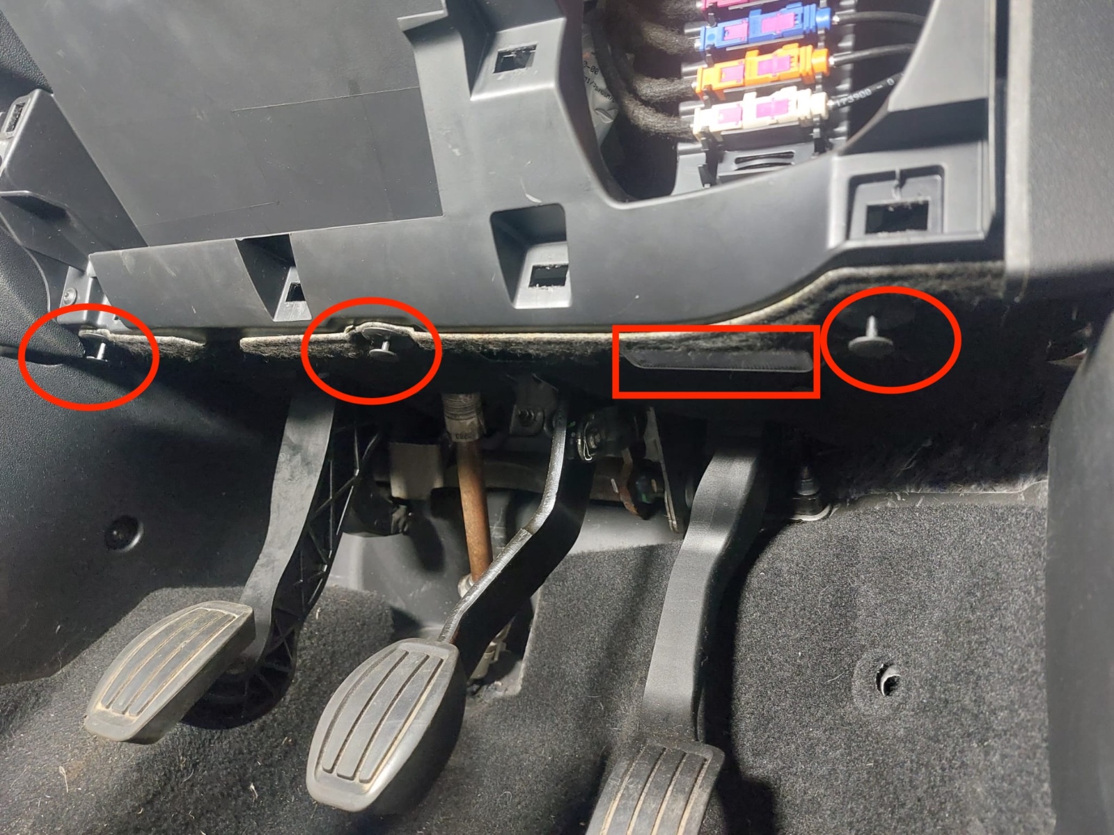

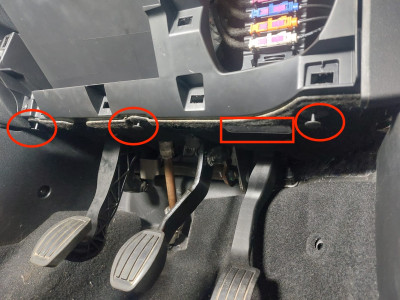

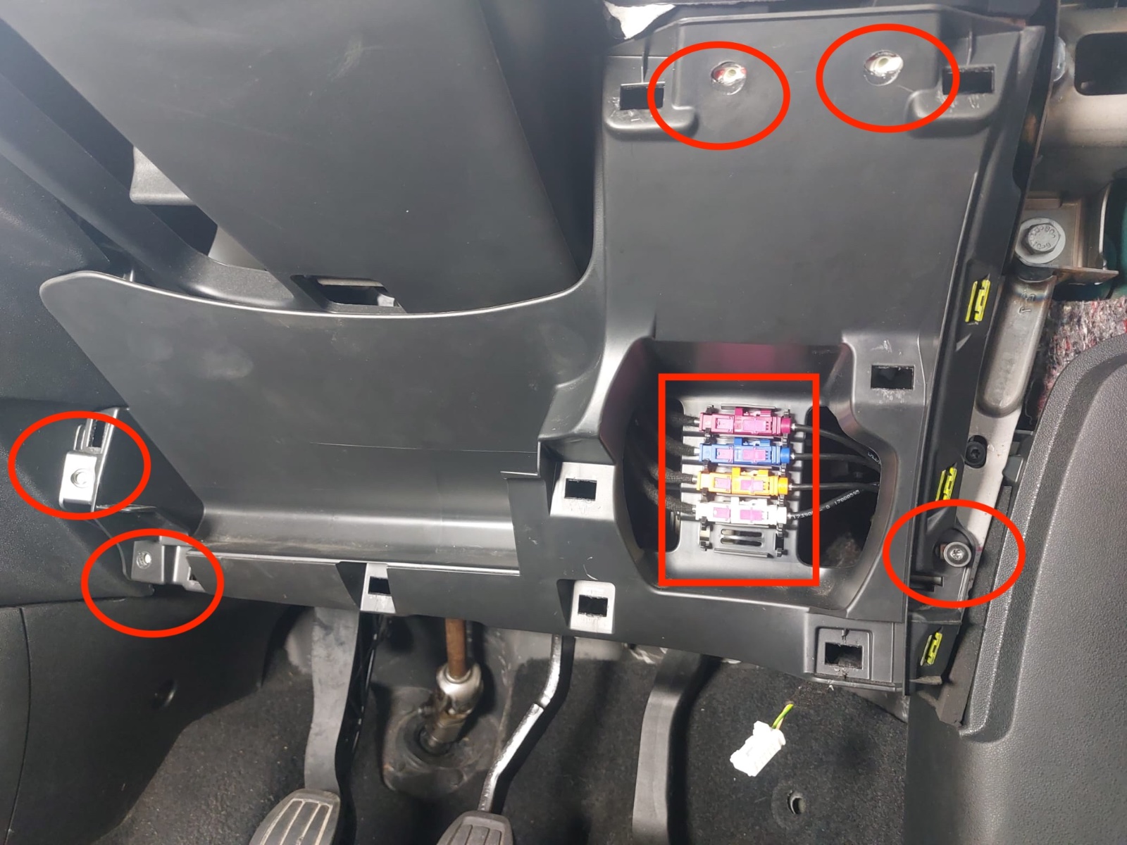

Remove the 2 bits of trim
Then remove 3 plastic clips, once the felt panel drops, disconnect the light

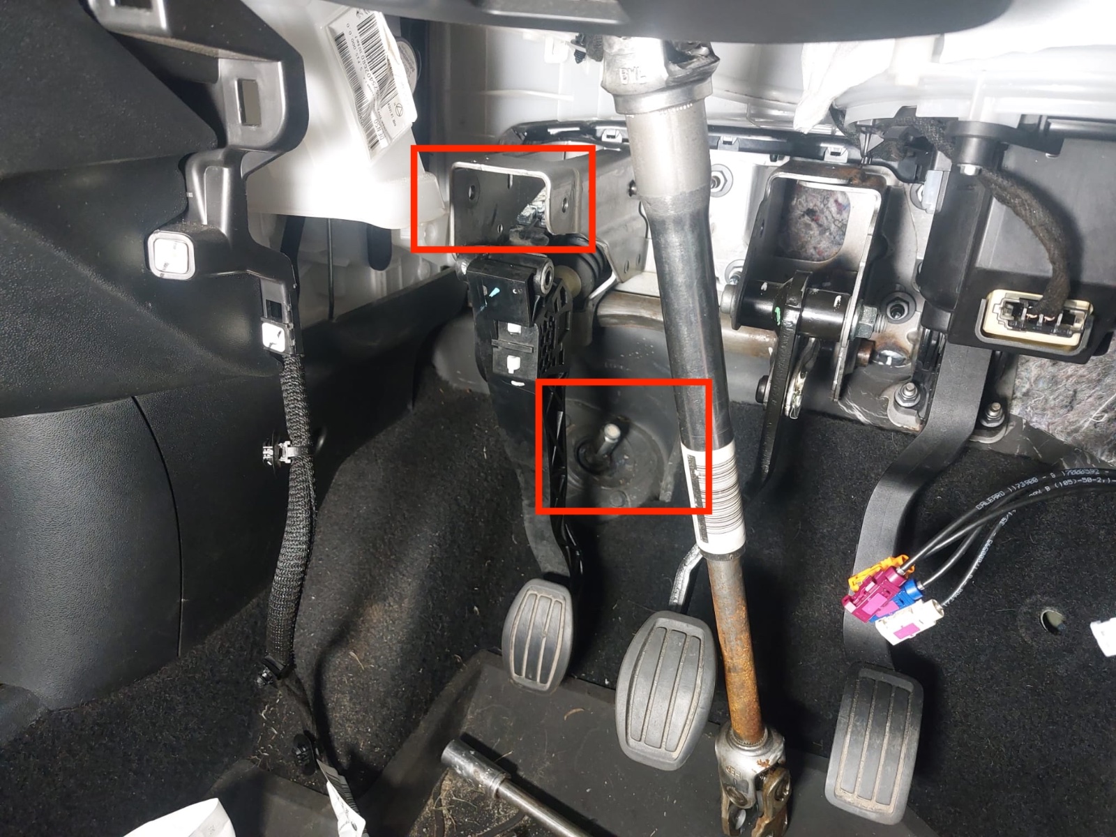

Unscrew 5 x T15 Torx, disconnect the 4 electrical connectors and remove the panel

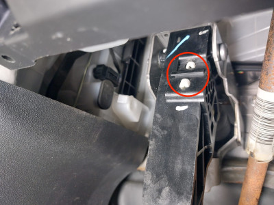

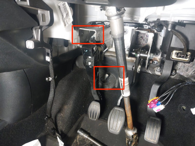

Use the 13mm socket to remove the nut from the bolt of the clamp on the bottom of the steering column. Swing the steering column out the way.
Use the T40 Torx and 13mm spanner, remove the bolt on the clutch pedal

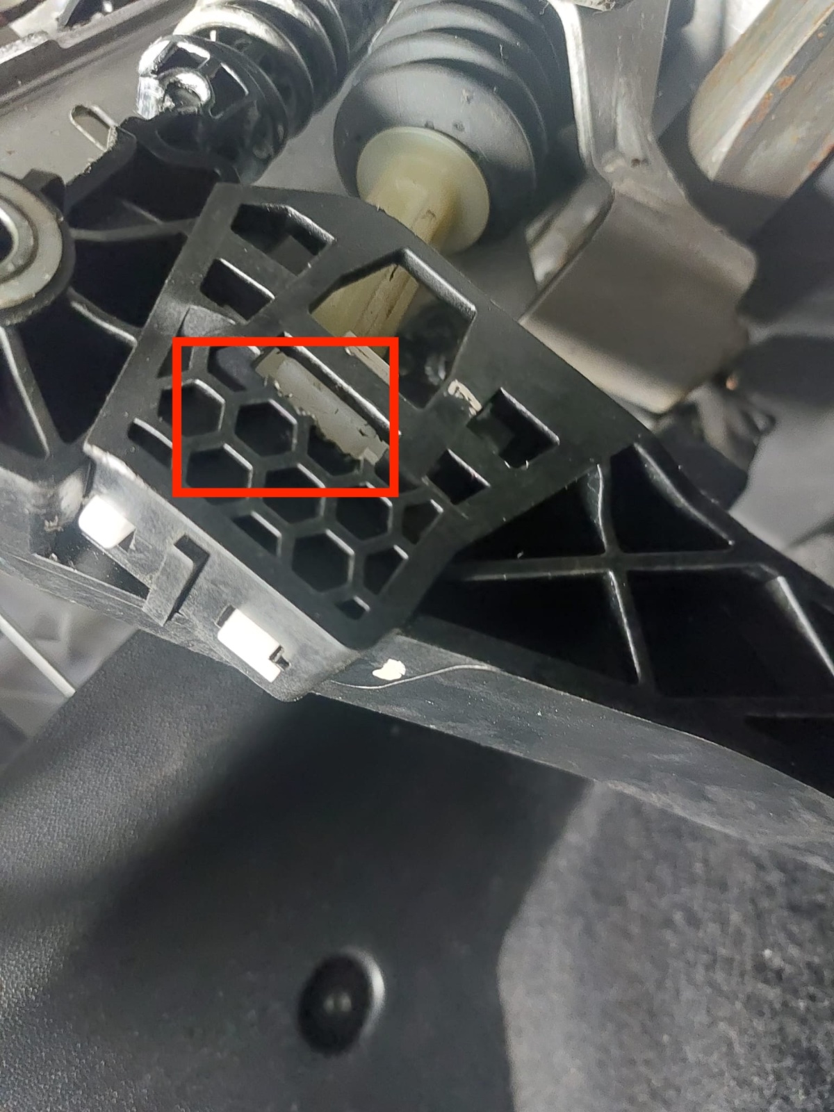

The clutch pedal will now drop and the clip will become accessible
Use the flat headed screwdriver (its not ideal but it'll do) to push the clip out of the clutch pedal - its quite difficult.
Replace with a new clip and fit everything back together in the reverse order

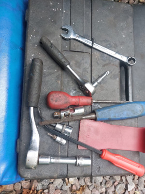

Tools for the job
T40 Torx
T15 Torx
13mm socket
13mm spanner
Trim removal tools

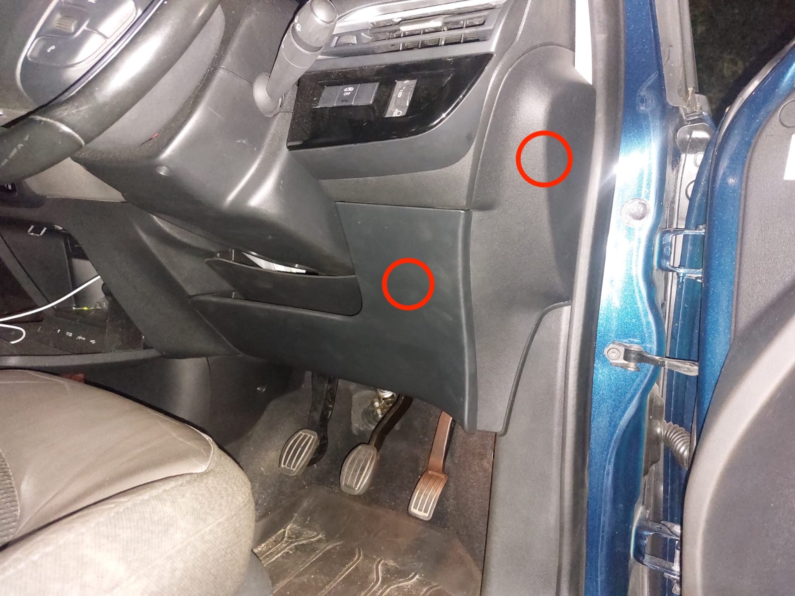

Does anyone know the part number for the clutch pedal clip shown in picture?

9820420180 - thats the part number for the clip for a 2019 C4 Grand Spacetourer 1.2Spiderwesson wrote: 28 Jul 2026, 21:16 Does anyone know the part number for the clutch pedal clip shown in picture?
