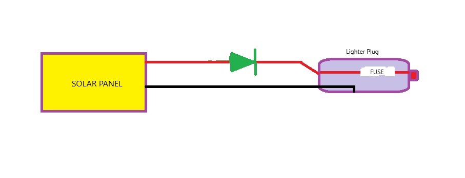

That's interesting Mick, was thinking of putting a small solar panel on the dash to trickle charge the battery.
Champion of Where's CitroJim
- Posts: 21036
- x 8079
Re: Cigarette lighter from on with ignition to always on
Do you mean connect the panel via the cigar lighter Ryan?
- Posts: 3283
- Joined: 11 May 2022, 19:54
- x 1065
Well I was thinking through the exhaust pipe but your idea could work
