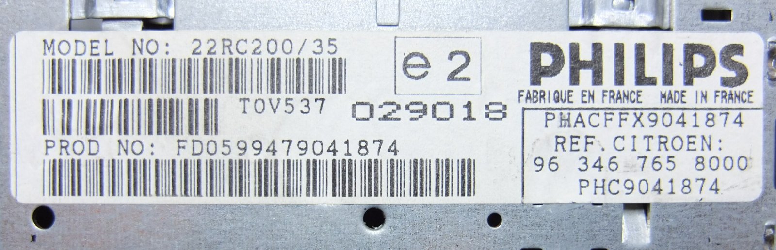

First things first, everything in this post relates to a late model S2 Xantia with a Philips 22RC200/35 radio cassette player; the one that has a flap to hide it that nobody ever uses.

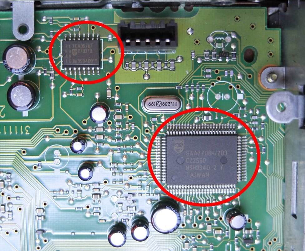

Underneath, we can see the two ICs we’re interested in. The largest is a Philips SAA 7708, which is really the brains of the beast; this is the bit that selects the audio source and processes it for delivery to the power amplifier stage.
The other is the TEA 0676, which is a dedicated signal processor for cassette tape mechanisms. This takes the signal from the tape head, applies Dolby processing etc and passes the audio to the SAA 7708. The idea is therefore to isolate the TEA 0676 and intercept the connections to the main signal processor.
