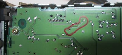

The outputs from the TEA 0676 are on pins 1 and 16, so we need to cut the tracks connected to those pins.
Pin 16 is connected to the lower face of the pcb, so the bottom cover has to come off
I used a Dremel with a micro burr, but you could use a knife.
This next picture shows where I picked up the connections for left and right channels, and also where I cut the track from pin 1.
