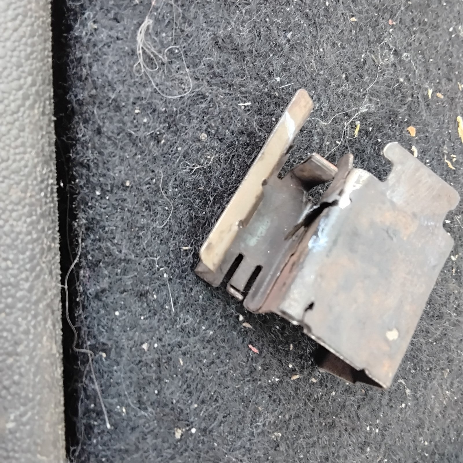

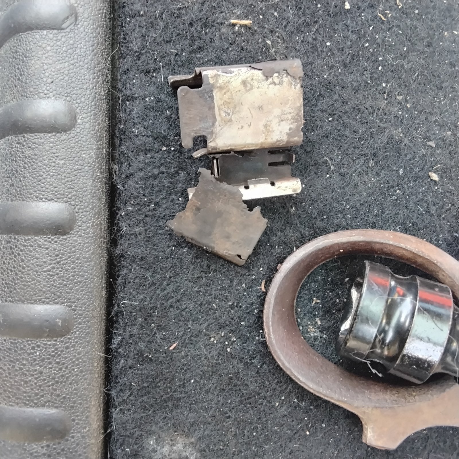

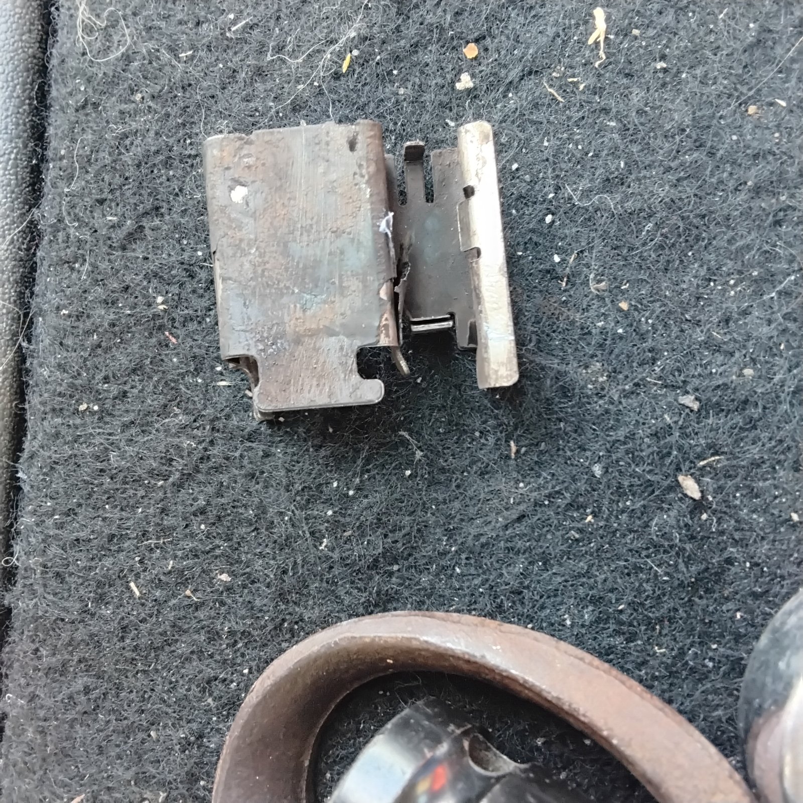

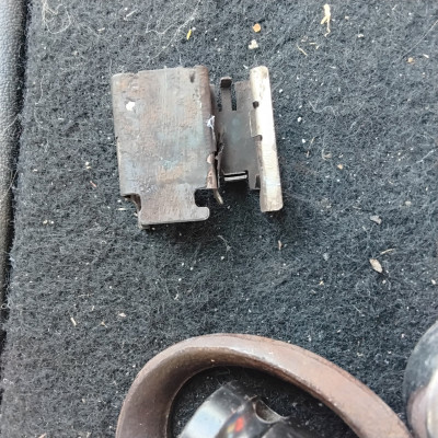

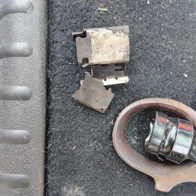

Brake pad clips .
When i serviced the 308cc brakes several months back the front discs and pads came with the clips the pads sit in in the set which was great as the ones on it were a little worse for wear, they only clip in so no big deal, the caliper bolts 13mm were ok to undo so that gave me the reassurance the previous owner did look after the car. How ever the clips when removed did sort of fall to bits . Lucky a new set was added to the disc and pad sets.
How ever these new ones were coated in a black Ruberised plastic which did give me cause for concern as to leave or try get it off , however they were fitted with it still on . A few weeks ago I was hearing pad score noise so I cleaned three corners leaving my driver side as I ran out of time not being to bothered by having one left to do because I was using the 207. So after yesterday's full cambelt kit changed ( and bottom crankshaft pulley) I then decided to clean the brakes on my side front, the inner pad was stuck the black rubbish coating on the clips had melted too. Wire wheel on cordless drill and a nice clean looking caliper was the end result, even managed to get the rest of that black stuff of the clips , refitting the pads to reveals the inner pad lips were slighly thicker so off to the vice and some file work to slim this edge down a tad, once that was done grease was used were needed and the pad slid in easy.
The photos with this post show the black stuff I'm talking about .
I'd suggested if you ever get these clips and they are coated with it , remove it it might be fiddly or it might not but I'd definitely get rid of it. Yet another stupid idea on a small car part that plays a very important roll in your cars braking system and performance.

That's very odd, the variants of those clips I've come across have all been thin stainless steel. Also strange I've not come across the pads coming with a new set (only the bolts - and they are sporadic if included or not (I have bought them separately in the past after having to reuse them before too))
If came coated I'd probably leave it be, might be intended as a "dry lube" of some form to help the pads to move.
The stainless ones I've encountered have been given a little (wire brush then) coating of white ceramic brake grease
