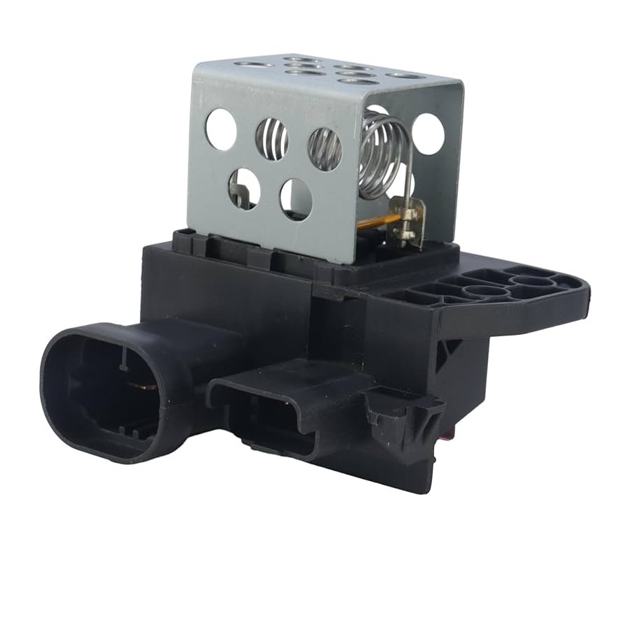

In my car recently, i had a fault about low speed fan failure.You can check and energize it through diagbox if you have to see if is working.There is a resistor with plug like in photo on top of the fan and very easy to access .In my case one of the pins was detached from the board and i had to solder it.
