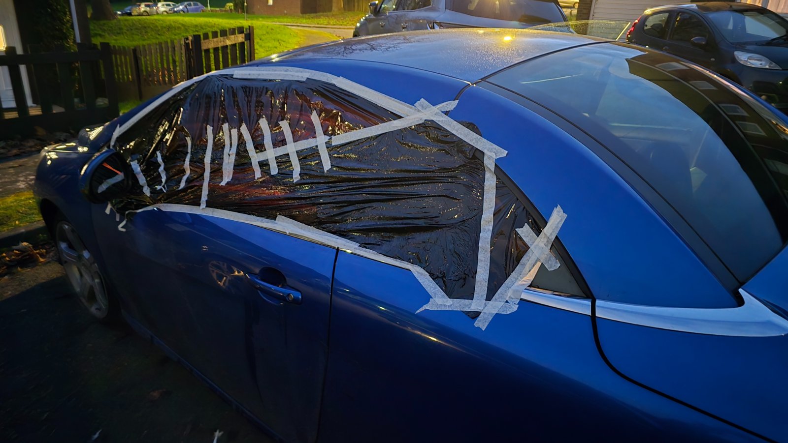

Got a weird problem with my Peugeot 308cc. My missus got back home from work, she opened passenger door to grab a purse, shut and... widows didn't close. There is a gap. I was trying to relearn windows. and the outcome is windows is staying down. When I press up is going for a inch up. When I press down is going for an inch down. Sensor in the handle is working, when the alarm is deactivated touching the handle triggering windows movement. I connected diagbox, did a windows actuator test. All 3 windows is going down an inch then got back up. Passenger one is down till bottom and then going up for an inch))). Moreover roof is going up or down without any problems. I started whole system fault finder and get this - F9D0, F9D1 (Driver's and passenger's mirror mechanism. sensor input fault - Short circuit to earth or short circuit to positive).Haven't got this fault previously, and both mirrors folding, can adjust both up, down, left and right. Heating is working as well. Haven't got indexing while reverse option at all. My RPO is 11700. I secured the window and will get to the bottom later. In the meanwhile any thoughts?

Ok. Here we go. I dismantle a door card, disconnect handle from plug. Still window don't want to move up. Checked all the connectors, wires (visible). Did check wires from driver switch to the passenger door motor for faults. Power going in, but window is moving a bit in both directions, but won't go all the way up. Next idea - window regulators. Cable looks ok, window is moving up a bit or down a bit but still nothing. Next think thing was to help window to going up. Gently pushed glass up, and started to pull window switch.. TADA.. bit by bit, click by click window went up all the way. I have tried to open the door, (handle was unclipped from connector) window went down a bit. After shutting went up again as it should. I did reconnect handle sensor, the same. Window got back as it should. next thing window went down.... and the same wont go up again. Bit force, click by click and went up again. Haven't got time to dismantle the motor (check for brushes) or dismantle window regulator - to dark and to cold))))), but I am suspecting brushes because window is going up and down without any resistance. Main thing is that window is working to allow open the door and shut them. Will inform you guys later after the job is done.

It might, to check everything window must be out anyway. But I don't think that guide is damaged. I did spray guides with lubricant and check them. Its the same: down no problem; up it's like motor just cutting off. And in the window down position motor is moving glass an inch up or down, same like you opening the door without problem every time. Have to look at wiring diag's, don't know if this motor got thermal cut off, or just bsi measuring to much current going thru and cut it off. Will sort it out.. eventually..) before spring for sure)))
