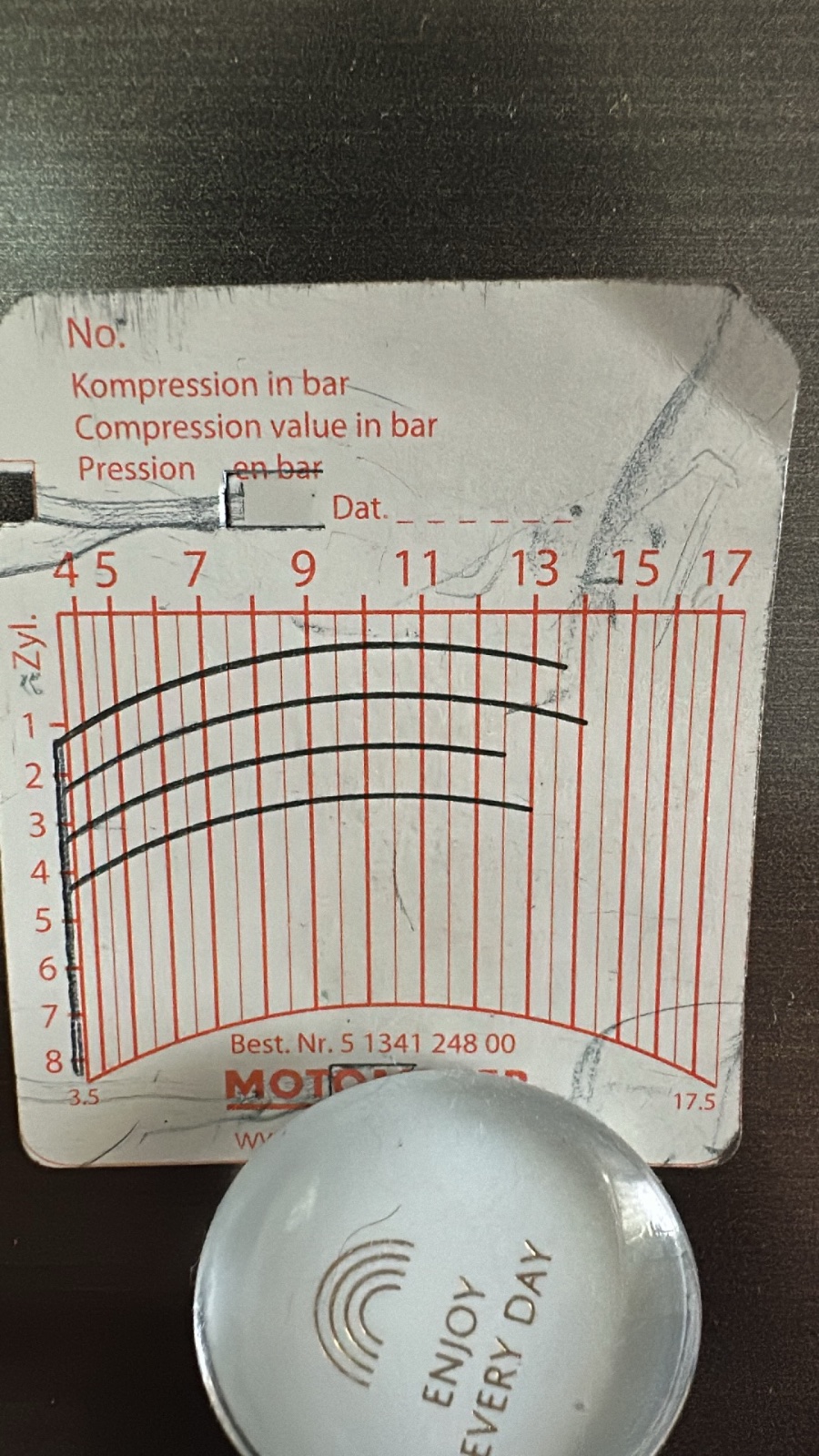

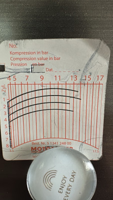

PS. Picture is actual compression ratio.
:D
:D
