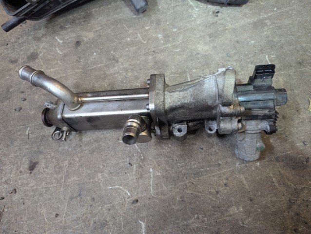

"Shot from the hip" and guessed tired EGR, it has been on there for at least 20k miles (car has 45)
Ordered a new EGR from a local auto parts company, 3500kr until the next day is still OK when the mechanic took 5000

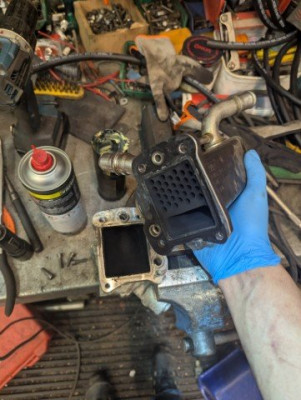

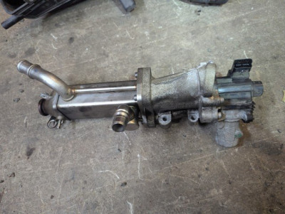

Today I replaced the EGR which went pretty well except for a nasty exhaust leak from the pipe between the manifold and the EGR cooler.
Now it put another error code :evil: P0406 Electric EGR valve position copy signal : voltage too high
But I deleted it and the car ran fine without a check engine light for the twenty minute drive home..
Put it away because of the exhaust leak and took Xantian instead
So the replacement then? There is no description on the Service box.

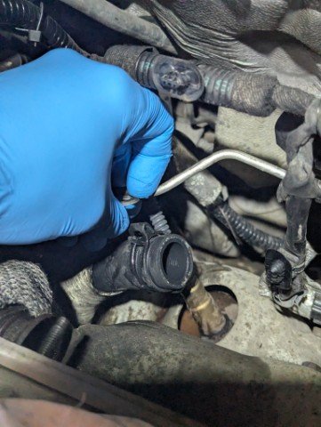

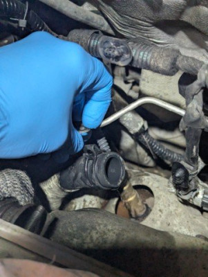

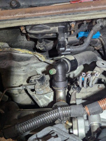

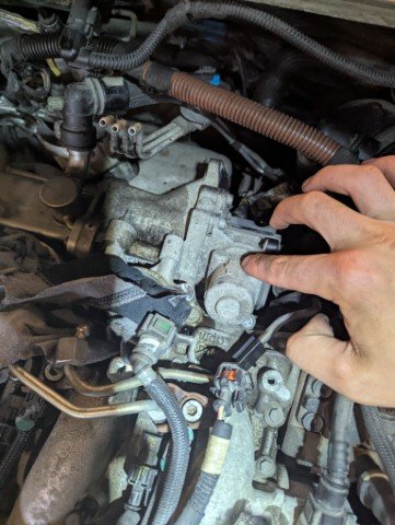

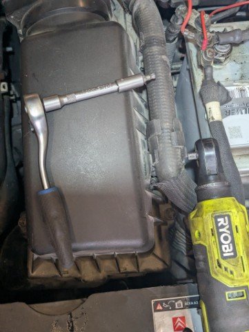

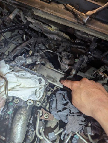

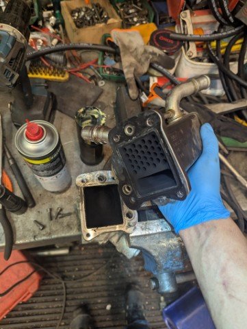

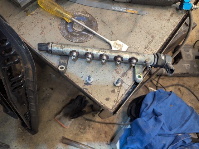

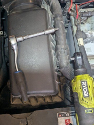

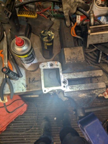

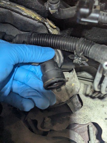

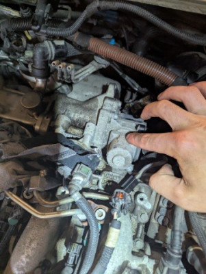

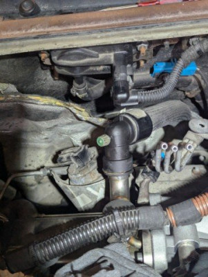

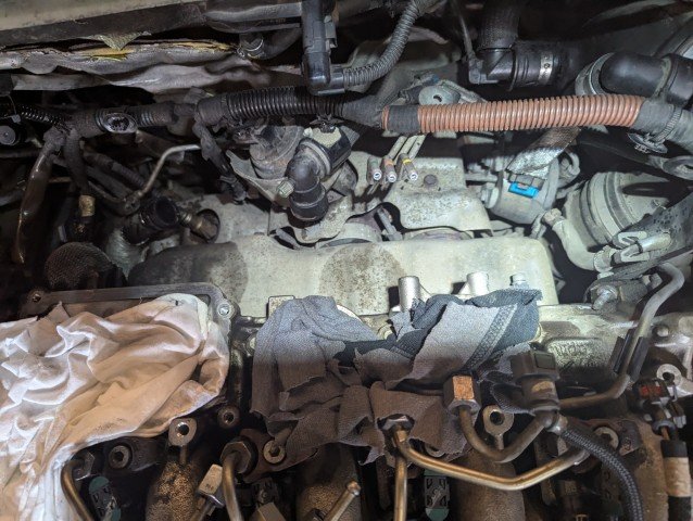

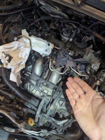

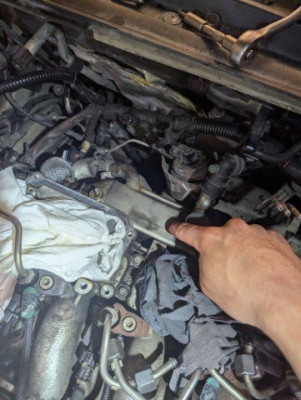

You need to remove the Commonrail, loosen the injector pipes, the vacuum pipes (three next to the EGR pipe and one at the timing belt cover) and the hoses for the crankcase ventilation. To remove the "valve cover" with the crankcase ventilation built in, after this you have quite good access to the EGR package with cooler and valve. Then you can remove the EGR pipe. On mine, the package was with two nuts and a screw and the clamp against the manifold, I had to unscrew the stud bolt that was on top of the valve. It has a torx socket but it worked with a 4mm socket. The lower screw on the valve only needs to be loosened a little as the mounting hole is U-shaped. Then it is quite clear how it is connected.

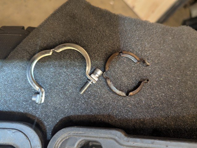

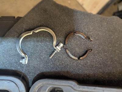

The hard part is getting the new clamp to the EGR cooler in place, the old one could not be used but the snap-on attachment did not hold tightly.
It took about 1 hour to get the new one screwed in and it still didn't hold tight, but I think it might be the pipe between the EGR cooler and the manifold that cracked.
Tools needed:
A good tool kit
A 1/4" bit socket
5mm hex bit with ball
Inspection mirror
A good headlamp is a good idea
WD40 or similar
Silicone spray
A good polygrip
