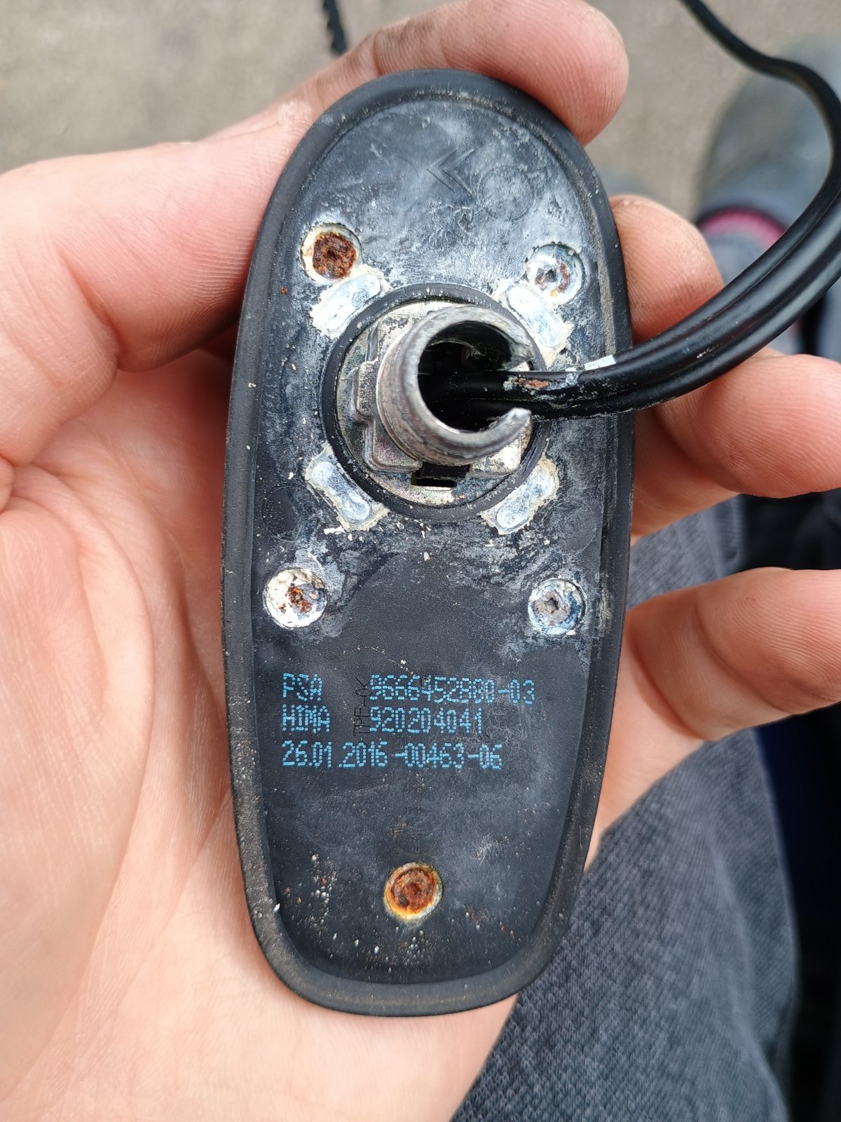

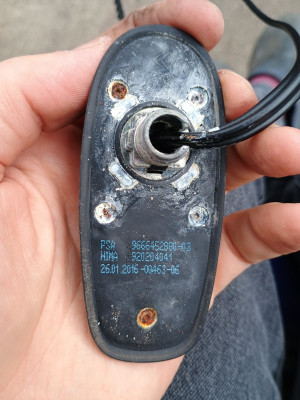

Aerial looks horrible underneath: Part number
9666452880-03
Only brings up second hand items in eBay. Tiny little Torx screws but might take bottom off see if looks as though has seen damp internally

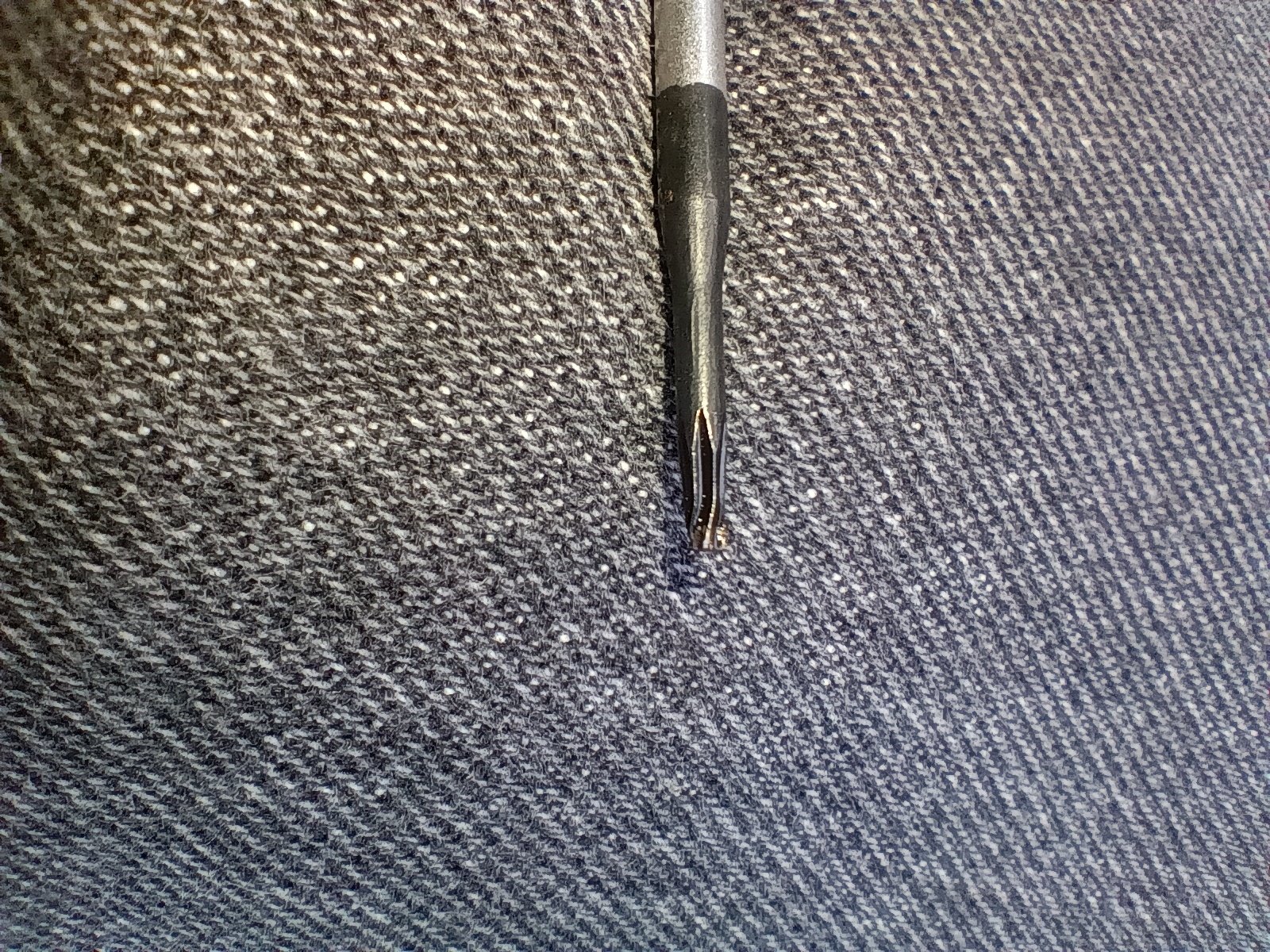

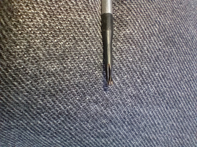

The two rusty and three crusty heads are T7 Torx - smallest I've got a tool for.
Actually maybe smallest I had tool for... Oh. Not coming out then

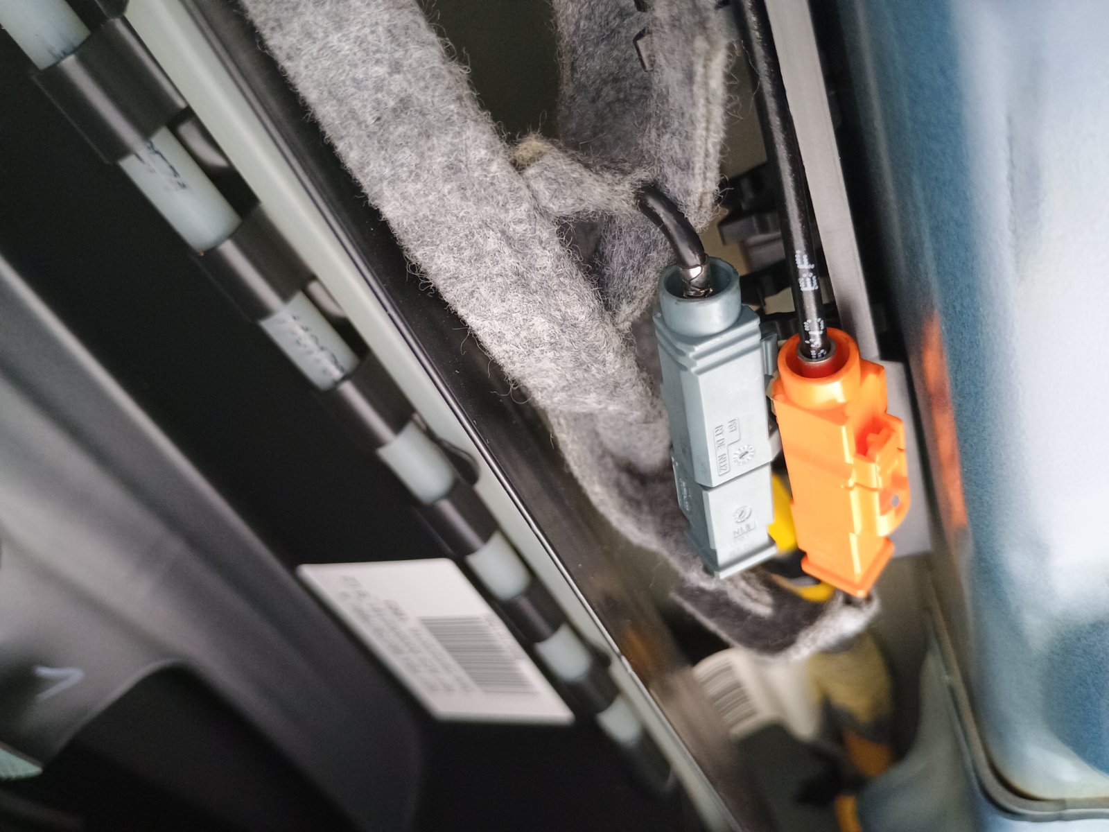

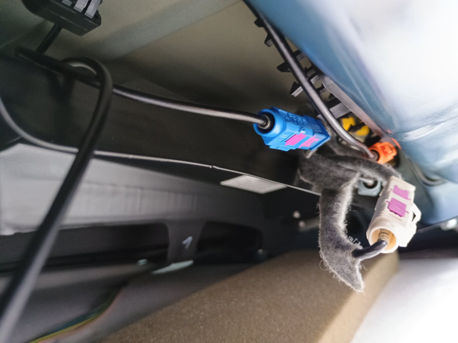

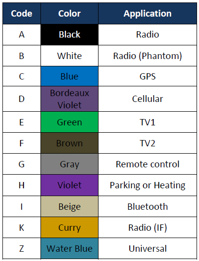

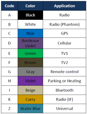

Interesting to read what the FAKRA connector colours mean:
Taken from https://amphenolrf.wordpress.com/2015/0 ... explained/
- Posts: 5361
- Joined: 25 Apr 2022, 09:03
- x 2366
Curry, white, blue and "gray" connections.

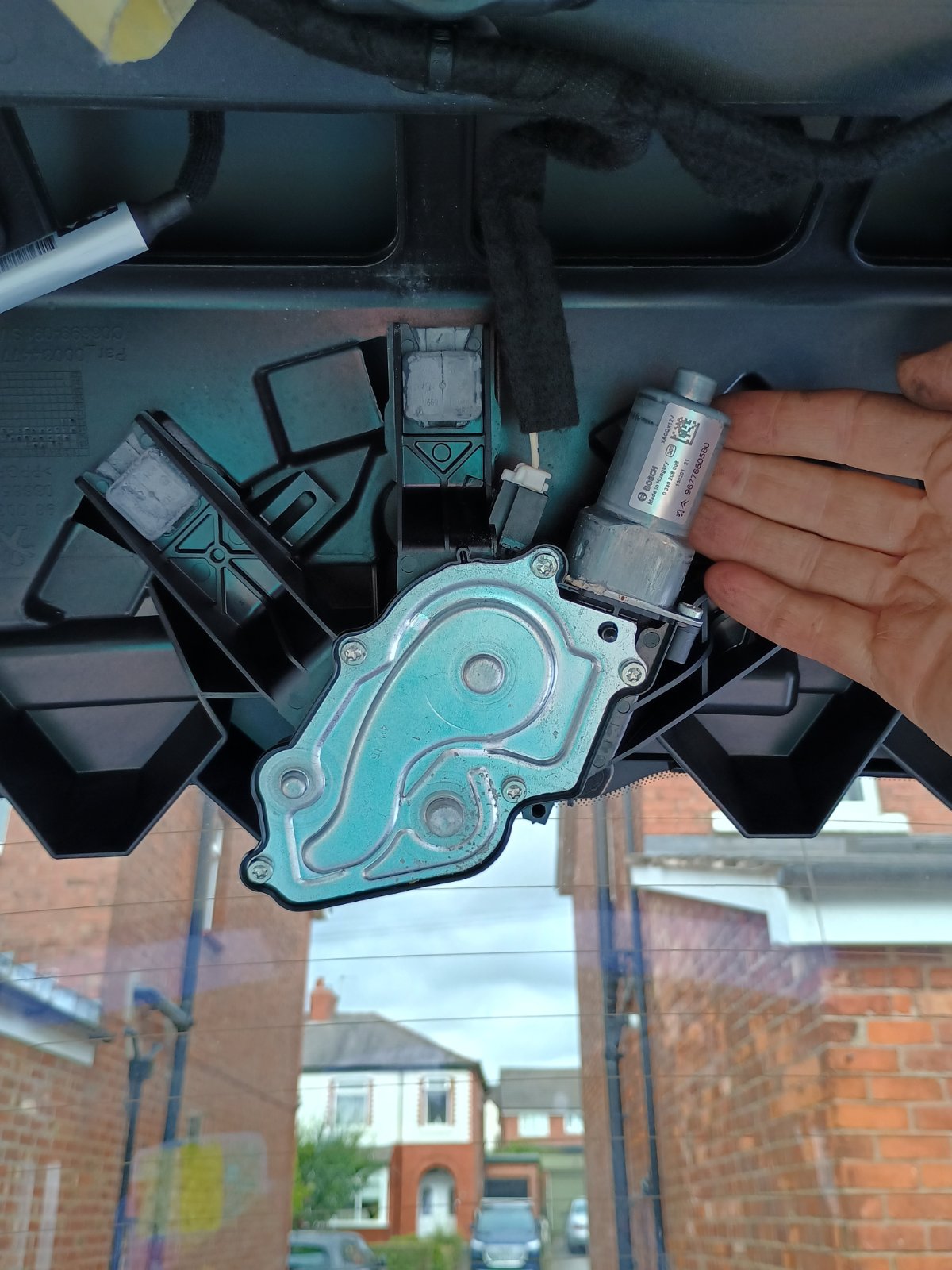

Oh, and (looking why left rear boot mounted lamp cluster is wobbly) I present the smallest wiper motor I've EVER seen! Ah, nowt but a baby!
