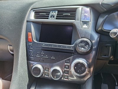

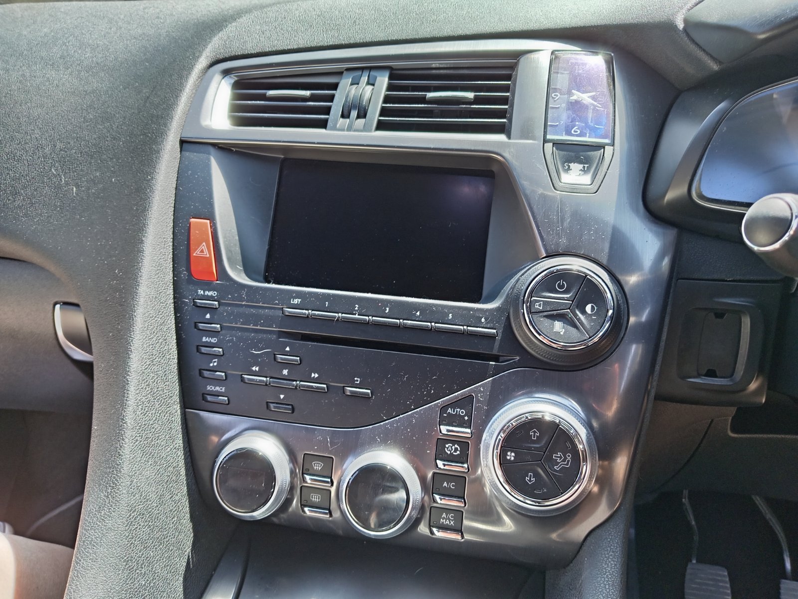

- Posts: 9313
- x 1938
Re: DS5 update Sat Nav
The photo doesn't show the unit switched on or anything on the screen to help identification but I'm pretty sure that's an eMyway/RT6 unit. Any chance of some photos of the various screens when switched?

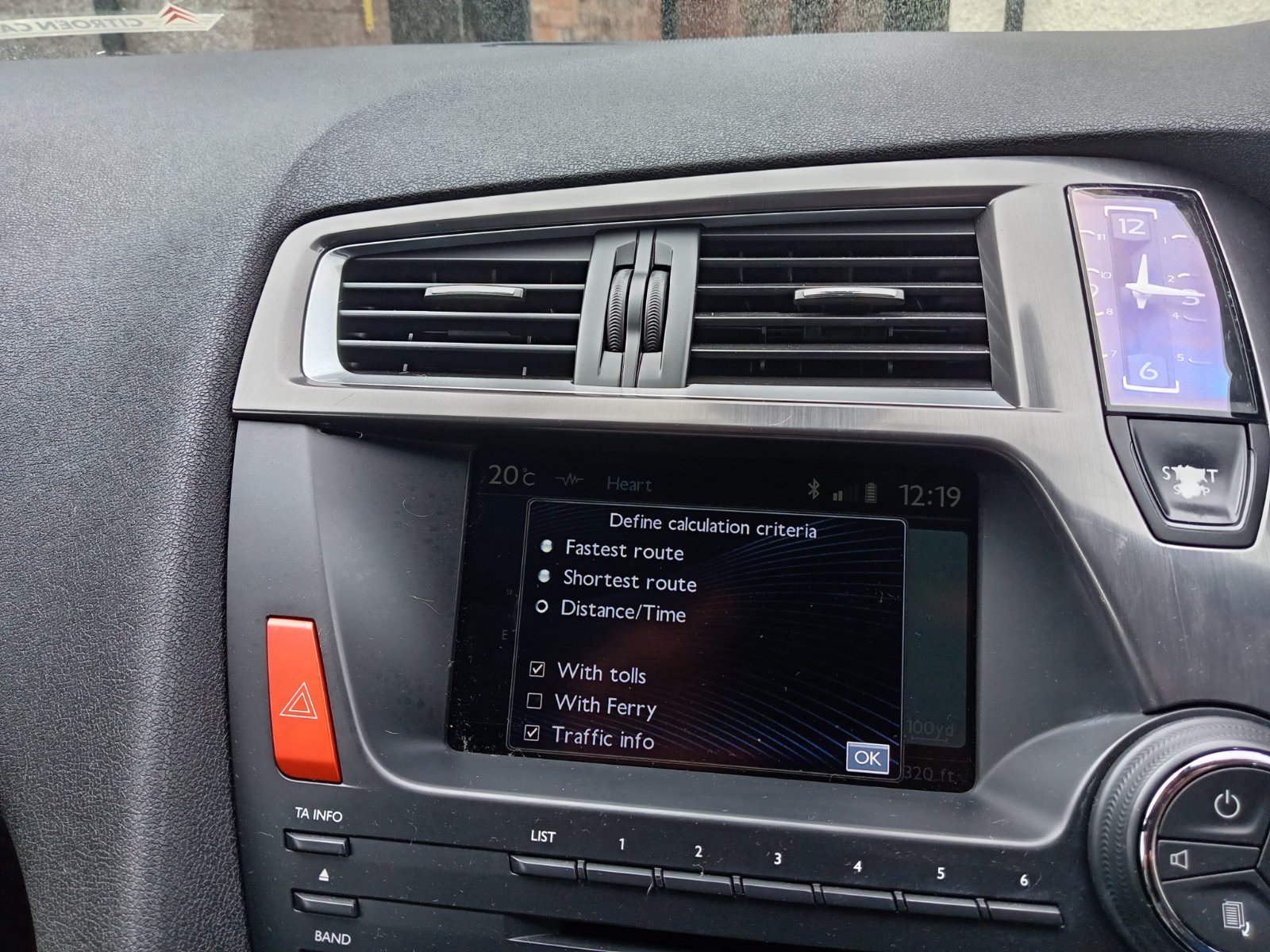

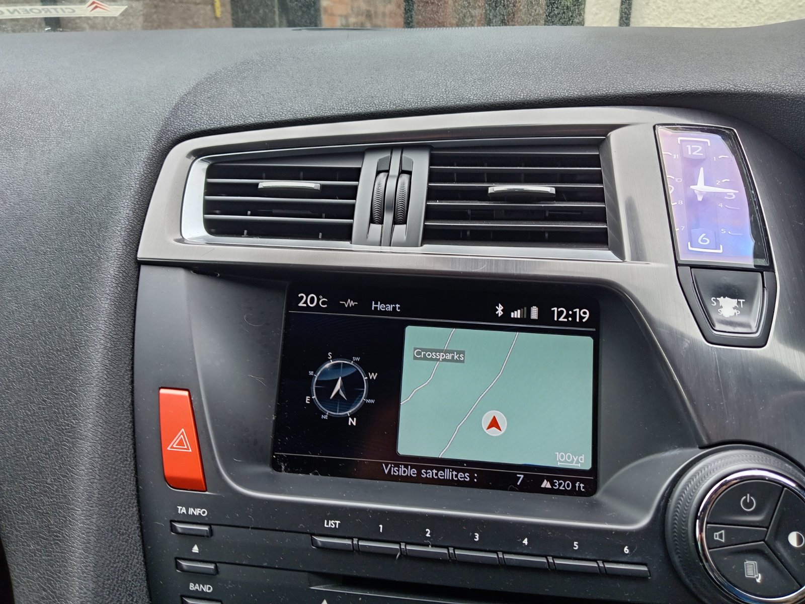

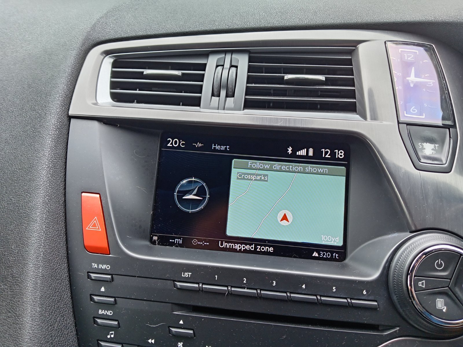

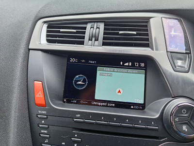

Here are some pics of the system turned on

- Posts: 9313
- x 1938
Yes, it's an RT6. I'm out at the moment but when I get home I'll send you a PM about updates.

- Posts: 9313
- x 1938
PM sent regarding maps.
The link that Mick posted is the official update. I note that it says "The minimum software version required to use this product is 2.86". The instructions to check your software version say to give a long press to the "setup" button and the help menu will show up. Then select "device description" and then "software." This is how it's done on my C5 X7 but I don't see a "setup" button in your screenshot. If it's definitely there try a long press on some of the other buttons such as the thing that looks like two pages of writing that's one of the segments in the large round button. Then work your way round some other buttons!
